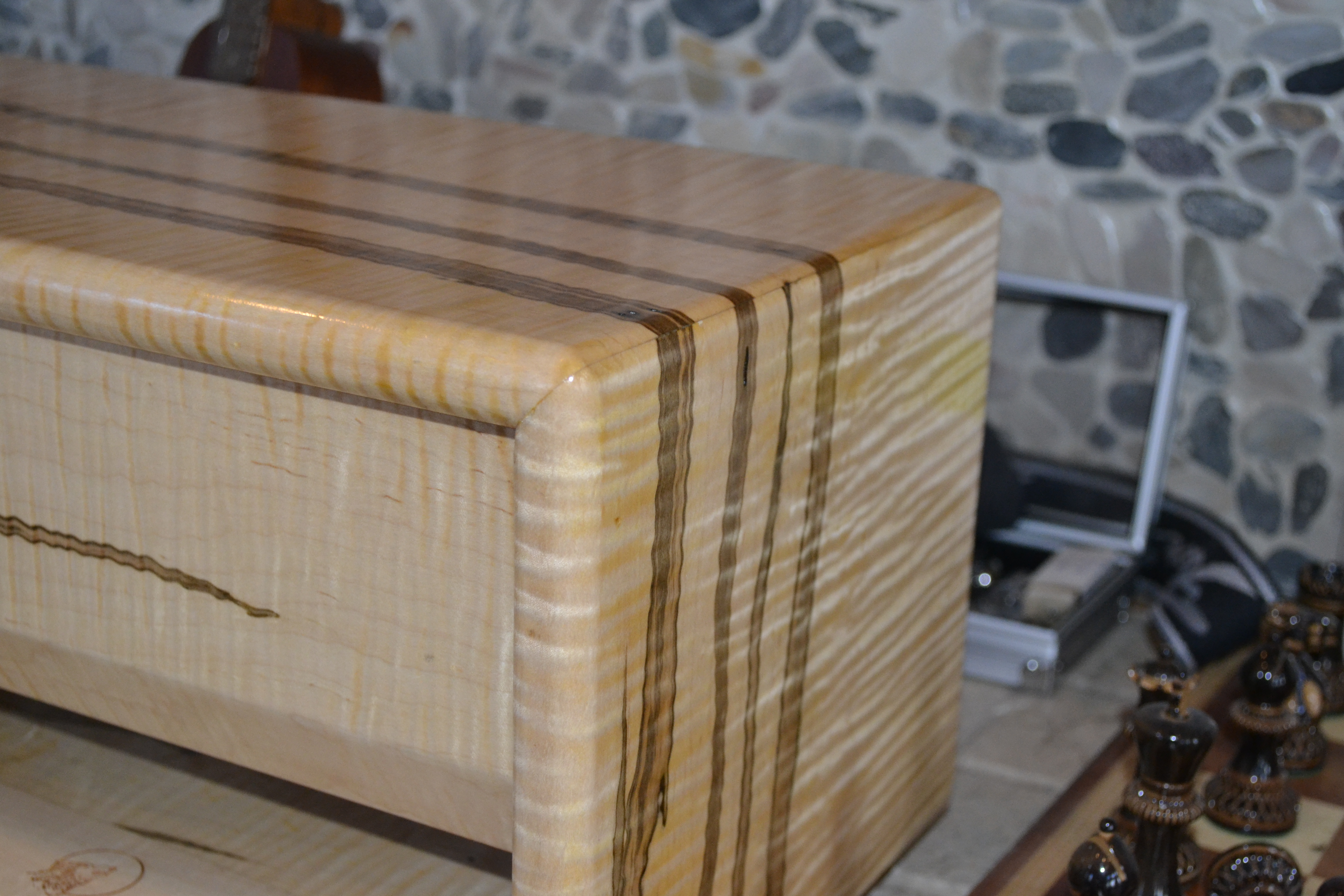

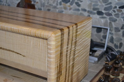

I use the dominoe by festool,Tendons and glue,Ill tell you what your best tool is several bettsey clamps.Even if the board is cupped a bit they will squeeze it tight.Those clamps are really strong and I put a lot on but they do the trick.

ampmike wrote:I use the dominoe by festool,Tendons and glue,Ill tell you what your best tool is several bettsey clamps.Even if the board is cupped a bit they will squeeze it tight.Those clamps are really strong and I put a lot on but they do the trick.
That there is one fine looking cabinet. Loves me some tiger maple.
Nice work Mike.
