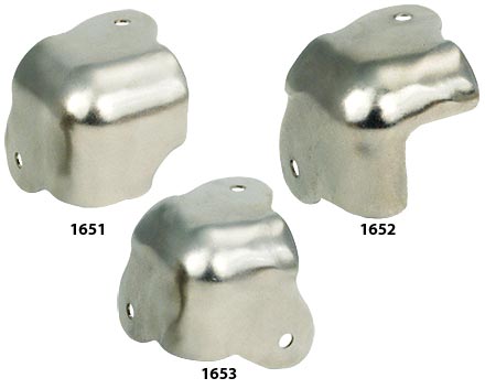

I've got an ordinary pine head case glued together (dovetail joints). I intend to cover it in black and I want to use corner covers. So, I have some questions.
What is the proper round over radius for the metal corners and what kind should I get.
Here is a random choice for some visuals: http://www.parts-express.com/brand/penn ... 2_647-2040
Should I use metal 2 leg or 3 leg type? Or should I just get the plastic kind like this: http://www.parts-express.com/pe/showdet ... er=260-708
Am I correct in thinking I need to run the round over bit over the dovetails and all around the outside of the front and back?
Beyond the corner hardware, should I round over the inside edge, maybe 1/4" radius. Will that make wrapping the tolex easier or more difficult?

1/2" radius is standard for the metal corners found on Fender amps. Typically all outside edges are rounded, and the 2-screw "lipped" corners are used. They are finished in either chrome or nickel. Marshall Nylon corners are made to fit a 3/4" radius, but the back edges are not rounded. I think you'll want to break the corner on edges that are not rounded over, maybe chamfer ~1/16".
Re: Round over radius?
Yeah Martin's got it. 1/2" is what I ended up with after trying 1/4". If you're not so picky about the inside edges, I'd just go over it lighly with some not so rough sand paper just to get rid of the harsh 90* angle. Maybe 220 grit? I'm not too informed on those as I just use what's lying around.Phil_S wrote:Man....do I feel silly asking this after looking at Decko's maple cab. Isn't that something!

I picked up a few things working with Taylor on a couple of cabs ;^). BTW, you'll want to drill and countersink the holes before you put the covering on.
For the 1/2" radius corners, which all Penn-Elcom seem to be, a 3/8 can work once the covering has been laid on which seems to increase the radius a bit.
I have found a couple of corner types which may fit a 1/4" roundover. The small plastic interlocking type seems to be made for a smaller radius. In metal, the early Ampeg corners in both 2 and 3 prong have a smaller radius. They are at Fliptops and also at Vibroworld (apparently closed at the moment?) which states the radius at 5/16".

Tips from me: if ordering the cheap generic fender chrome corners (Mojo) you should inspect them on arrival as I've had many that weren't even chromed or chromed so poorly they might as well not been. I only found out months later when I put them on and then only noticed more months latter when I saw them in good light. This happened on more than one order. Had to replace them all as it made me ill looking at them. This guy has been higher quality: http://www.speakerbuildersupply.com/servlet/StoreFront
And BTW with Mojo check your Tolex and your grillcloth too on arrival and in good light, as I have two cabs with shit flawed cloth - light dark bands, mojo credited me but I'm not going to suffer to redo them now and sorta sucks.
I've been using 3/8 round over as that is what someone told me before there was an internet, and yes it works ok. It's hard to use a 1/2 round-over w/ a hand router, a milk crate, spring clamps, on 3/4 pine - not much for the bit to ride on. If setting up get a counter-sinking bit for the corners made for oval head screws and countersink before you do the tolex. Mark the corners inside where they go as they are poorly made and after hammering they become kinda custom.
