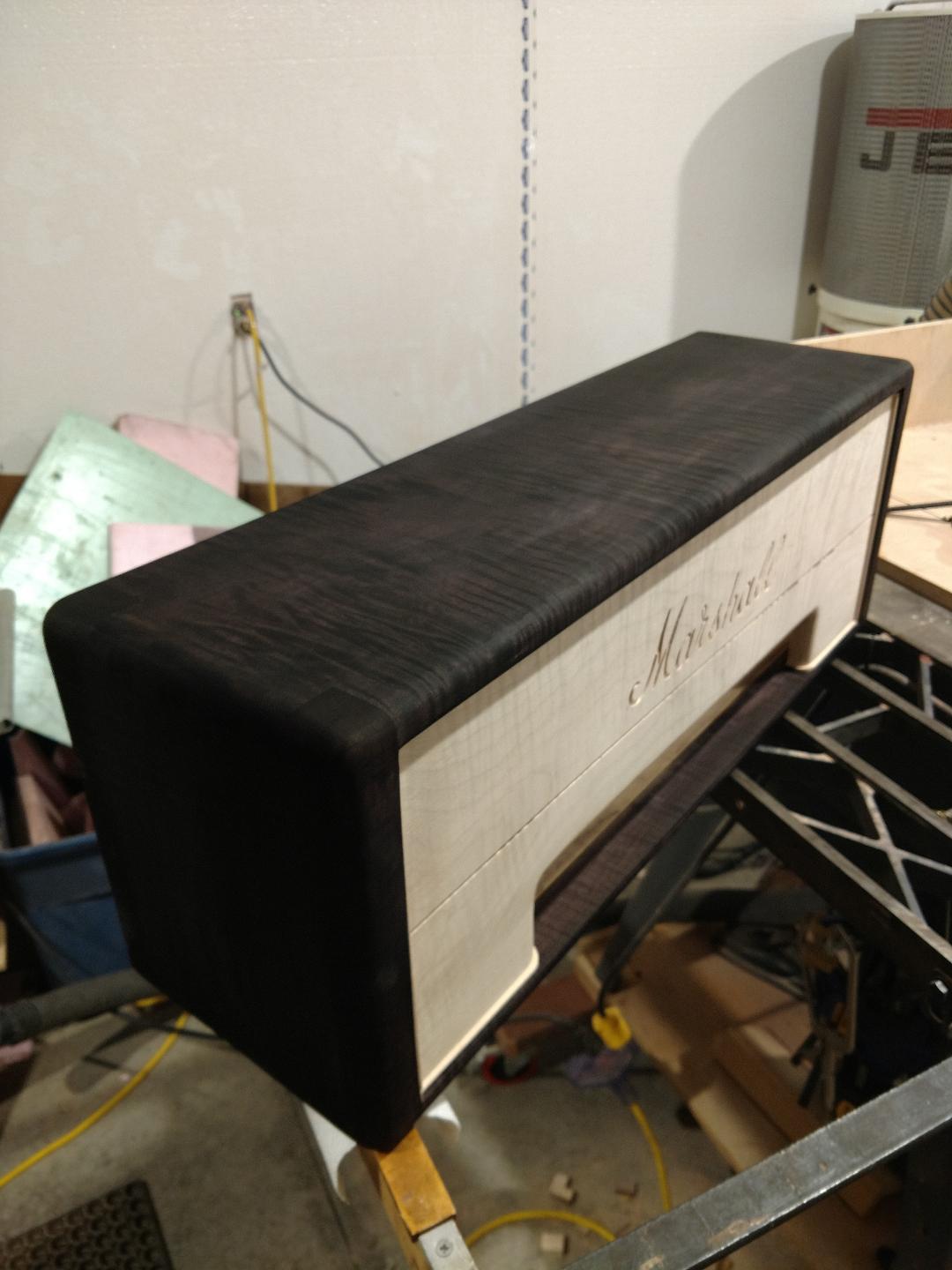

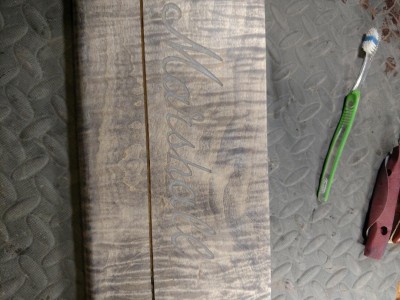

Black under layer applied - RIT dye - which will be sanded back then scarlet rubbed in before lacquer.

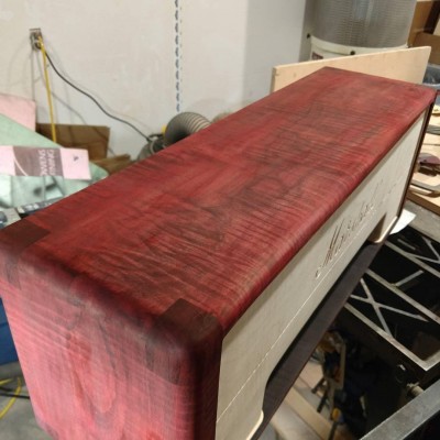

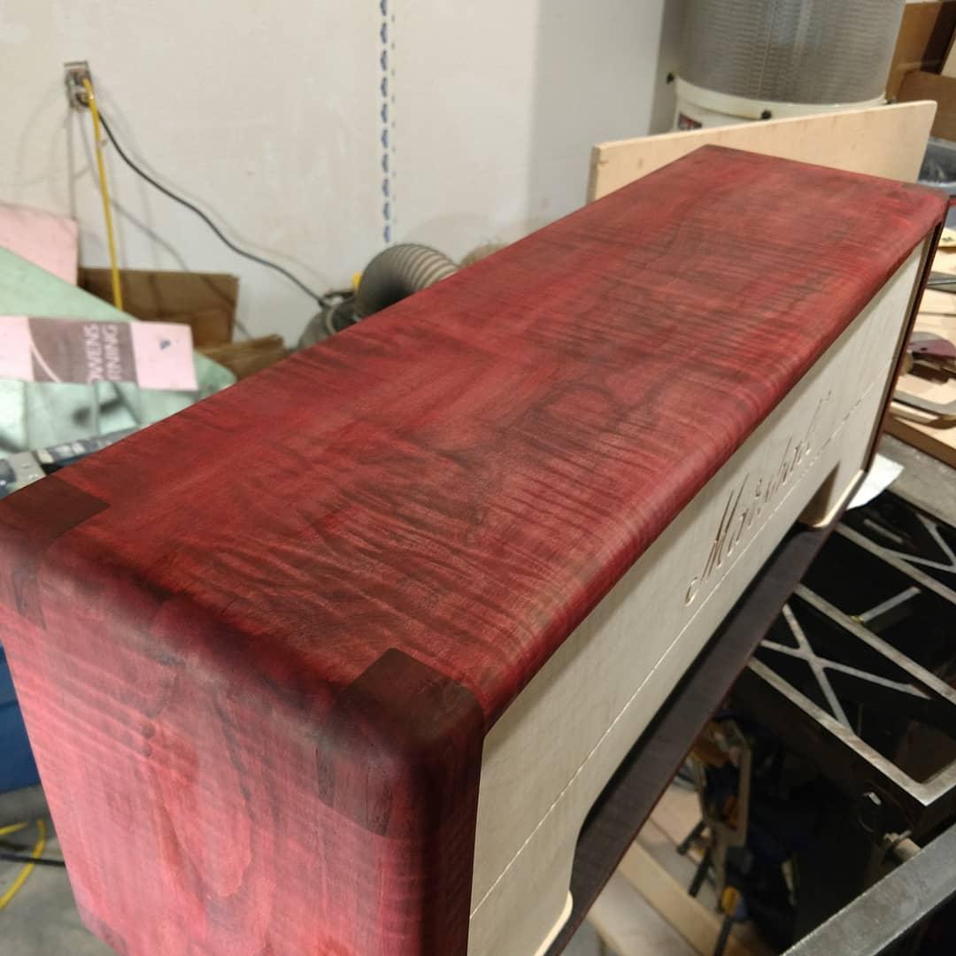

Re: Fiddleback Maple JMP 2203 headshell

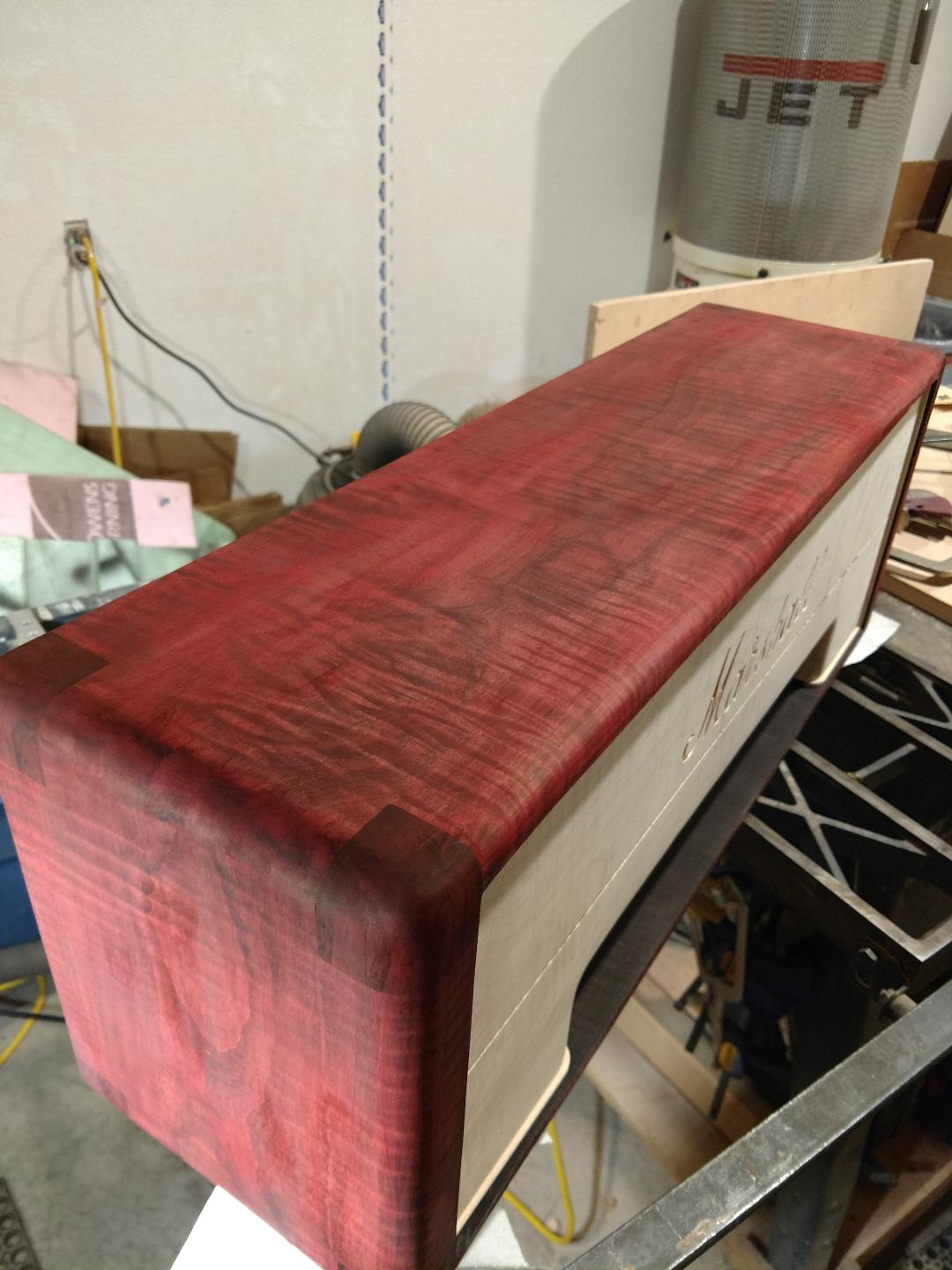

Now dyed scarlet - may need another dose.

Question ………….. do you use the RIT dye in the same manner that you'd use analine dye for wood? Anything to be aware of using the RIT dye instead of analine?
With respect, 10thtx

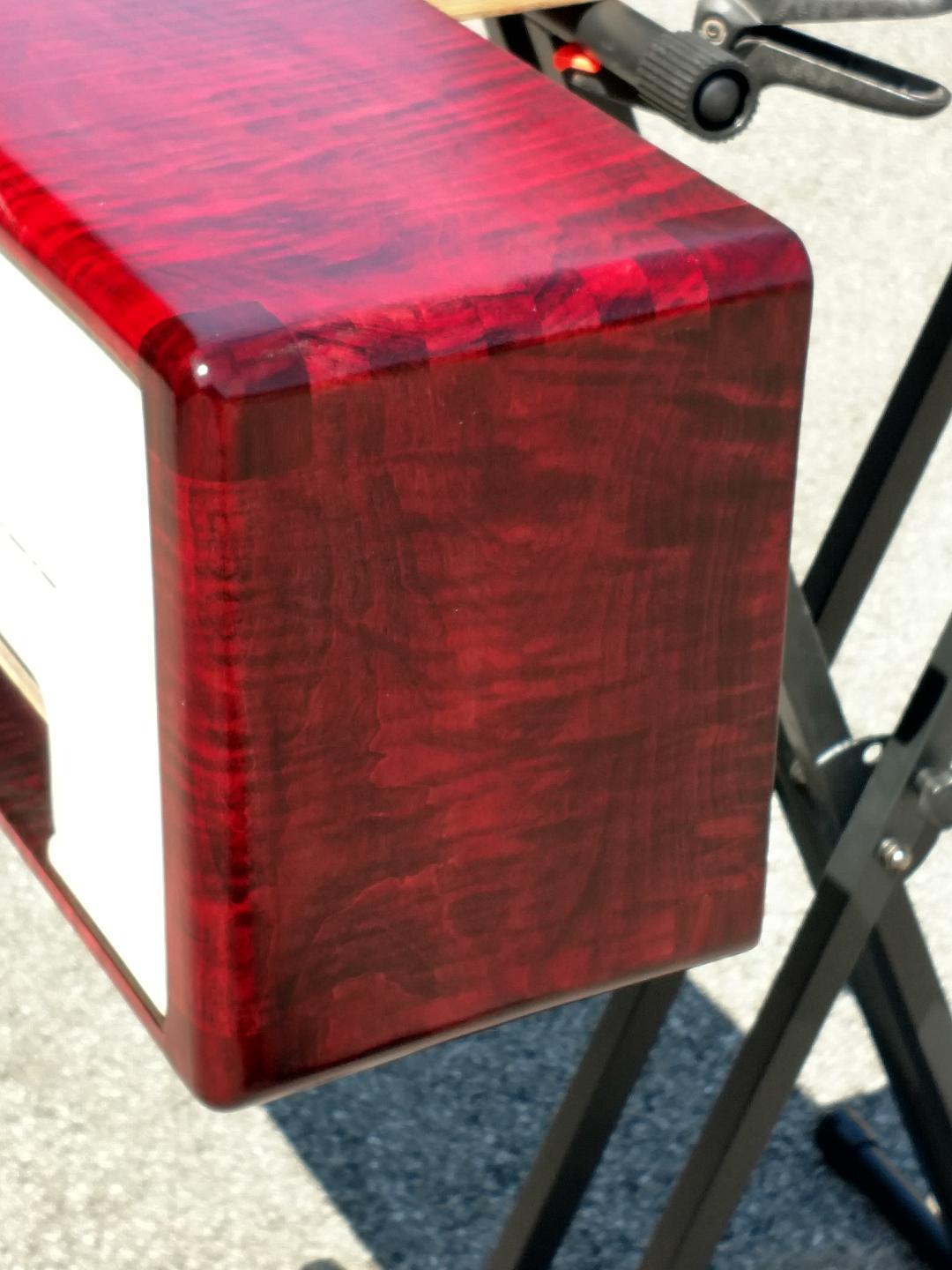

I use a piece of tee shirt and rub it like it owes me money. If you get streaks take a damp paper towel and gently wipe to pull up the excess. I find it raises the grain less than most dyes. After I sanded back the black and stuck on two doses of scarlet I didn't have any raised grain.

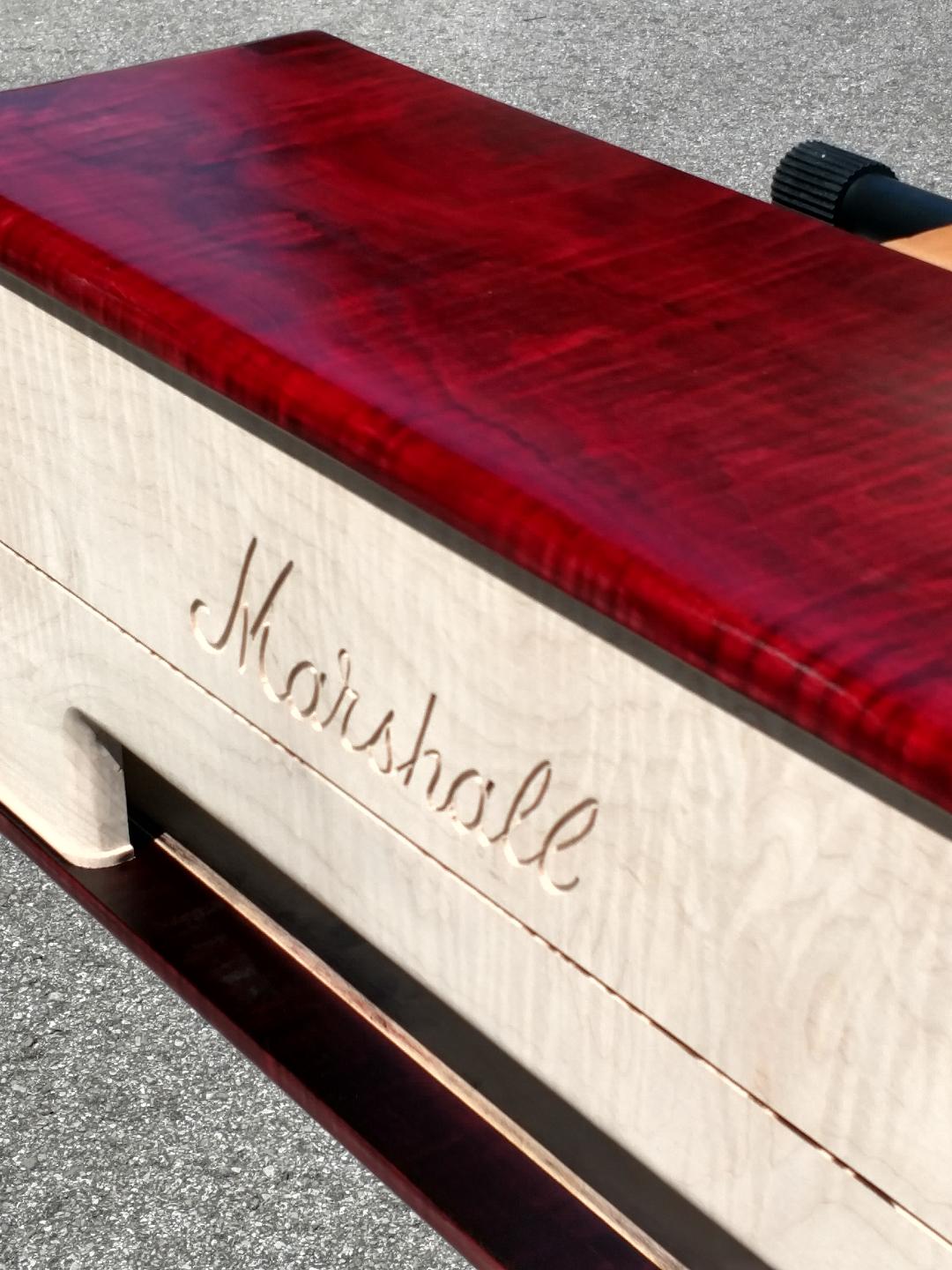

Six coats of lacquer - I had to drag it outside to get decent pics.

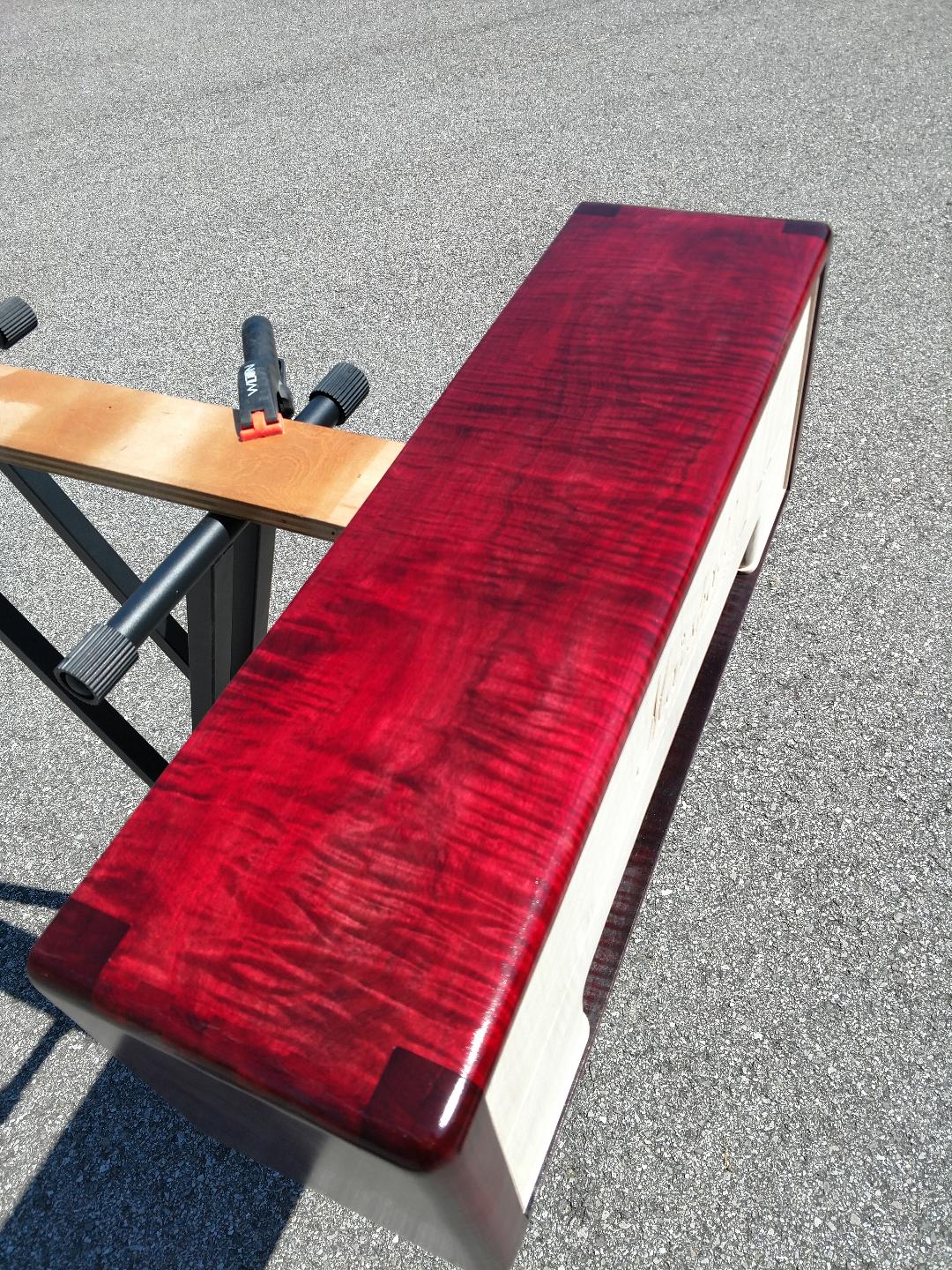

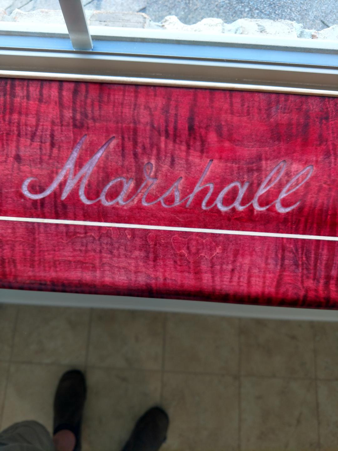

I've got the case dyed and finished but ground to a halt on the logo filling. Dyed and waiting lacquer.
Here are some sunlit pics and they barely do the finish justice.

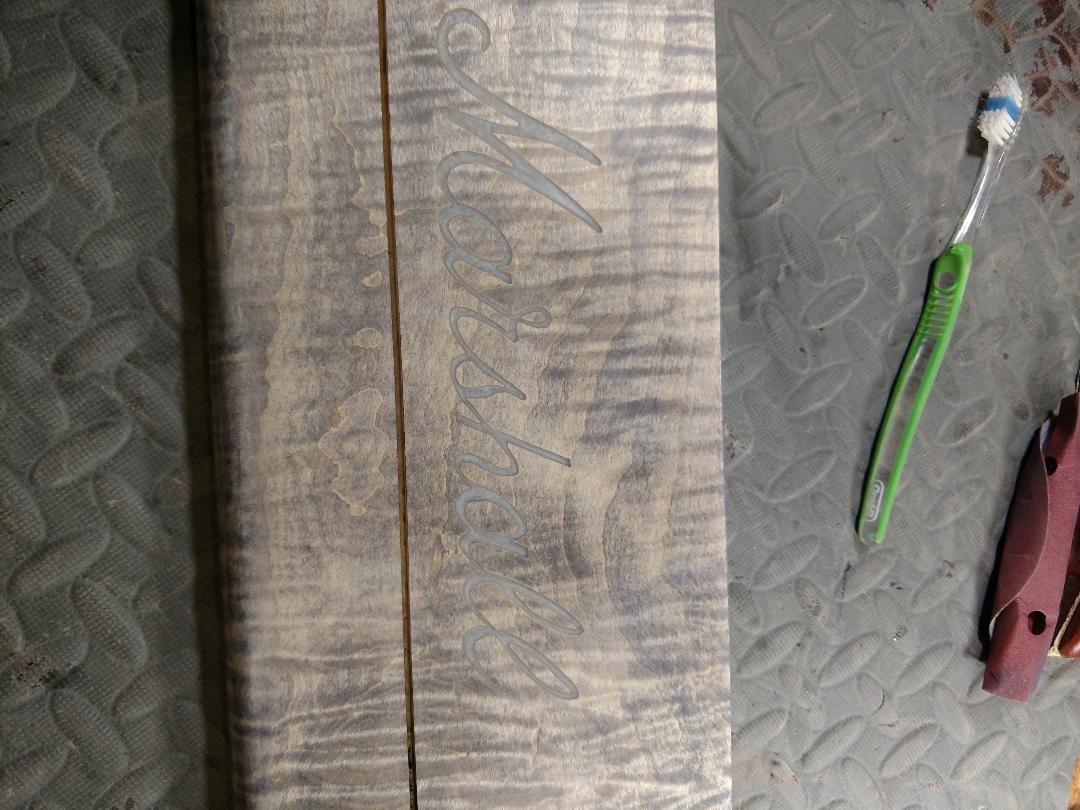

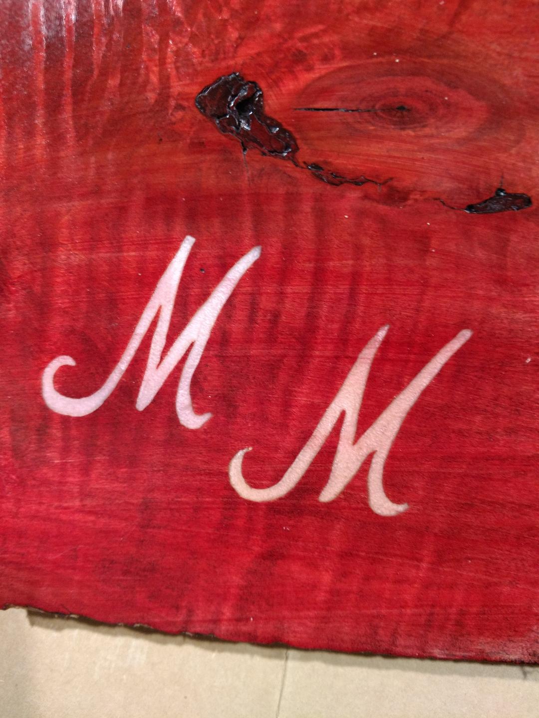

The logo was killing me as I really wanted to use a silver filler but the epoxy absorbed too much dye for it to be seen. In a moment of desperation I swiped it with acetone and viola there it is.

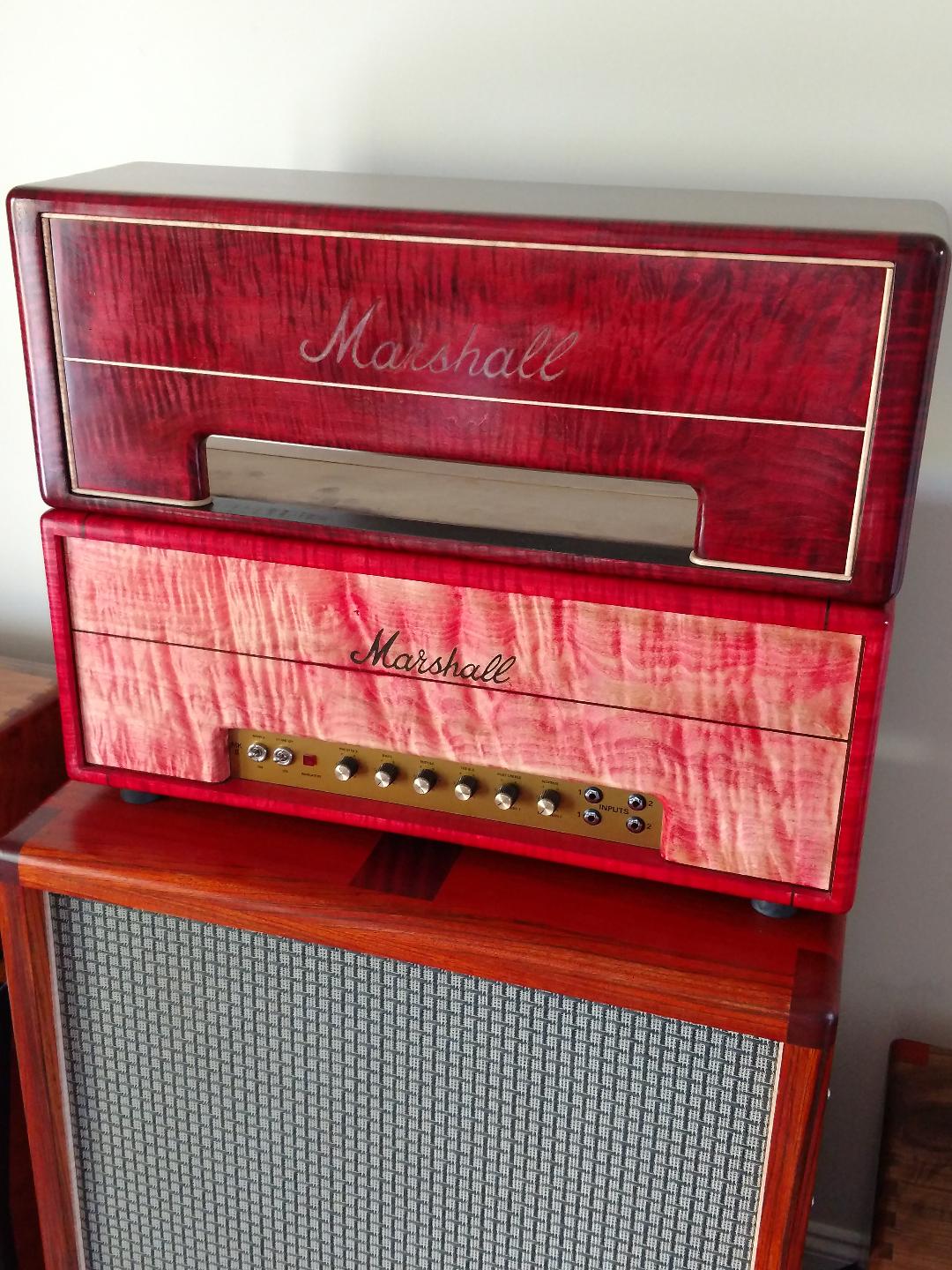

Since I paused to figure the logo out I was distracted by another cab build.

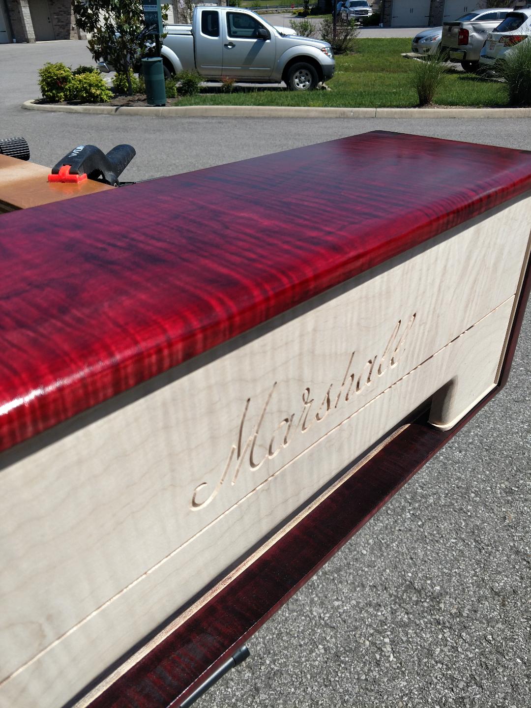

I'm confused, isn't the logo on the front valence which is not dyed?
brewdude wrote: Fri Jun 12, 2020 3:47 pm I'm confused, isn't the logo on the front valence which is not dyed?
The plan is to do the two tone dye job after I fill the logo with silver tinted epoxy. The piping may get some silver rubbed on and sealed with lacquer so it sorta blends with the logo.

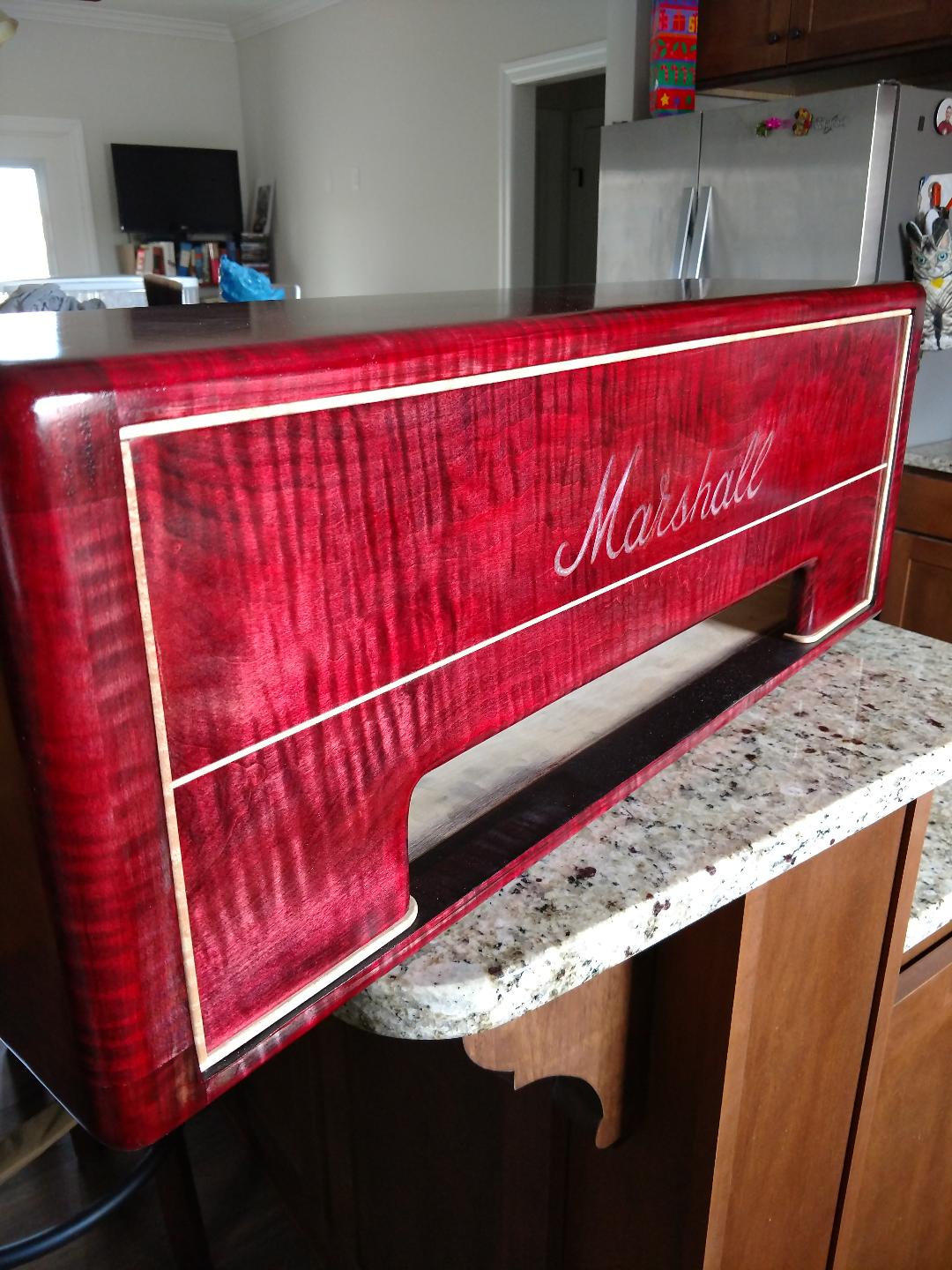

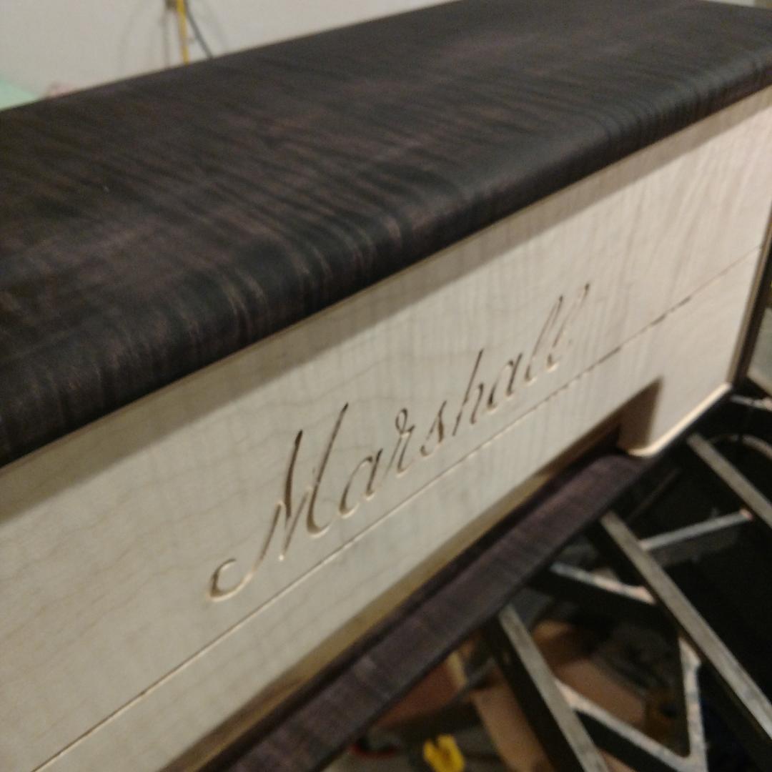

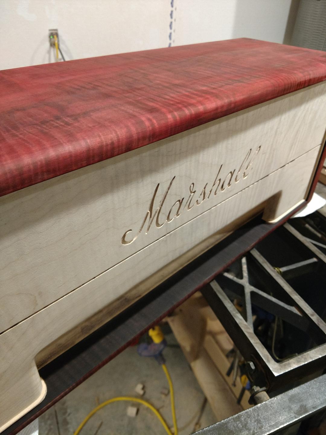

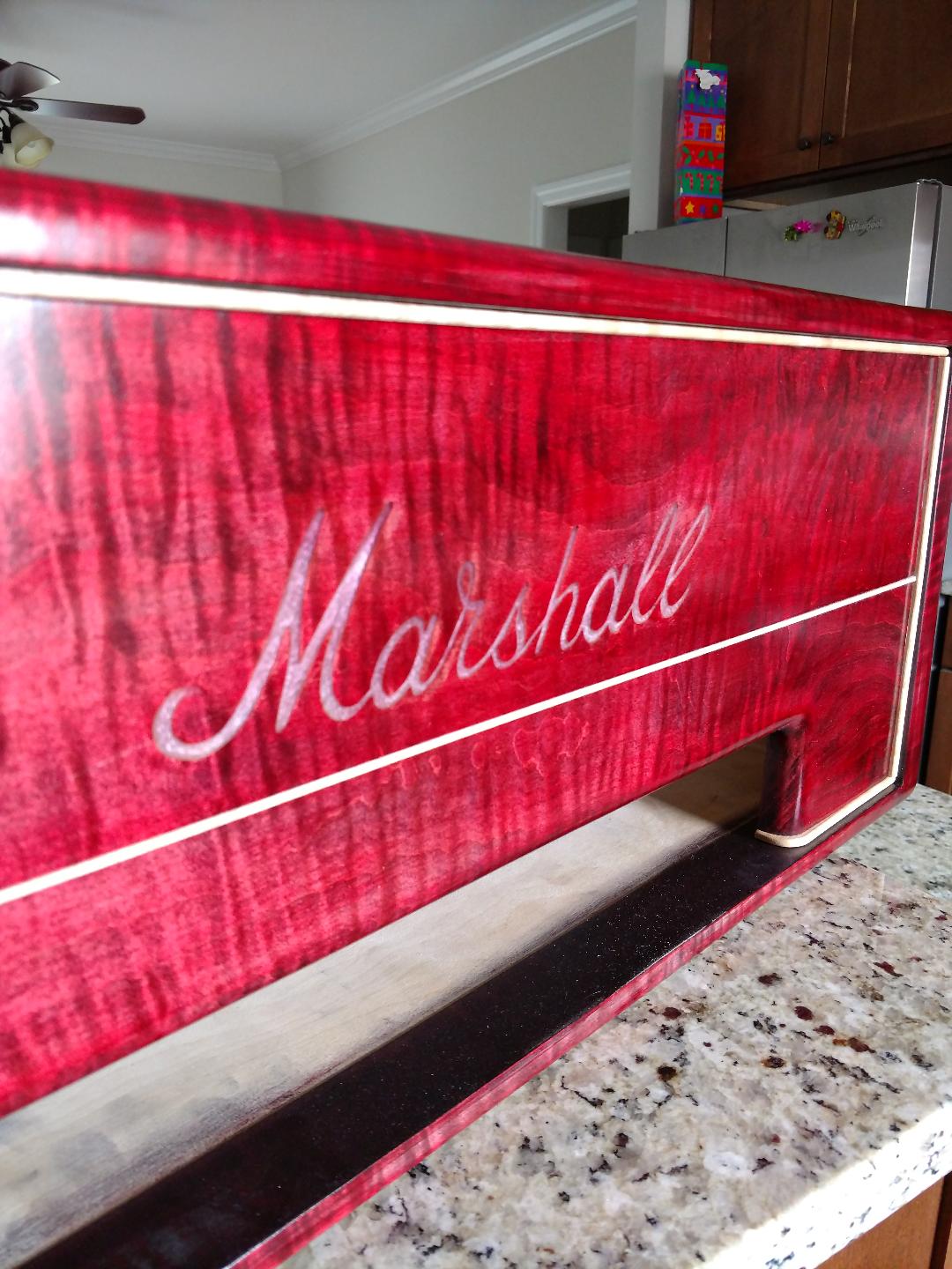

In the end I shoulda used 2X more tinting powder but it serves its purpose. Dyed black and sanded back for the under color.
Dyed scarlet, lacquered and the piping added.
Stuck in the headshell.
Still needs feet, a handle and a JMP2203 stuffed in...
