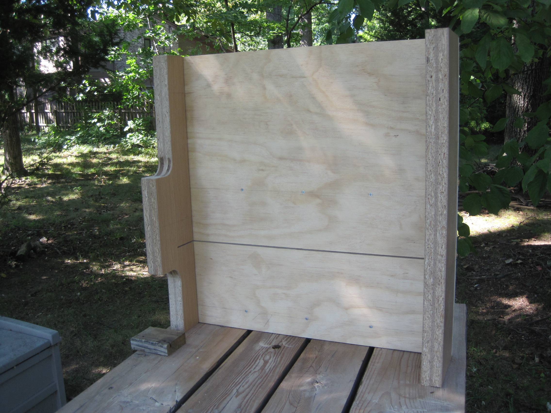

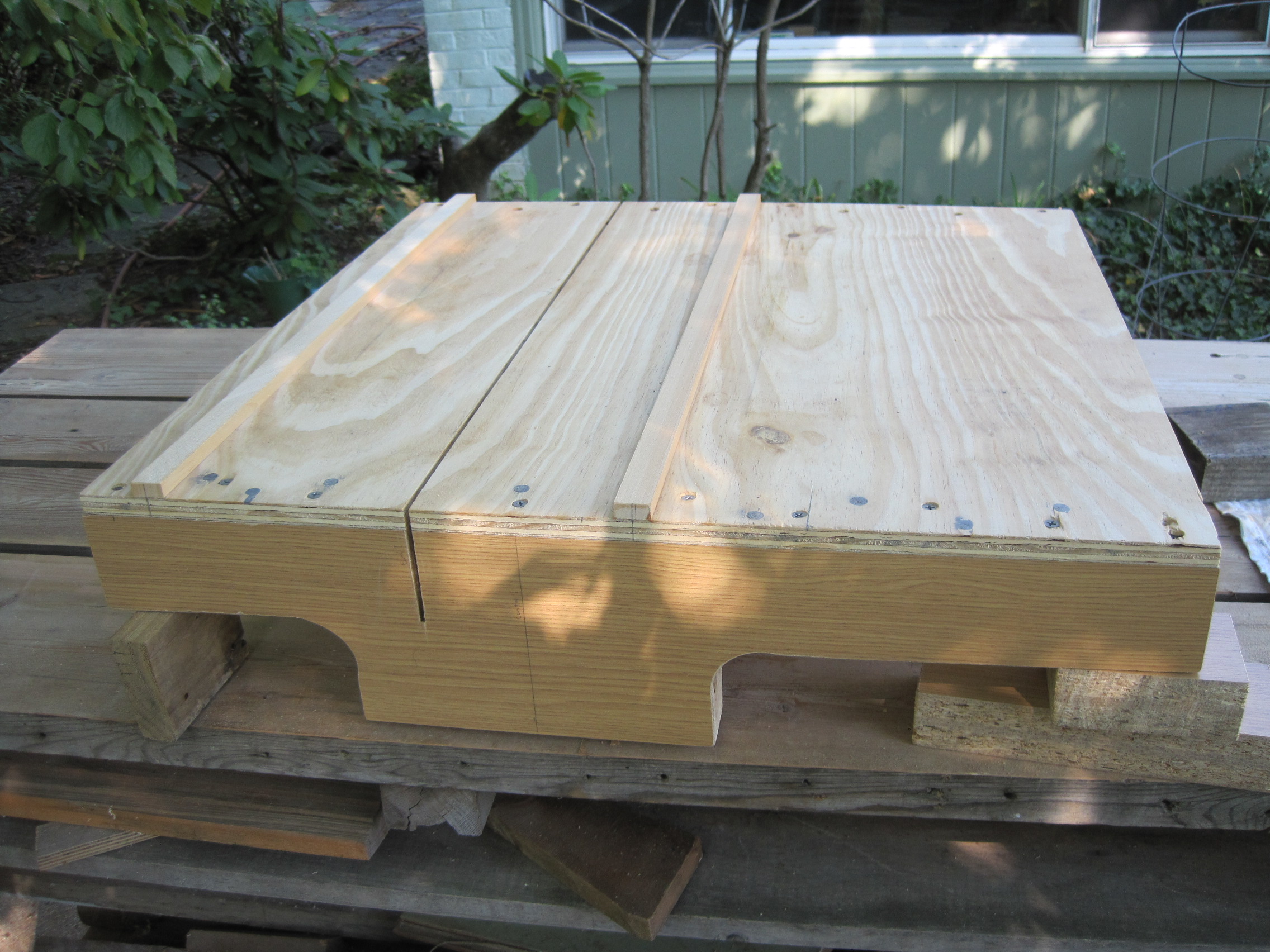

I've been working on the crosscut sled. It has taken quite a few hours. I'm taking my time. One serious impediment is making that first straight reference cut. Then, I had to make the back fence twice due to a newbie error, failing to consider the round blade cuts more on the face down side ;-(. I used a handsaw the 2nd time! The challenge is setting the rear fence square to the blade. On first shot, I had it off by about .00075" per inch. Over 20", that's an error of .015". I am the type who can't leave well enough alone. I figured (and seen on youtube, so it must be possible) that I could use a feeler gauge and a stopblock to adjust the fence to almost nothing. However, that attempt was futile and I move the fence back to it's original screw hole. When I did that, the error (by the 5 cut method) was only .00023" or about 5 mills over 20" ;-} So, go figure, I did better. I've got to add a rear safety housing for the blade and a plexiglass blade guard. I was able to use the sled to cut the blocks for the rear guard! I put a coat of Minwax paste finish on the bottom to help it slide. Here are a couple of pics.

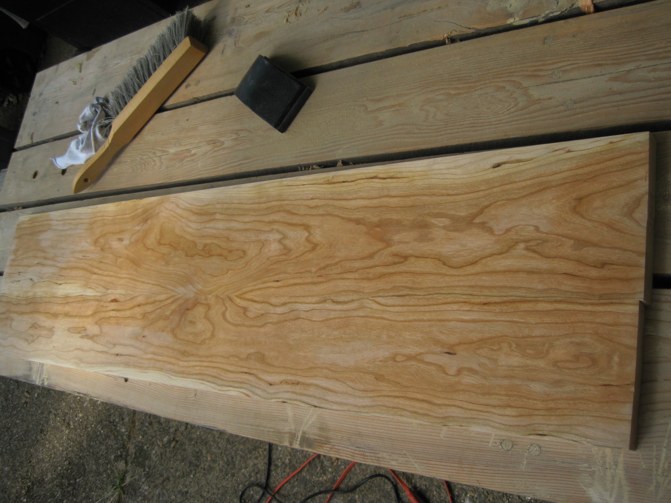

Slow progress on this head cab. First time around, new working with a table saw, all sorts of things that slow me down. I spent some time building various jigs, with some do-overs. I've now got two for ripping the first edge, one for 24" shorts and one for 48". The longer one is heavy and harder to control. I also built a more appropriate router sled jig so I could plane the lumber with a 1.25" bottom cleaning dado bit.
I've finally got the wood planned to about 13/16", but it was looking very rough. I was reticent to use a hand plane on it since my earlier attempts taught me the grain runs every which way on these boards and I was gouging the wood. I'm sure my technique leaves something to be desired, too. (The blade is properly sharp and works great on pine.) I finally settled on the block plane set very shallow. That removed a great deal of the rough fuzz. Then 220 sandpaper with an electric sander (front-back type that takes 1/3 sheet of paper, not the round disk type) took off more of the fuzz".
The questions:

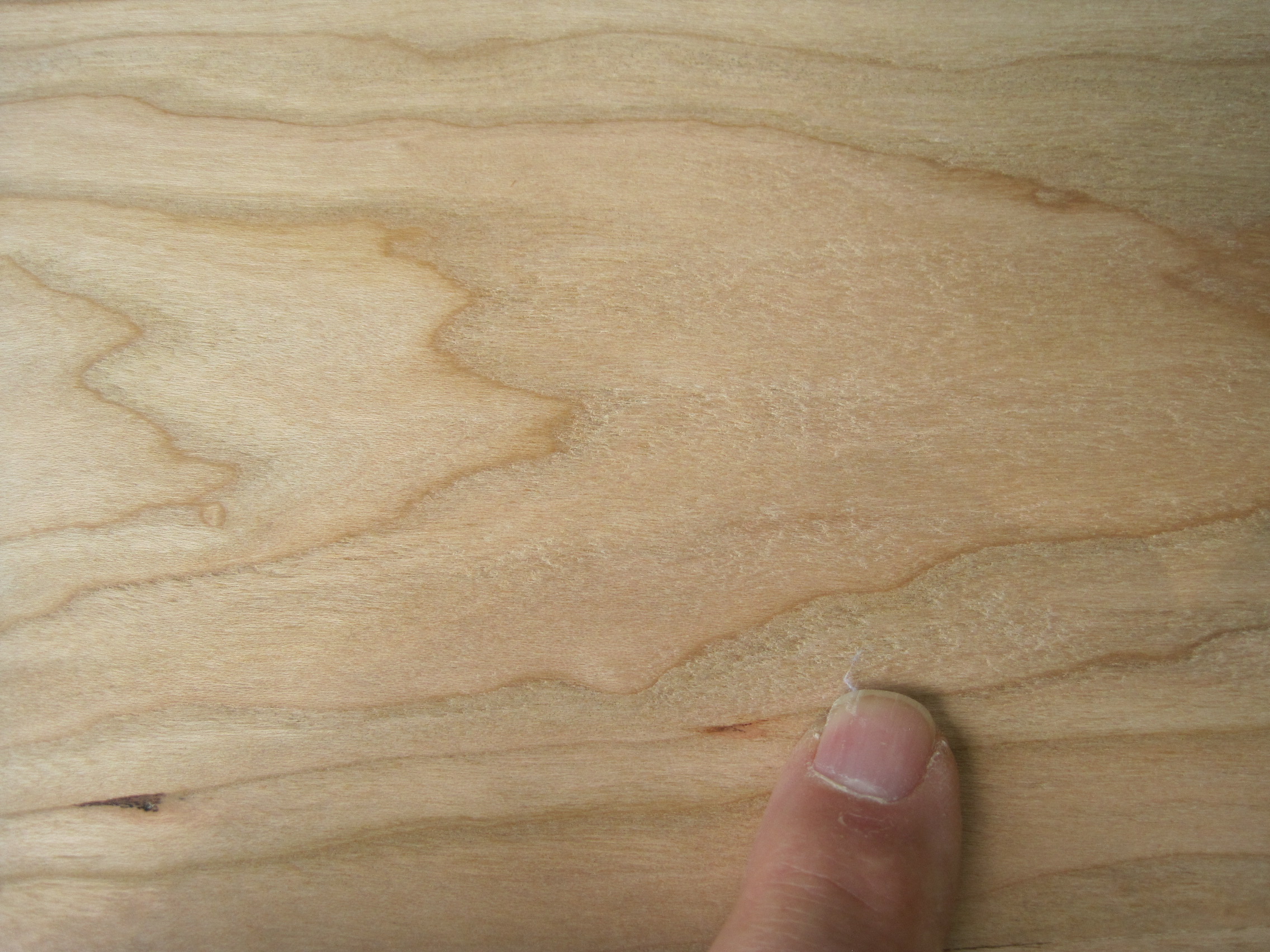

--Do I bother to try to sand more to rid the board of all the fuzz Pic 2832)? See the picture, I'm pointing to some. What grit? There are spots on the wood where it is silky smooth and very elegant. Just not 100%.
--Does this get better when I apply some finish to the wood? (Note, wiped with a damp rag to show contrast of light sapwood and darker.)
--Should I apply some sort of light stain (what color?) to show off the grain?
--What type of finish? I'm leaning towards paste wax because I have some of that. I'm curious about people's preferences. This amp is for home use, so I can ignore considerations for gigging conditions.

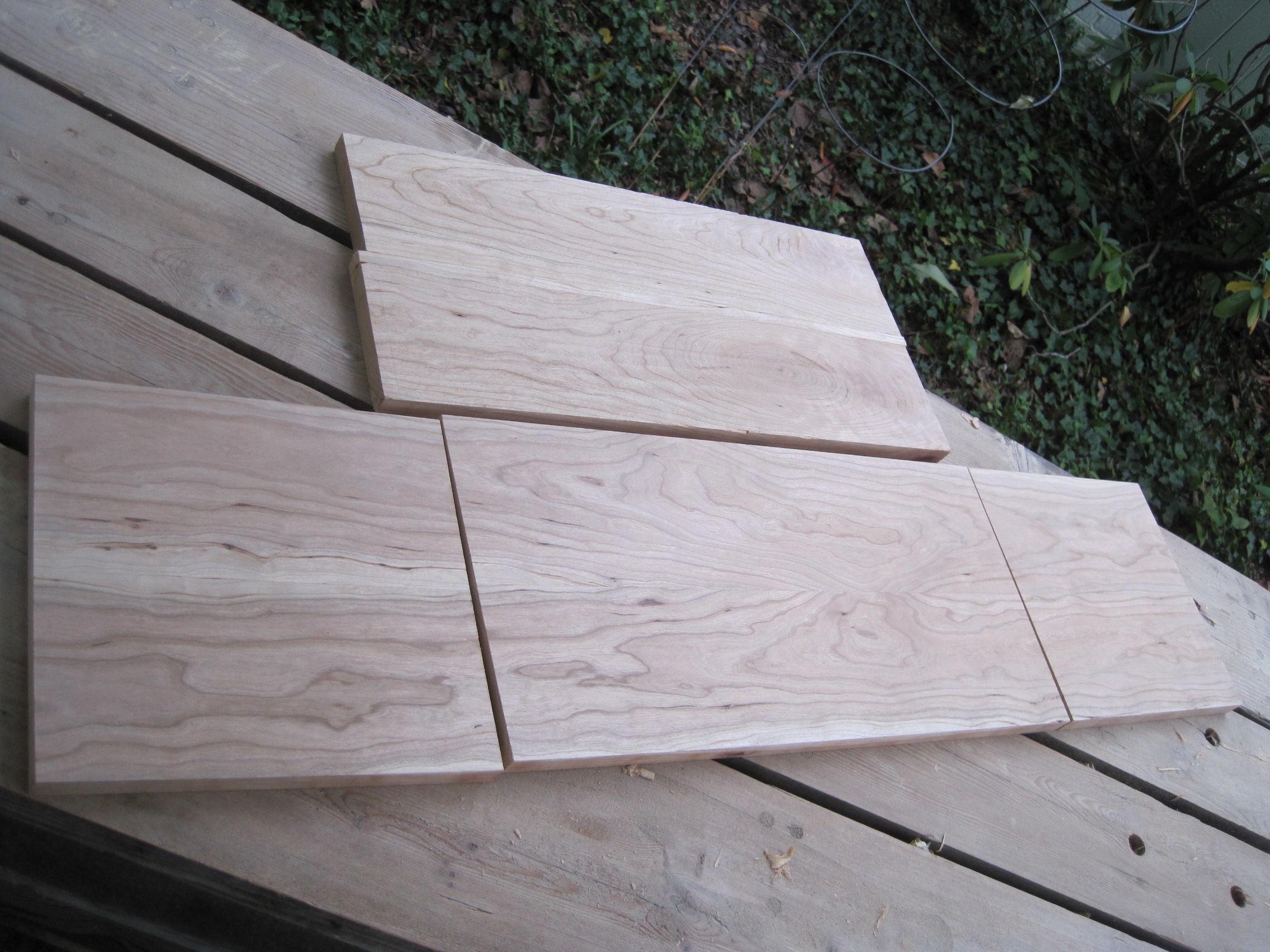

--Cutting. The board in the pic is ~44.5" (pic 2836). I need to get the top (20") and 2 sides (10") out of it. It turns out the boards appear to be from the same tree -- not quite book matched, but pleasant enough at the joint in the middle. So, I want to cut 10-20-10. Should I cut and then sand or sand more and then cut? The bottom will be made from another piece, not shown.

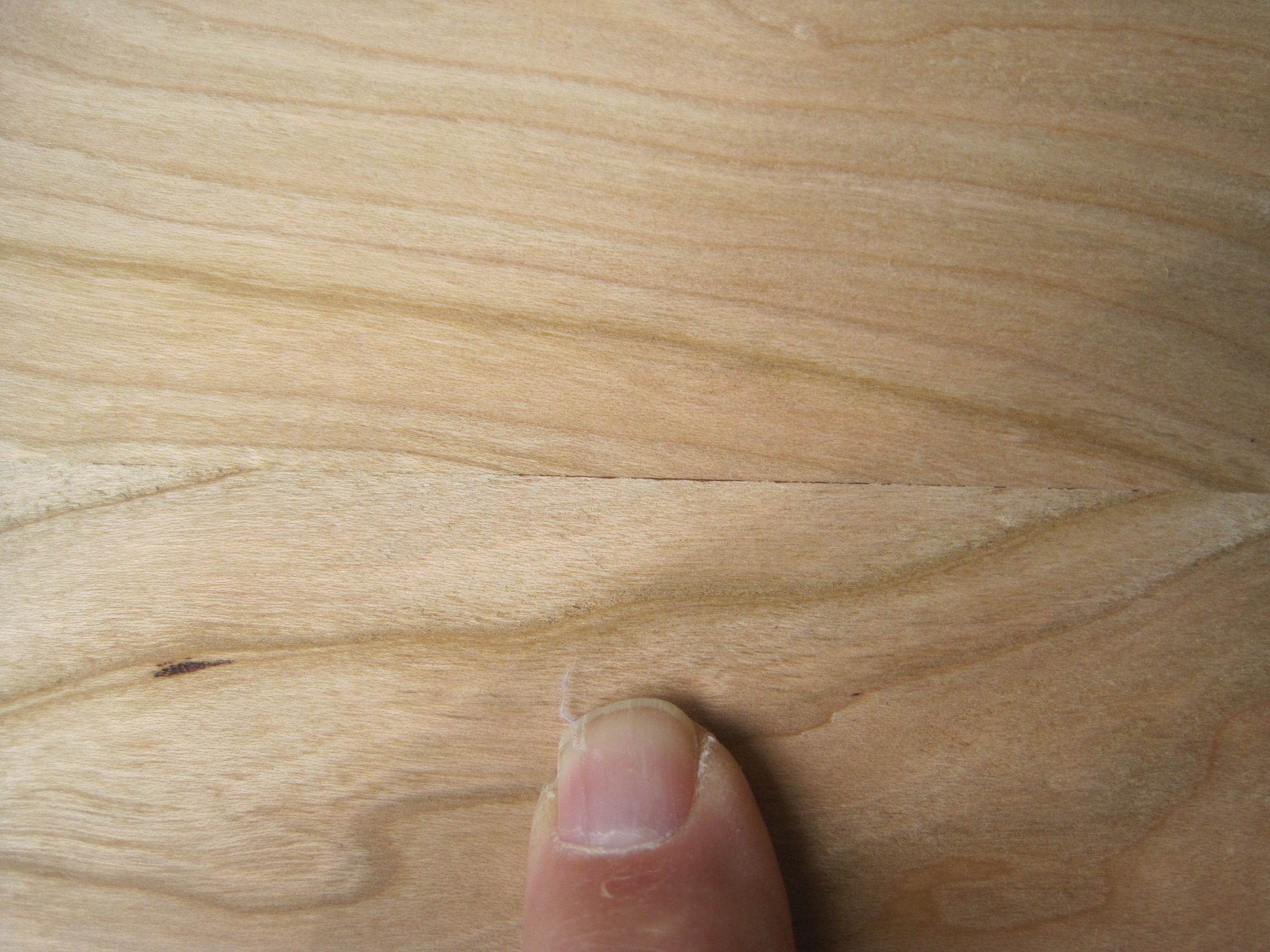

--The joint shows in a few spots (pic 2833). It is imperceptible to the touch. Do I ignore this? Any way to hide it? It's not terrible. Considering I jointed it on the saw, it came out better than I imagined. I had to use clamping force to close a few spots and that seems to have worked, mostly.

Cherry is hard and brittle, so it chips easily and burns if you feed too slow. I think what you have there is tear-out caused by the cutter edge getting under the grain, which is running out of the surface (not parallel to it). This can be dealt with by feeding the board through the planer in the opposite direction, or running the hand plane in the opposite direction. Curly boards have varying grain direction though, so one feed direction may be as bad as the other. It cold be that one of the glued-up boards has rising grain while the other has falling when viewed from one end. Sanding will ged rid of it, but you have to remove a lot of material. Drum sanders that are built like a planer are made for that. I would use 150 to take it down quickly without making deep scratches, then 220 and 320.

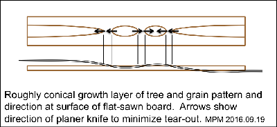

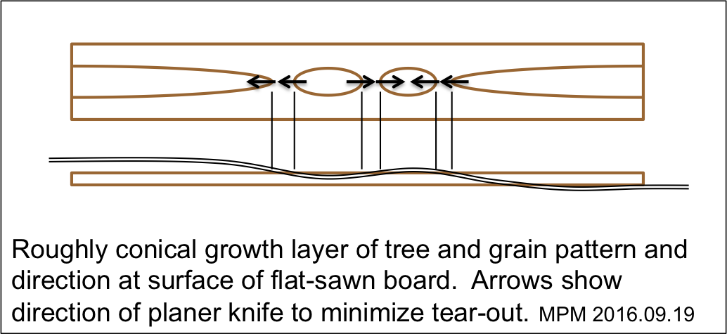

Reading the grain on this wood proved to be challenging. I finally figured out that the grain pattern is like a topographic map. The concentric circles go up to the high points. The grain runs towards (or is it against) the mountain top.
Needless to say, this has been an eye opening experience. What I found hard to figure is the seller planed it, but that didn't take out the bow/cup or the twist, so what was the point? I'd much rather he'd sold it rough sawn. One thing, though, is that the wood was nice and shiny after he put it through the planer. I want to get it back to shiny.
Since the plainer is a router with a bottom cleaning bit, I can move it in any direction, but now I am done with that because I've glued up the boards and the sled isn't wide enough. Besides, I don't really want to take off another 1/8" or more. Also, it is too easy to leave a burn mark. Due to the bit diameter, I'm running the router at 18K RPM. This is the speed recommended by the outfit that sold me the bit.

The grain direction depends on whether the loop or arch was created by a hill or a valley. See below.Phil_S wrote:Reading the grain on this wood proved to be challenging. I finally figured out that the grain pattern is like a topographic map. The concentric circles go up to the high points. The grain runs towards (or is it against) the mountain top.
A board can change shape after planing (due to changing moisture content), but it could be that that the planing was not done correctly, and the boards were flattened by feed roller pressure, only to spring back on the way out.Phil_S wrote:What I found hard to figure is the seller planed it, but that didn't take out the bow/cup or the twist, so what was the point? I'd much rather he'd sold it rough sawn.

Modest progress. The diagram on which way to run the knife helped a great deal. I was able to use a combination of the #4 plane and sand paper. Top and sides are polished to 400 grit. I needed a middle strip for the bottom to make it wide enough and got that when I ripped the top/sides to width. Bottom is glued up and I planed off a good bit of the tear out. The knotty end is a big problem. Since it's the bottom, I won't be quite so picky. Now to sand the bottom and cut to size. Then I get to try out my new half-blind dovetail jig!
