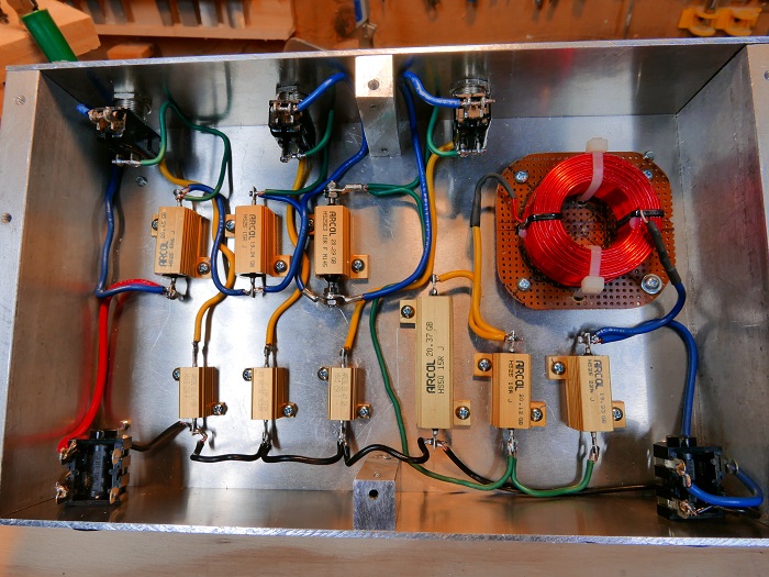

I built one of the Marshall Forum M2 attenuators. https://www.marshallforum.com/threads/s ... ing.98285/
I think it works pretty well. With the attenuator, playing is a different sonic experience, no getting around it. But to me the amp still comes through.
The analogy I would make is that listening to an Allman Brothers CD with the stereo turned down still sounds like Duane and Dickey, but it's not the same sensation as listening with the stereo cranked.
