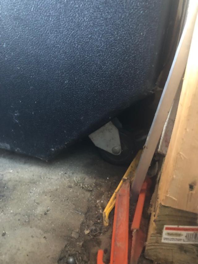

Bought this at a flea market last summer. It is a Sears 4x10 closed back with a really cool design.
The back/bottom is angled with wheels and a handle on the back to tip it and roll away like a built in 2 wheel dolly!
And, the speakers are staggered making the width a bit skinnier and the weight not bad. Also has two handles on the sides.

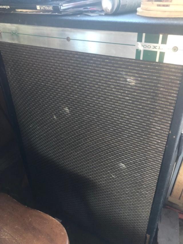

Maybe the grill cloth is on a frame that releases somehow and the speakers are front loaded. I'd be careful not to booger up the cab unless it is structurally unsound (rot, damage, made of inferior materials like MDF or other composite.) If you search, I think you'll find a few threads here about dealing with nicotine or other foul odor. I'd say, on the whole, cold isn't great for it. I wouldn't worry too much about cold. When you bring it in, just leave it for a while to get up to room temperature.

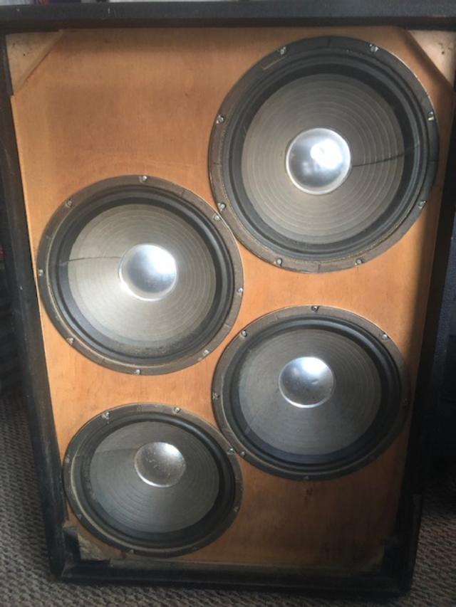

Here ya go. quality 3/4 baffle and sides. Ironically, the back is the crappy particle board.

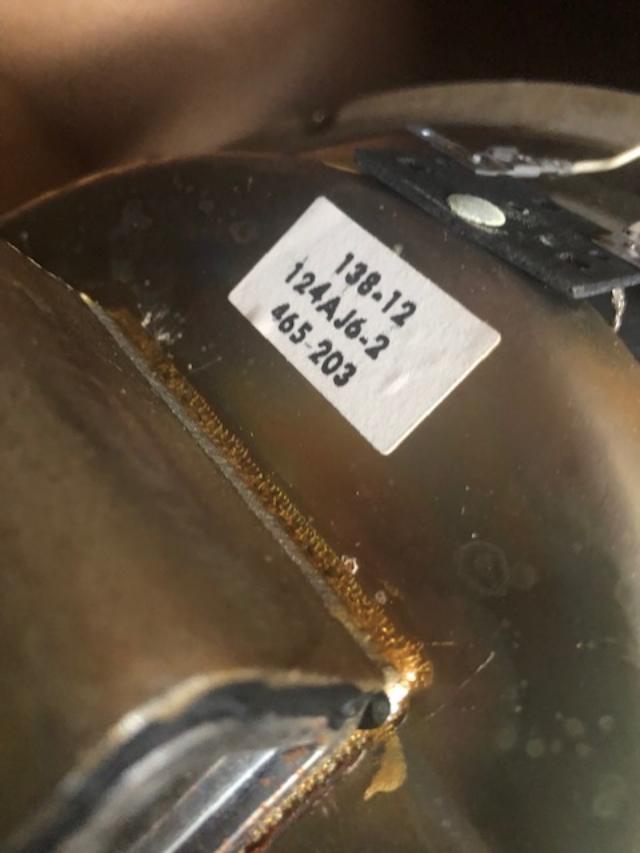

Speakers are really light and feel really cheesy, but I believe original. Any idea of brand?

Oxford speakers?
Re: What should I do with this Sears 4x10 cab?
Agreed, 465 = Oxford. 203 = 1963? 20th week. I think it is safe to say that Oxford is one of those unremarkable brands. Selling a matched set of 4 on eBay might bring you a meaningful amount to put towards other speakers -- I'd guess $100-$150 for the set. There's always a chance you'll find a buyer with no common sense and get more than that.
Before you ditch them, hook up the cab and see what you think. Cheap isn't always bad in the strange world of guitar amps.
You mentioned making it into a "mini 4 x 12" or something like that. I'm not sure what you meant. Looking at the baffle (I'd replace the particle board with plywood) I don't see how you'd be able to fit more than three 12" speakers and that would make for some weird configuration. It looks tight with 4 10's. You might look at a pair of 15's!

No The baffle is 3/4 quality plywood along with the sides top and bottom. The back is particle board.
Re: mini 4x12..I just figured it would sound like one because it is closed back but 10s.
It is 8 ohms right now, I wanted to get something in there that is 16 ohms
