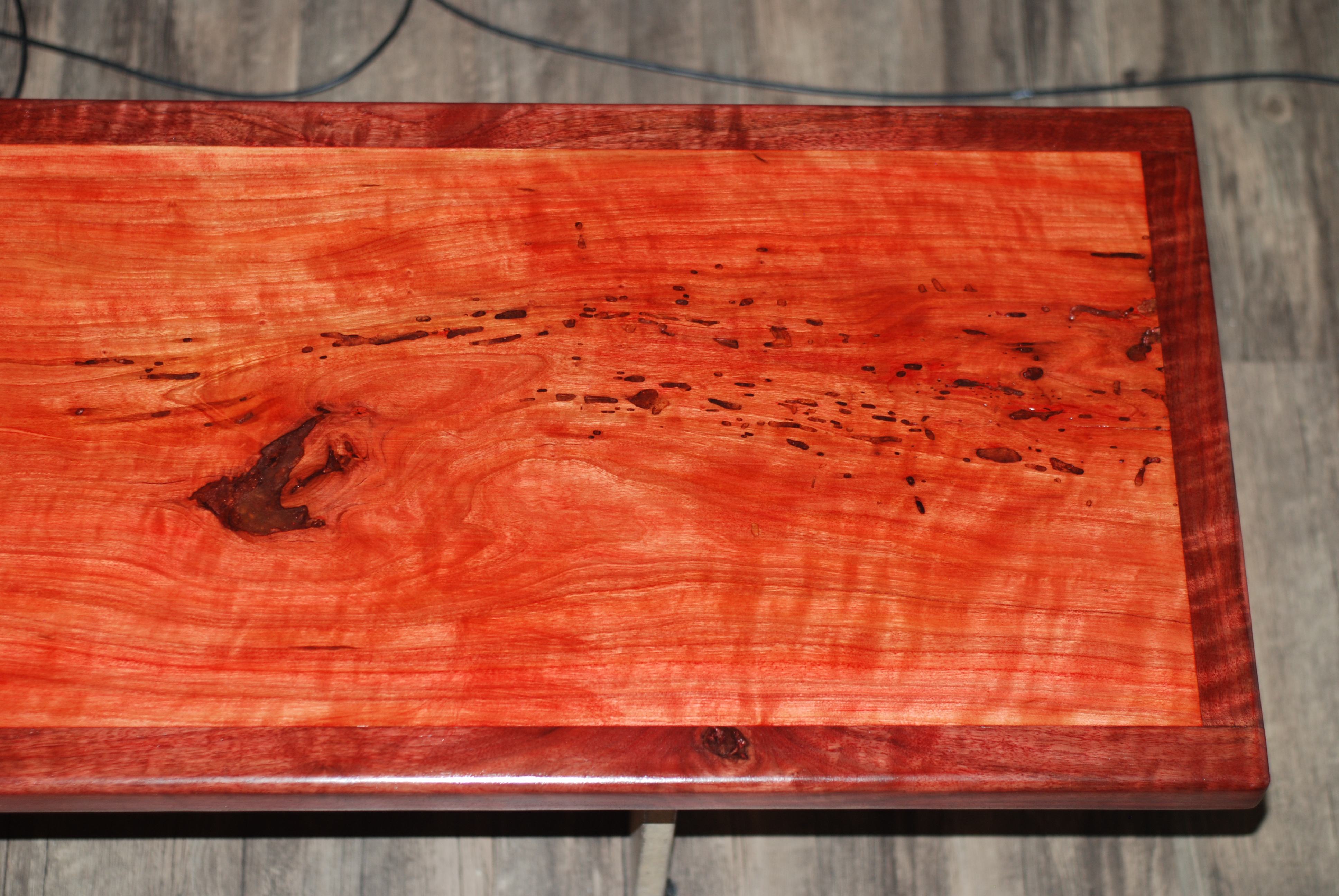

For filling imperfections I use epoxy for bigger stuff 5 minute or 30 minute depending on how hard I need the surface to be. My all time favorite for the small stuff is thin / medium or thick CA which I hit with an aerosol accelerant. That fits my NOW! NOW! NOW! personality. Both can act like a design feature filling in worm holes or imperfections -
Or on a boundary between light and dark wood will almost disappear.

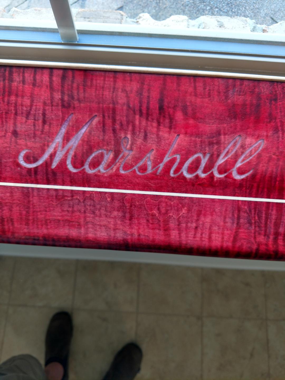

Or with some dye or metallic powder art -
and make a statement.
