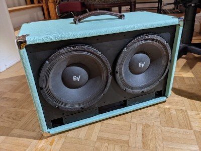

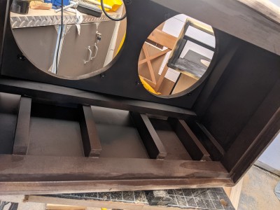

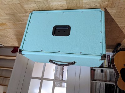

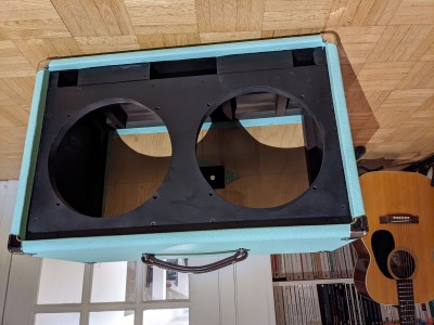

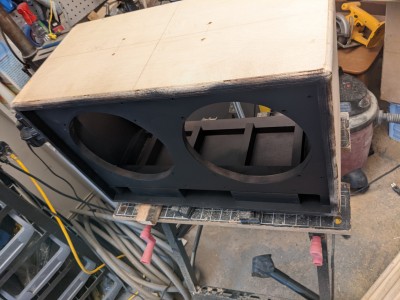

I have been busy the last two weeks completing a 2x10 sealed/ported cab with the EVM, and it is worth the work!
Color is seafoam green, but with the electric light, turns blue ;(
Made a mistake though : I did not keep enough space on the sides to build a grill cloth. So I may have to cope with a light metal grill. It is quite heavy, but the clarity is quite astonishing. Everything feels smooth and not harsh, but defined, even when pushing presence control to the max. Great speakers for sure!
I have almost completed a 1x12 for another EVM L so I will be able to A/B these.

Re: Favourite speaker boxes?
What a beast!
Only 4 bolts per speaker?
Can't you just bolt the speakers from the inside and thus manage enough room for a grilcloth frame?
Of course you'll loose some inside volume but this lost might not be that much significant... if ever possible?
fred.violleau
- Posts: 555
- Joined: Tue Jun 06, 2017 12:20 pm
- Location: Montreal, Canada
Haha @ChopSauce, I love your attention to details.
In the original Boogie Thiele cab, the EVM 12L had only four wood screws! I thought using using four good bolts should be good enough since they squeeze the speaker against the pannel.
Yes it is a beast probably 55-60 pounds (speakers are 20 pounds each...).
Good advice, I could tuck the speakers on the inside and then I would get enough space for a wood framed grill cloth. To be honest I don't know how important the ported thing is, because on the paper it seems to act on the knee of the low frequencies. Which as a guitar player don't care much.
I realized with experience, that trying to get the fullest sound (occupying a large band of frequencies) is not the best way to cut through a mix, have the bass player enjoy playing with you, and even on distortion we usually trim these in the different amplification stages to keep things articulated
Funny thing with that box is I can turn up the bass and it adds low frequencies to the sound, but it also gets mellow, like silkier.. it really is different from my other 2x10 celestions.
I will try to A/B demo these soon. I have to tolex the headcab today for my #183.
