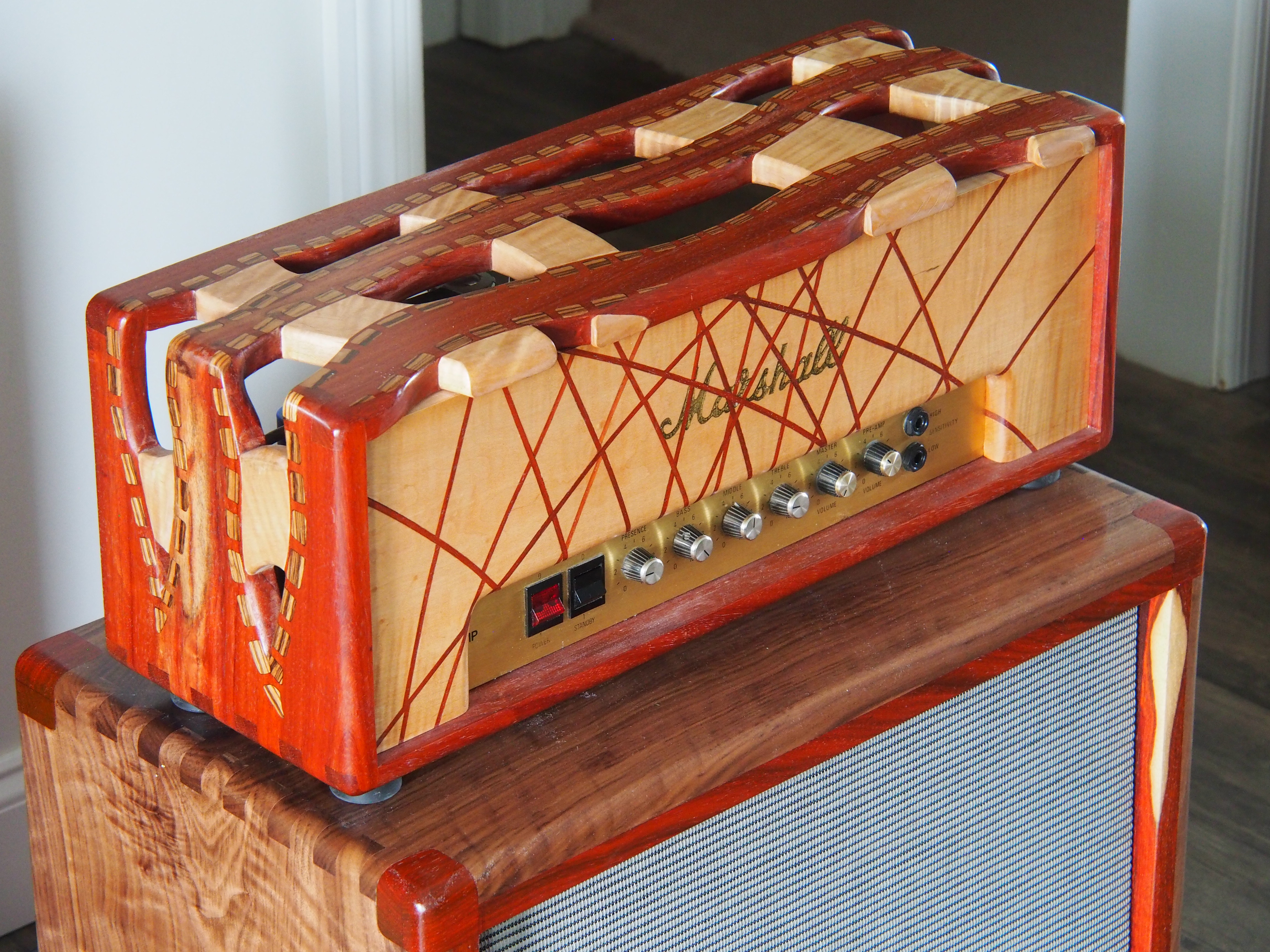

I wouldn't - with the Titebond series the glued joint is stronger than the wood around it. I made a wild headcab for the Dallas Guitar festival a few years back that has three strips of padauk running side to side and edge glued maple running front to back. Those are all load bearing joints unlike the ODS crossbar. The middle strip is also the handle for the JMP2204 which isn't a light amp. Still getting carried about by that handle.

Geeze wrote: Sun Jun 28, 2020 5:42 pm I wouldn't - with the Titebond series the glued joint is stronger than the wood around it. I made a wild headcab for the Dallas Guitar festival a few years back that has three strips of padauk running side to side and edge glued maple running front to back. Those are all load bearing joints unlike the ODS crossbar. The middle strip is also the handle for the JMP2204 which isn't a light amp. Still getting carried about by that handle.
Beautiful work, and extremely ambitious.
I guess a matching cab would be extremely detuned.
Re: ODS Head Cabinet - Basic Crossbar Questions
TUBEDUDE wrote: Wed Jul 08, 2020 10:40 am Beautiful work, and extremely ambitious.
I thought about a speaker cab for about 2 minutes and then remembered the 200+ zebra inlays on the head - it was a big negative. Being a closed back fan thought of a plywood liner or 1/2" plexiglass. But again - no.
