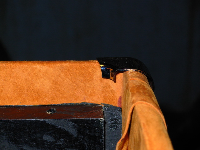

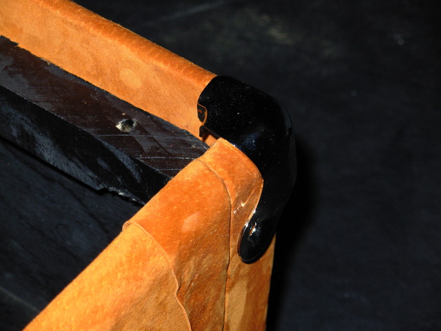

I've started to wrap a cabinet (constructed out of 1/2 inch plywood) for a project of mine. I plan to cover the corners and purchased a set of corners for the job. Apparently, these corners are for cabinets constructed with 3/4 inch plywood and having a 1/2 inch radius. They leave a big gap in the area of the lip which I doubt I can pound out and still be left with an attractive looking cabinet :).
The search I've tried has not been a great success. The sites I've found have little detail on the geometry of the corners. Many mention the 1/2 inch radius. But not many mention the size of the cabinet lumber. It seems to me that someone must make these kinds of corners (pictured below) for use with 1/2 inch lumber. Does anyone know if a similar corner exists and better yet where I can find some?

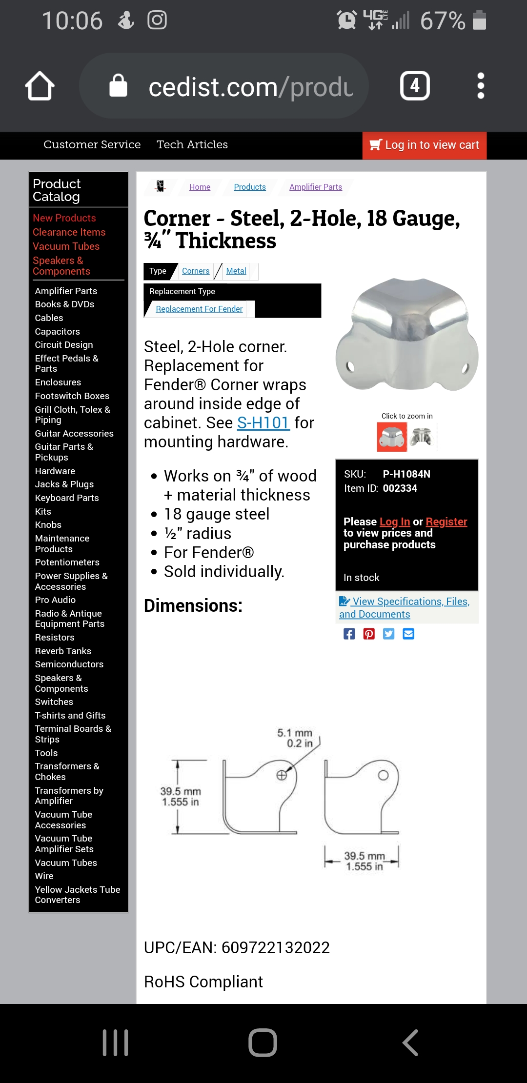

Try these: https://www.cedist.com/products/corner- ... -thickness
These are P-H1084N. They don't have the little piece that hooks back around. I think your picture shows P-H1082N

Thanks for the photo/link. I've not used that site. Always good to bookmark another! :)
Those are pretty much the same thing I have now which don't fit real well. I have the Ernie Ball version of the same part. They seem to be designed so that the wraparound lip (which I would like to have/use) works if the cabinet is made out of 3/4 inch sheets. My cabinet is made out of 1/2 inch and thus there is a wide gap where the lip tucks over the edge.
It is my hope that someone makes a corner very similar to these except that the lip is designed for 1/2 inch boards. These may not exist and I may have to go with something more like P-H1082N on that page. These don't have a lip so they won't stick out and look aweful. But they also may not be as secure on the cabinet.

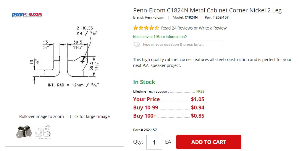

Parts Express carries some 1/2" corners in both black and nickel. I used them on a head cab I made out of 1/2" plywood,
