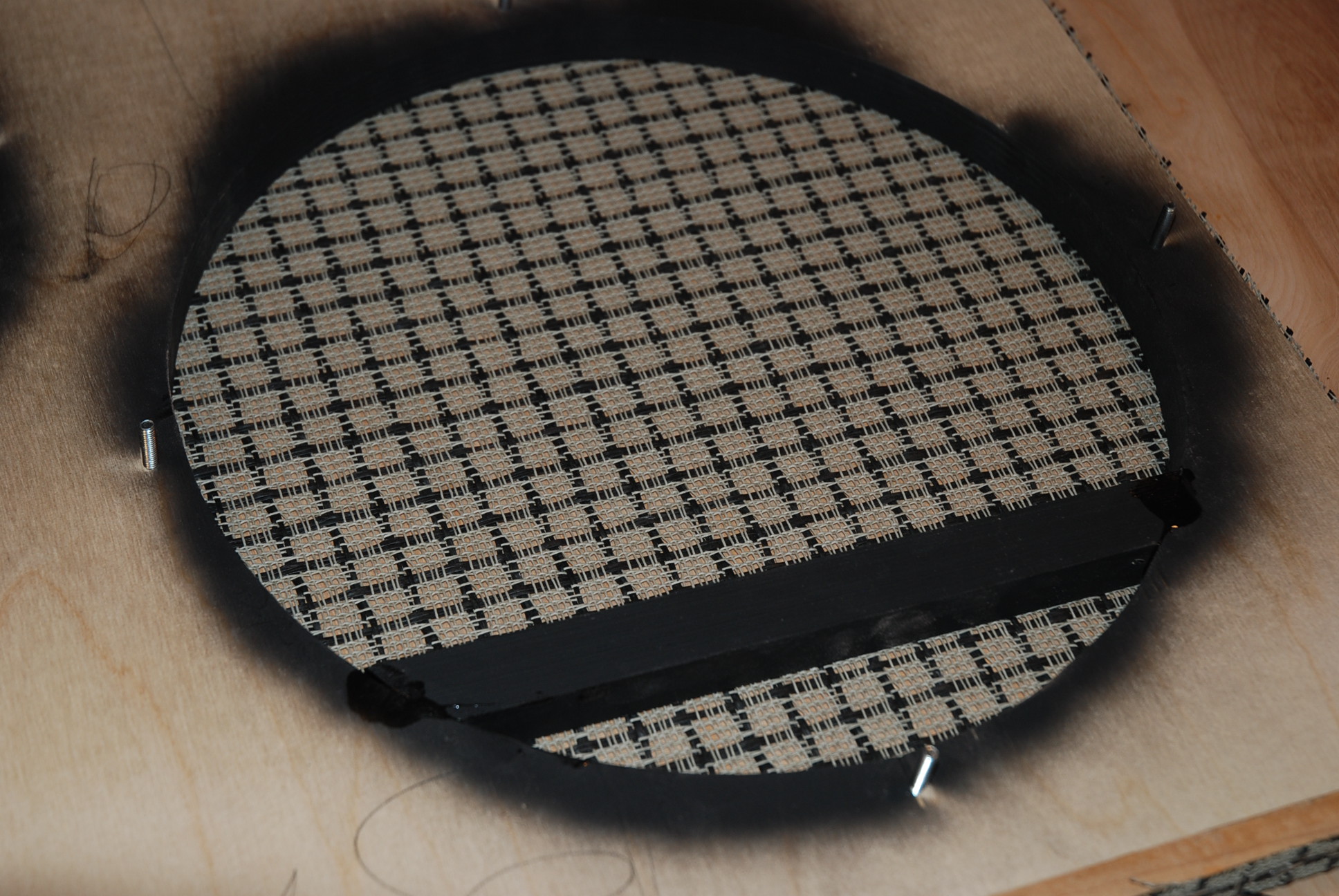

If speaker is rear mounted, grill cloth can go directly against front face. I spray paint my baffle AND t-nuts black so they don't shine like little beacons thru the cloth.

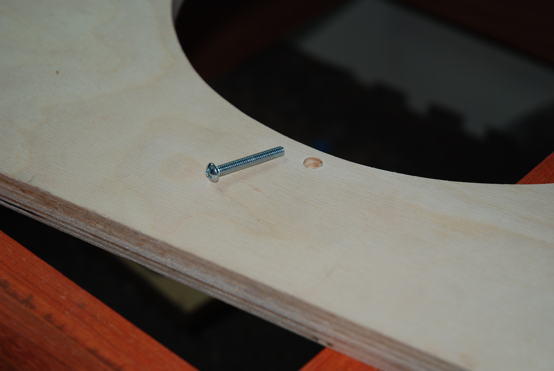

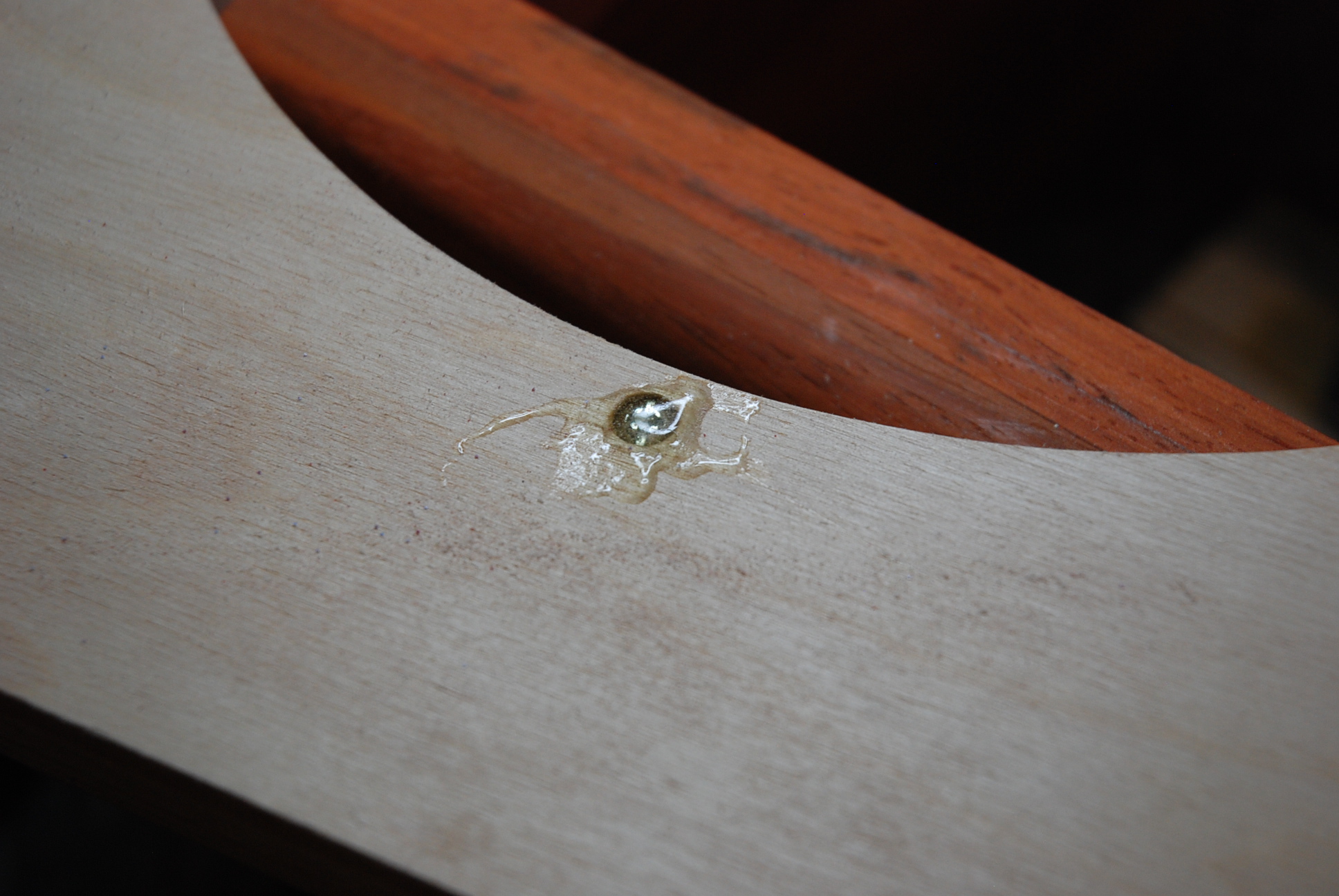

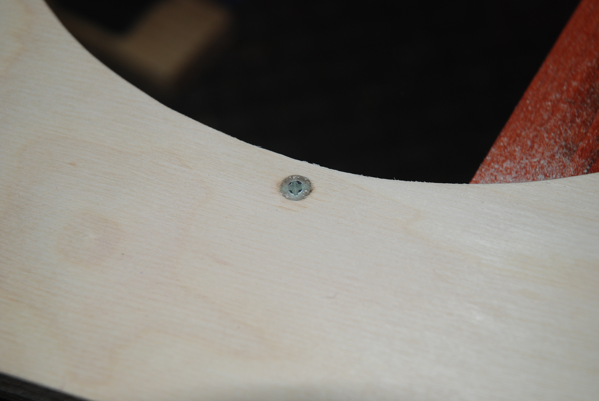

I'm a bit of a weirdo when it comes to speaker rear mounting non cast frame speakers. I drill a tap sized hole for 8-32 screws [so they'll cut 'threads' into the wood when turned in], counter bore to recess the head 1/8" or so and start the screws into the hole until I've got 1/4" left proud of the surface. Mix up some two part epoxy and stuff it into the hole and screw them the screws in snug. Fill remaining hole with epoxy and let cure. Sand flat and spray paint flat black. 20+ cabs so far.
I've not had issues with setting the speaker over the screw studs - I angle the speaker so I only approach on stud and then angle it to line up the next stud.
For EV and similar I use #12 screws as I front load those. Not a fan of T nuts - had some come loose. I've used the threaded brass inserts for chassis mounting in combo cabs - the right sized hole makes it 'easier' to insert and you really want them straight.

You are going to want a frame on the front of your baffle board to raise the cloth away from it. If you put the cloth directly on the baffle, it will rattle and buzz. I made this mistake...once.

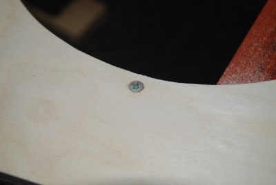

I've got a Dremel. That's not exactly what I'm getting at. In the interest of full embarrassment :oops: I'm talking about when the drilled t-nut hole is nearly open on the edge of the speaker mounting hole. The Dremel won't fix that :oops: but there is nearly always some play in the screw hole on the speaker frame to manage some degree of imperfection on the screw hole location. Recently, I acquired a small drill press through Craig's List. I imagine next time I can do a better job of centering my screw holes on the baffle. Sheesh. I can't believe you got me to admit this.

Phil,

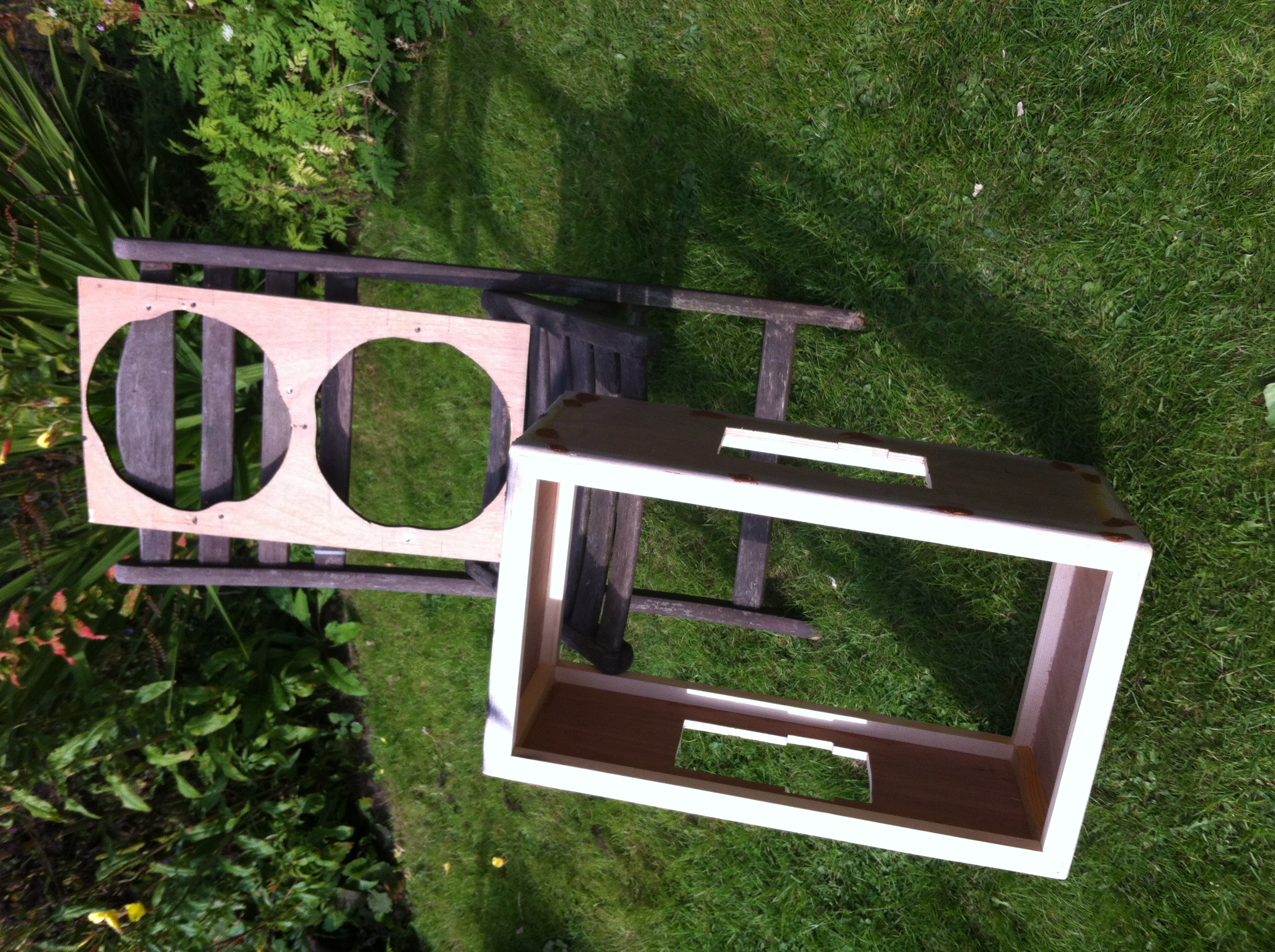

the Baffle speaker cut out doesn't have to be a perfect circle. You can leave extra wood around the areas where the T-Nut will be to stop this.
Have a look at this small 2x12 my friend made as an example.
