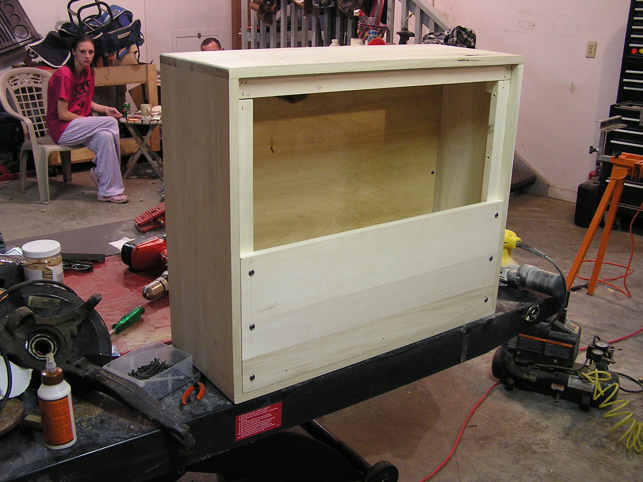

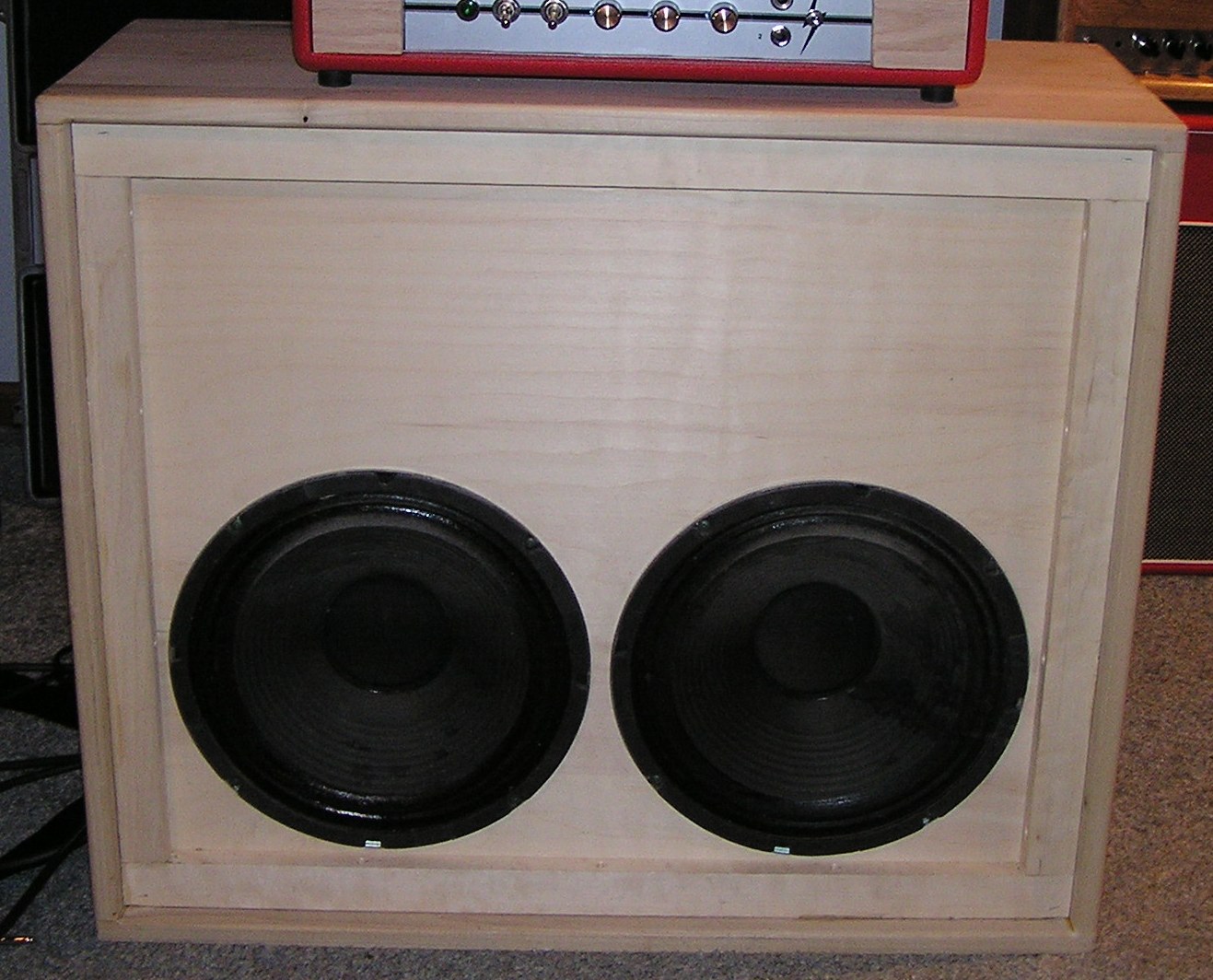

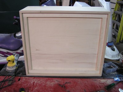

I built a speaker cabinet years ago with Poplar wood which I enjoyed working with rather then pine.
I screwed up on the physical size of the enclosure, meant to house 4x10 " but ended up with 2-10" and maybe one day I will convert to diagonal two 12" if they fit.

M Fowler wrote: Thu Dec 06, 2018 2:06 pm I screwed up on the physical size of the enclosure [...]
10” x three looks feasible, even correct. That way your output transformer secondary will be perfected match—Won’t Get Fooled Again.
