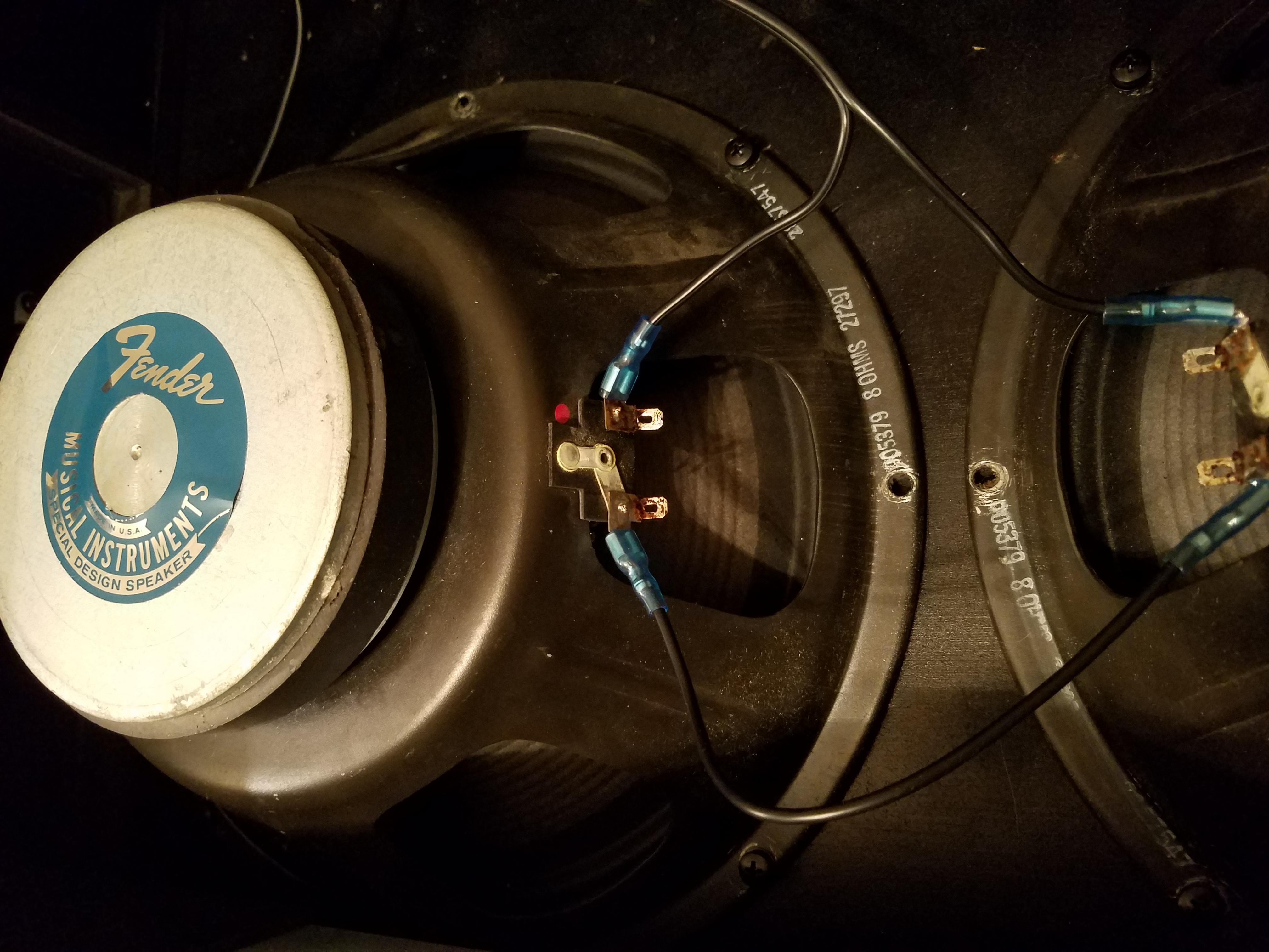

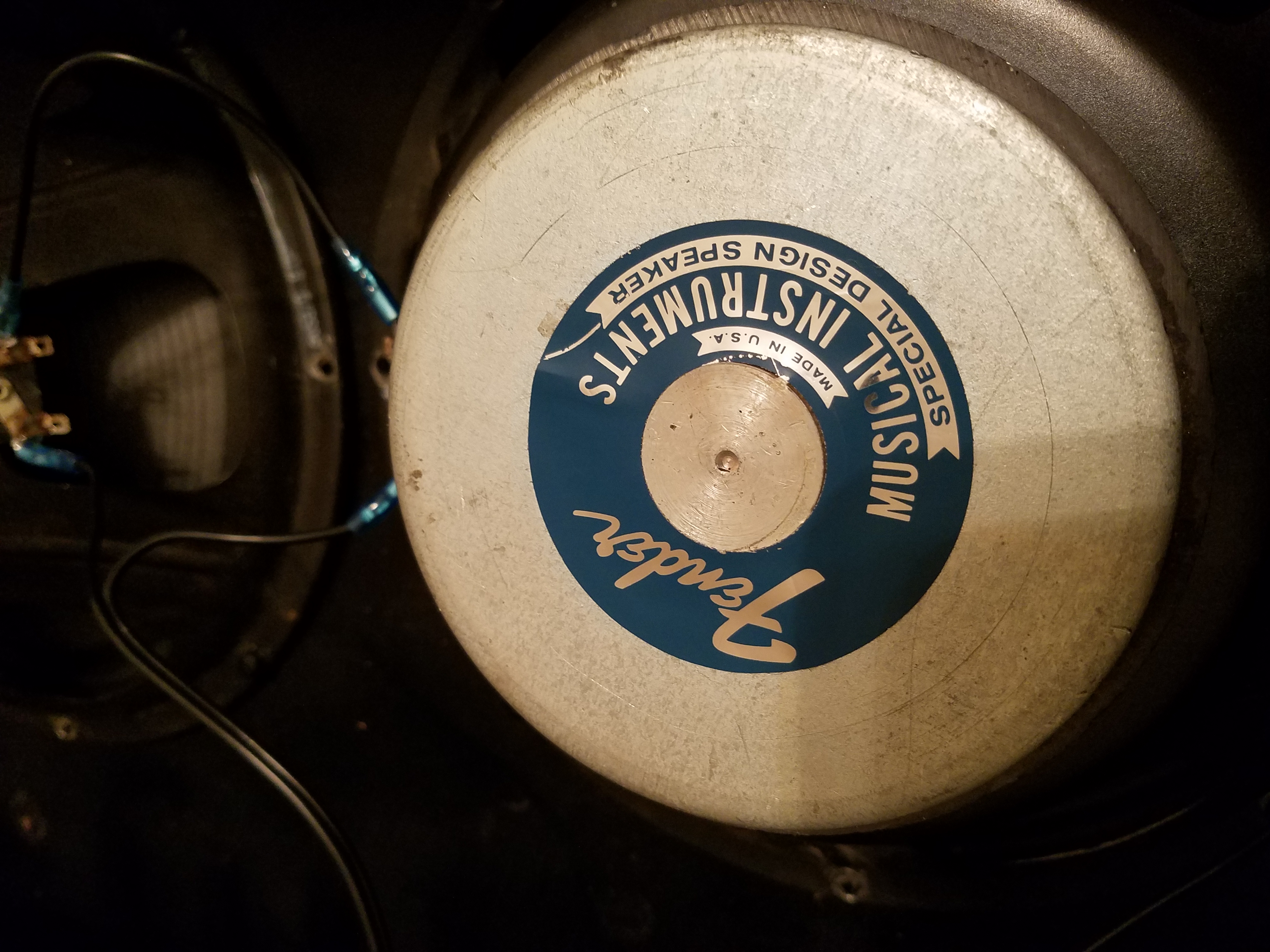

Hello,
I'm usually more of a Celestion kind of guy, but these Fender labeled 12 inch speakers sound good.!
They were in a Fender Bassman blackface era 2x12 cab I bought.
I have them in my Vox AC30 now.
Any idea what I have here..?
My internet search was unconclusive.
Old Fender Speaker Sound and ID

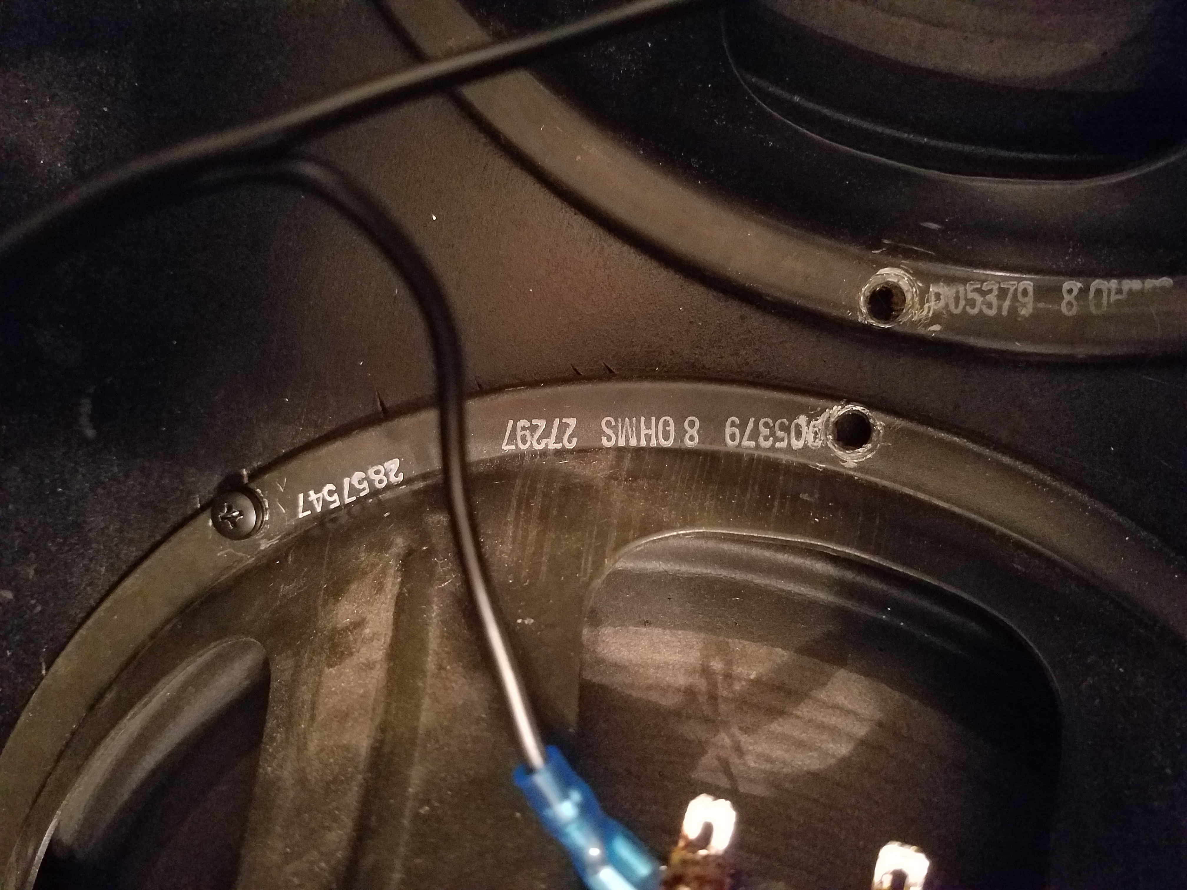

Re: Old Fender Speaker Sound and ID
285 is Rola, manufactured 47th week of 1975.
Thanks Martin, you're the man.
