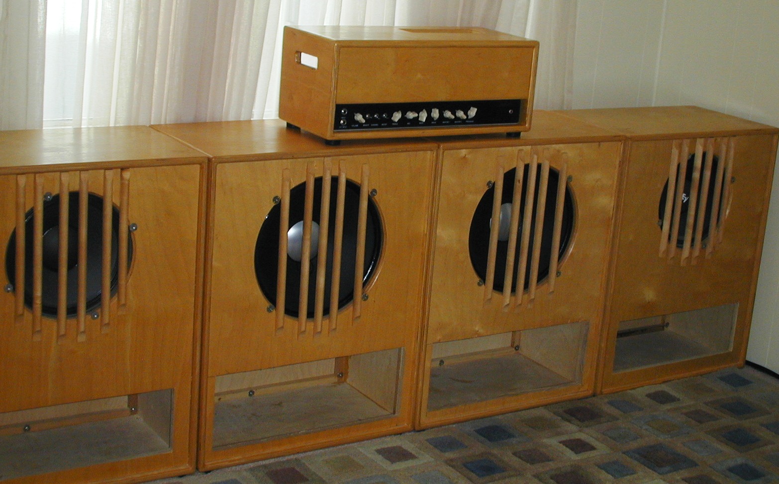

There's no phase cancel issues but on thing I found out after building four detuned cabs was if you make the ports too small you're guitar will sound like a bass and you'll shake the walls, windows, and anything not nailed down in the house.... :shock:

tictac wrote: Tue Jan 30, 2018 9:18 pm There's no phase cancel issues but on thing I found out after building four detuned cabs was if you make the ports too small you're guitar will sound like a bass and you'll shake the walls, windows, and anything not nailed down in the house.... :shock:
Tictac,
Would you mind elaborating on your detuned cabinet dimensions and port sizes a little? I'm quite interested.

Post by tictac »
Sorry don't have the exact dimensions and I don't have these cabinets anymore but if I recall correctly they were around 11.5" to 12" deep. Ther amphead on top was about 23" wide and would sit suggly on the top some I'm thinking they were ~24" wide. Two of the cabs have 15" JBL's and two have 12" EV12L's which may give you an idea of the scale. As you can see the ports are pretty substantial. I built the 15"s first an had to widen the ports. They were shaking the house apart even with the bass control turned all the way down.
On sevreal occasions I used these cabs as a PA system with mics and acoustic guitars and I thought it performed pretty well. The real purpose for this wall of sound was for the SSS type amp I had built. It was like Dave Roots SSS, no reverb. My was stereo however and boy did it sound glorious with the four of these cabs singing away :mrgreen:
Problem was they are SO HEAVY! Baltic birch ply is beautiful but not light weight. I finally let them go on Craigslist and a fellow took all four, (without speakers)
TT

tictac wrote: Wed Jan 31, 2018 12:42 am Image
TT
TT,
Thanks for the report! That looks like a killer setup and I bet it was incredible running in stereo like that. Talk about air and 3D presence :shock: The thing that interests me about the detuned design is the big sound-from-everywhere-at-once response. The massive low end is a plus (although I guess there can be too much of a good thing).
Thanks again.
