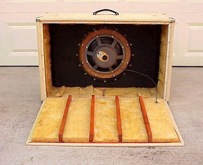

or, 2 stripe of solid wood on the back pannel each side of speaker magnet + isolating Wool, exemple:onpen cab picture

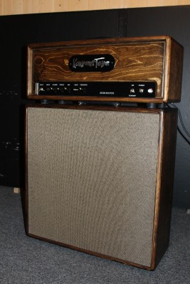

other pictire is my cab.

I use 3/4" BB style plywood for baffle and backs and haven't run into resonance issues yet but I play guitar. If you plan to brace I'd look at multi axis style bracing like an X pattern or a fan pattern. The pic of bracing you show only controls one direction of flex and might not completely solve this issue.

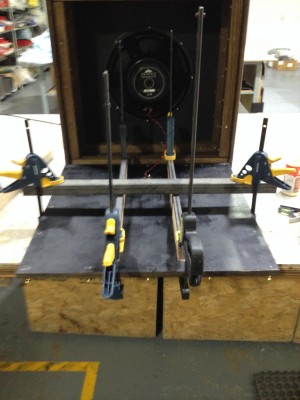

I modify the back pannle bu adding 2 brich wood pieces
not test for now , but it might helpfor the FK ripple
