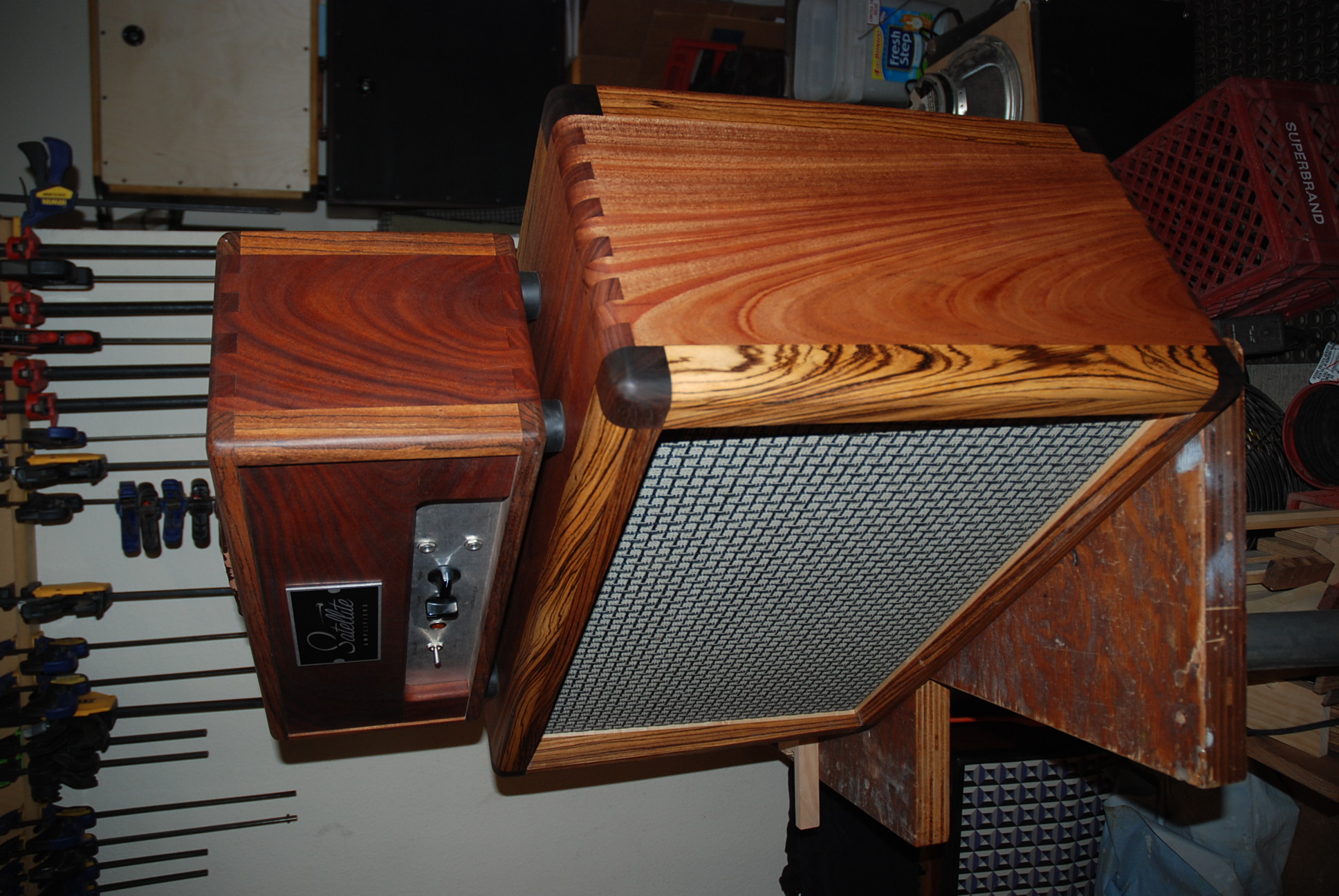

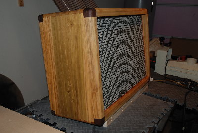

Look at poplar or African mahogany - I've built several cabs with these and they turn out and sound awesome - plus they look great oiled.
BTW I box jointed a 2x12 cube with pine as an experiement - the corner geometry requires a separate block for the corner to make it work. 110 joints cut for the roughly 20" cube - NEVER again!
Finger [box] joints require consistency to fit well - or a lot of wood slivers and epoxy! I started measuring each cut as I go to catch drift.
