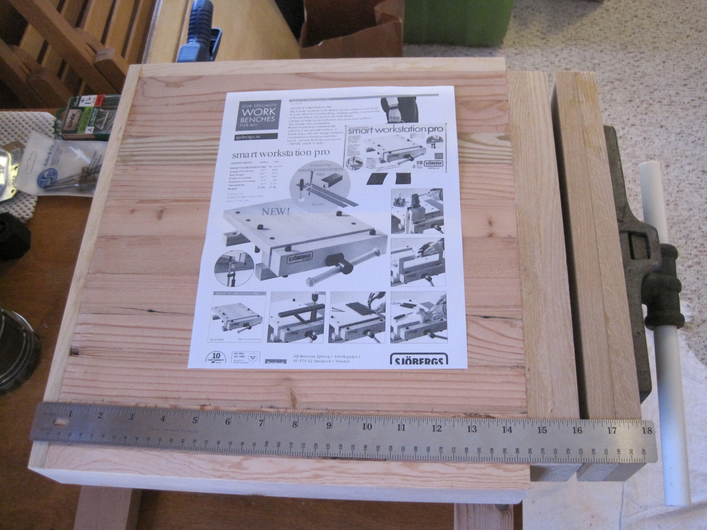

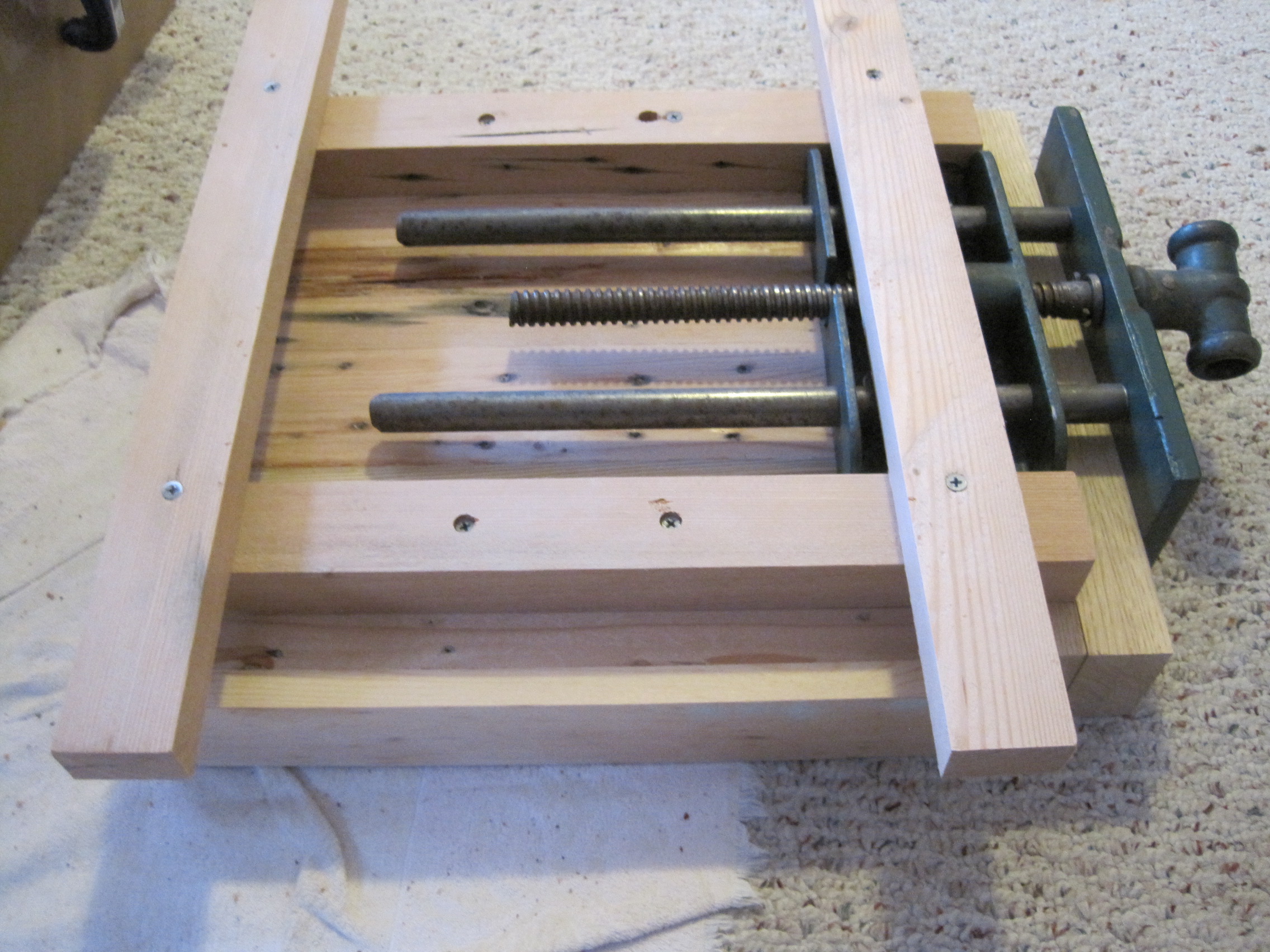

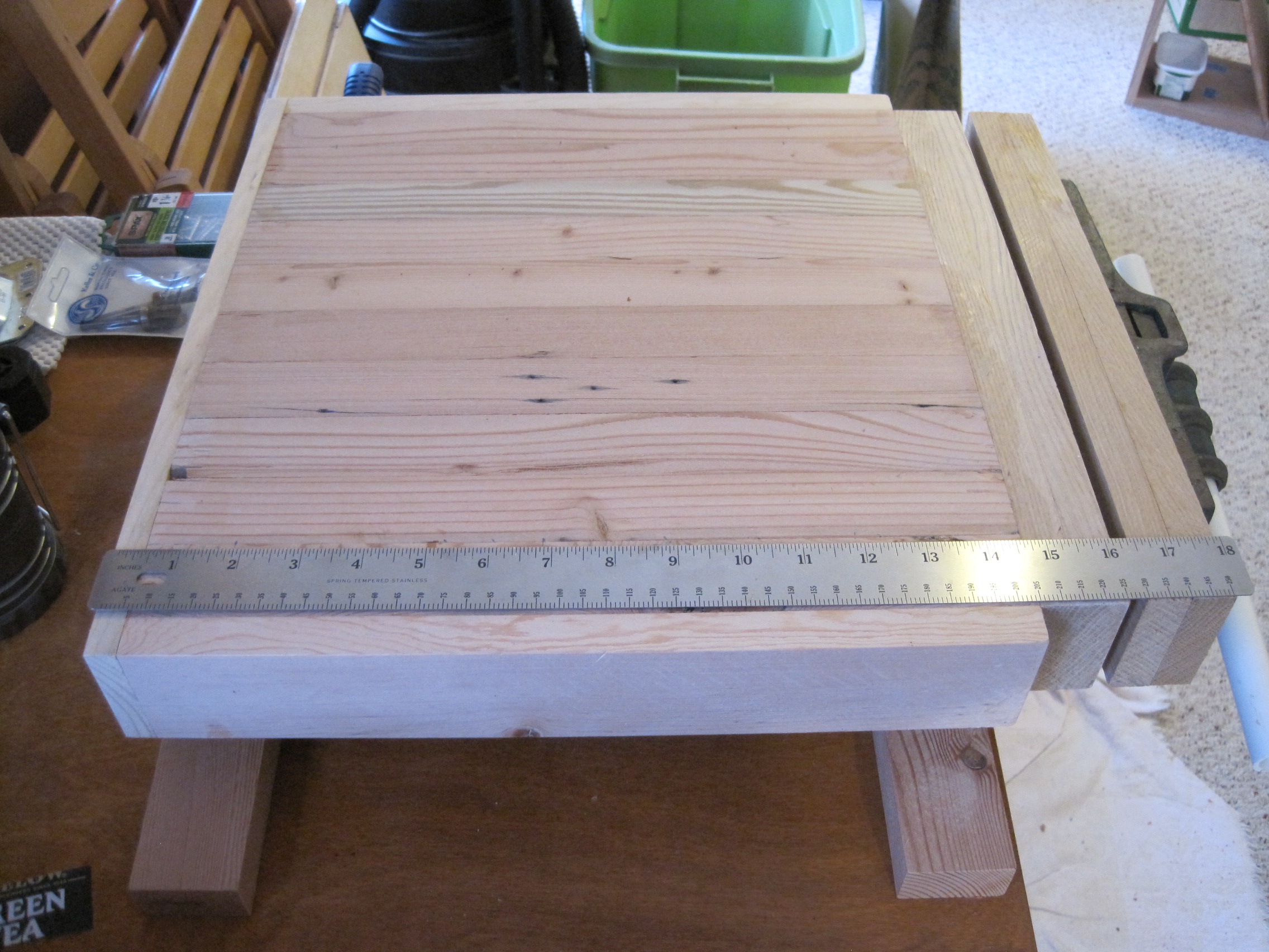

One thing that makes any sort of woodworking much easier is a good bench vise. Sure, there are viseless methods of working wood, but they are not portable. My problem, as I've mentioned before, is that there is no dirty room in my house where I can make all the sawdust I want. This means I'm limited to my outdoor workbench and that's fine with me. However, there's no keeping a vise on that bench because the weather is going to ruin it.
About a month or so ago, I came across the Sjobergs portable workstation. I almost bought it and then I thought, I've got everything I need. This project was built almost entirely of scrap 50+ year old Douglass Fir that came out of my roof in the tree incident a few years ago. The vise was free, removed from my mother-in-law's house when she moved about 18 months ago. The vise jaws are made from an unfinished white oak stair riser, part of the recent purchase from Lumber Liquidators, see my other post on that find.
The only thing left to do is drill holes for the bench dogs. I'm not quite sure where to place them and the best way to drill them. My current thinking is similar to the Sjobers item. I don't know the exact placement on that, but I am looking at two rows about 11" apart. In addition to the two dogs in the vise jaw, I think that 2 rows of 3 dog holes in the work top will be more than enough. The vise screw gives me almost 10" of extension, though it seems I don't really want to open it more than 5-6" because it makes for a lot of outboard weight as the metal jaw plate is quite heavy. Also, it sags after opening too much. I believe I can compensate for the sag by placing some sort of guide on the underside for the screw. Details, details...

Great job! My hat is off to the 'outside the box / make my own' thinking.
Do you plan to drill holes for bench dogs? They increase the 'reach' of the vise to the width of the working minus a couple of inches.

Hi Russ!
I'm glad you like it and thank you for your encouraging words. The beast weighs in at 32 pounds! It still qualifies as portable, though, and it is actually fairly petite, so it can be stored away. I made a handle from a 7/8" dowel. That's the only thing I had to purchase for it.
Yes, I'll be drilling for bench dogs. 2 in the outer vise jaw, and 3 pair of holes in the "table." My present issues are these: 1) I want to figure out how to drill the holes as plumb as possible to the top and I don't have a drill press, and 2) my 3/4" bit for the dogs needs sharpening.
It seems a diamond file or similar is needed to sharpen a bit. I may have to build yet another jig so I can do a proper job of sharpening. (Rationale: I need one of these anyway says the devil on the left shoulder.) I saw some interesting stuff on youtube about this and it happens I just pulled a low power motor (from a piece of junk) that has a plastic wheel that I think will take 5" sanding discs. It should be more than adequate for light duty sharpening. I have to hook it up to assess the possibilities. I think I've also got an exhaust fan motor somewhere that I've never used.
