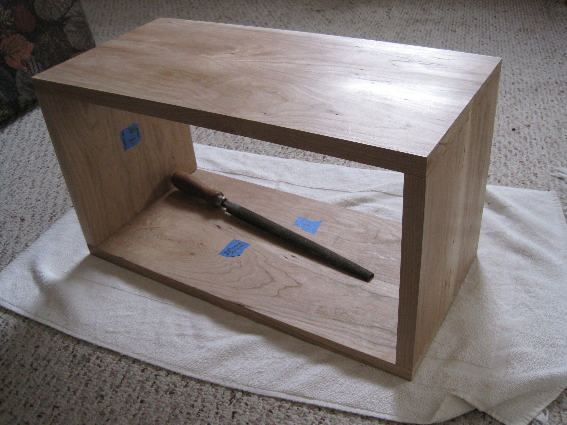

I'm pleased to report that I am past the "joining boards" stage. Thank you to everyone for advice, helpful hints, and encouragement. It's been a long journey, with many, many test cuts, experiments, etc. It takes practice to ramp up manual skills and to understand some of the not-so-obvious or even the obtuse (Porter Cable half blind dovetail jig.)

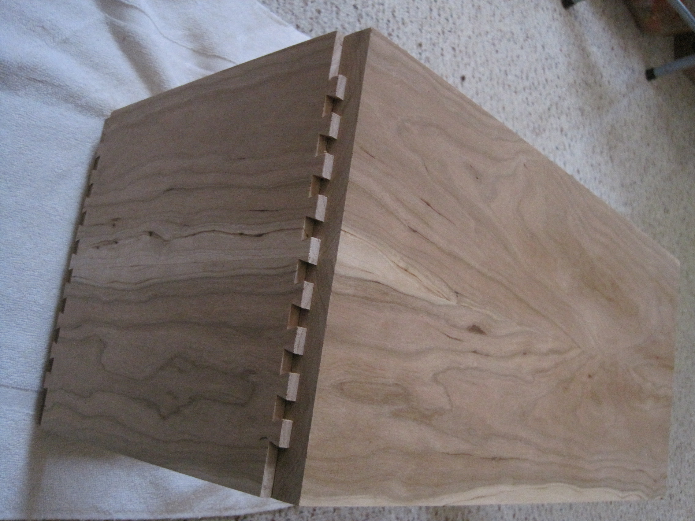

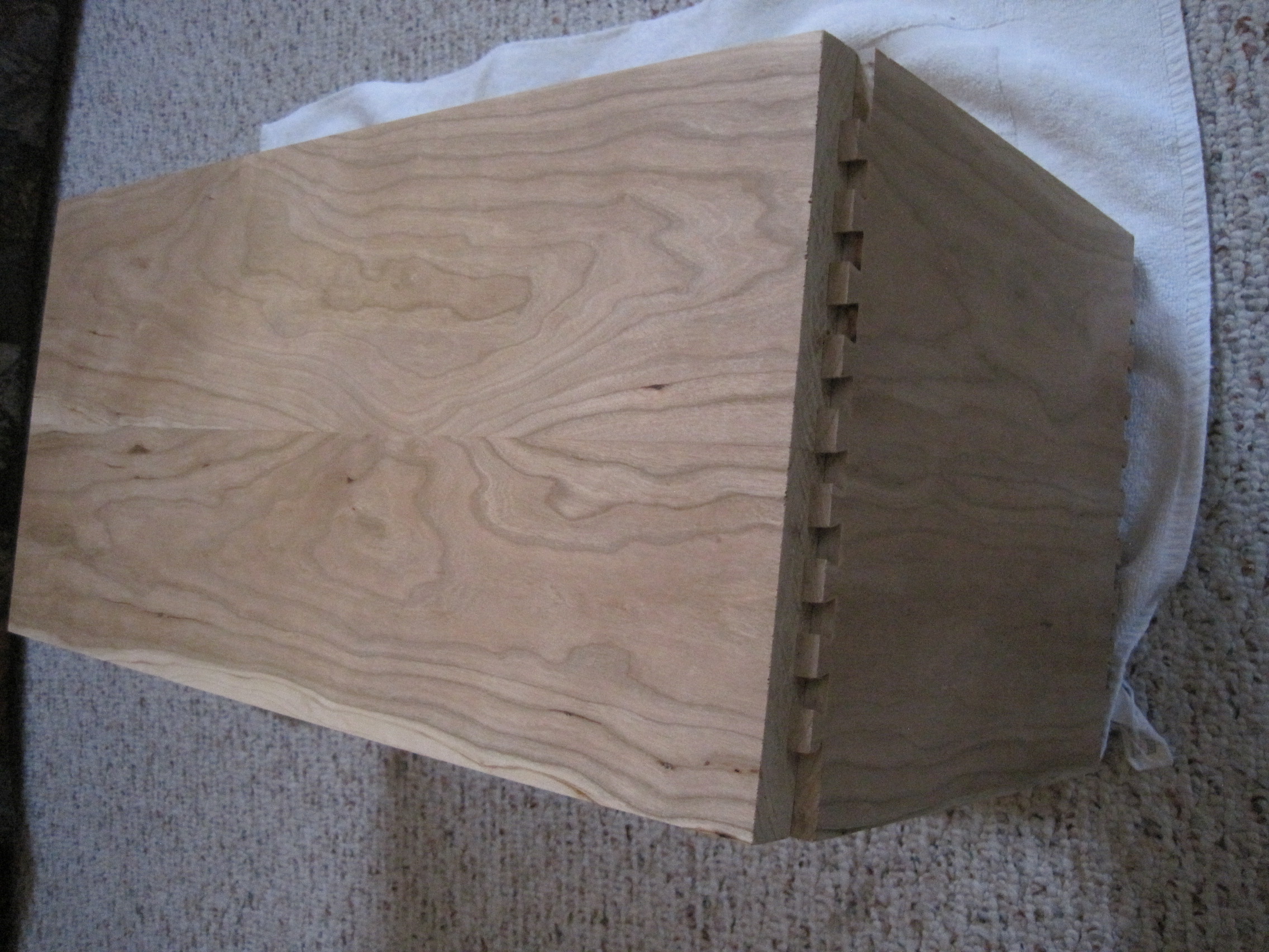

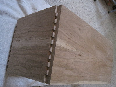

I finally got a good set of 3 small drawers from the PC jig. From that, I finally got the hang of how the corners work. Because the width of my boards was wrong for the spacing on that jig, following the instructions was never going to work -- opposite corners were going to half pin or half tail and that just wouldn't do. I wanted symmetrical corners that keep the joint blind from the front/back. Imagine, the nerve of me, to disregard the instruction book! I moved the left hand guide over a bit to make the "drawer side" (in a head cab, this is the short board) symmetrical to the cutting template. I cut off the last pin with a saw, resulting in a long one at the corner.
The pins and tails need a bit too much persuasion with the mallet. I will have to work on them with some sandpaper to ease fit. For a first time around, it's not too bad. There was some minor chip out that I'll have to work on, but that doesn't bother me any.
The top and sides are cut from one continuous board, side-top-side, so I think I managed to match them at the corners. The bottom is not as nice looking and not worth showing, IMO.

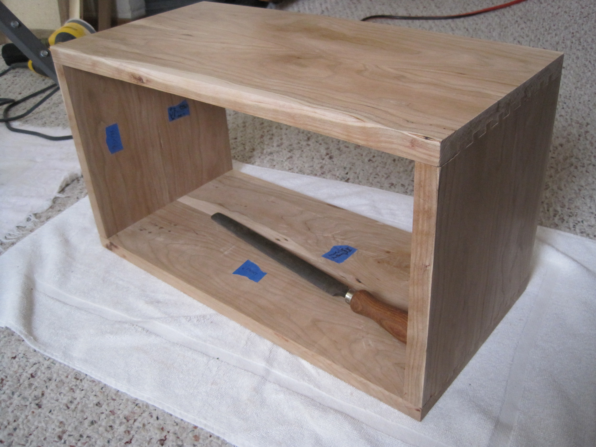

Ok then (seem to be talking to myself <shrug> that's OK). I found the proper persuader -- a big double cut file to reduce the size of the pins. This one gets into the grooves.

The alignment issue is caused by jig movement or cutter movement between cuts. I find its a lot of paying attention to the jib and cutting tool. Not something I can do whilst distracted. Which brings you to the 'art' part of the woodworking - artfully fixing the oh craps!

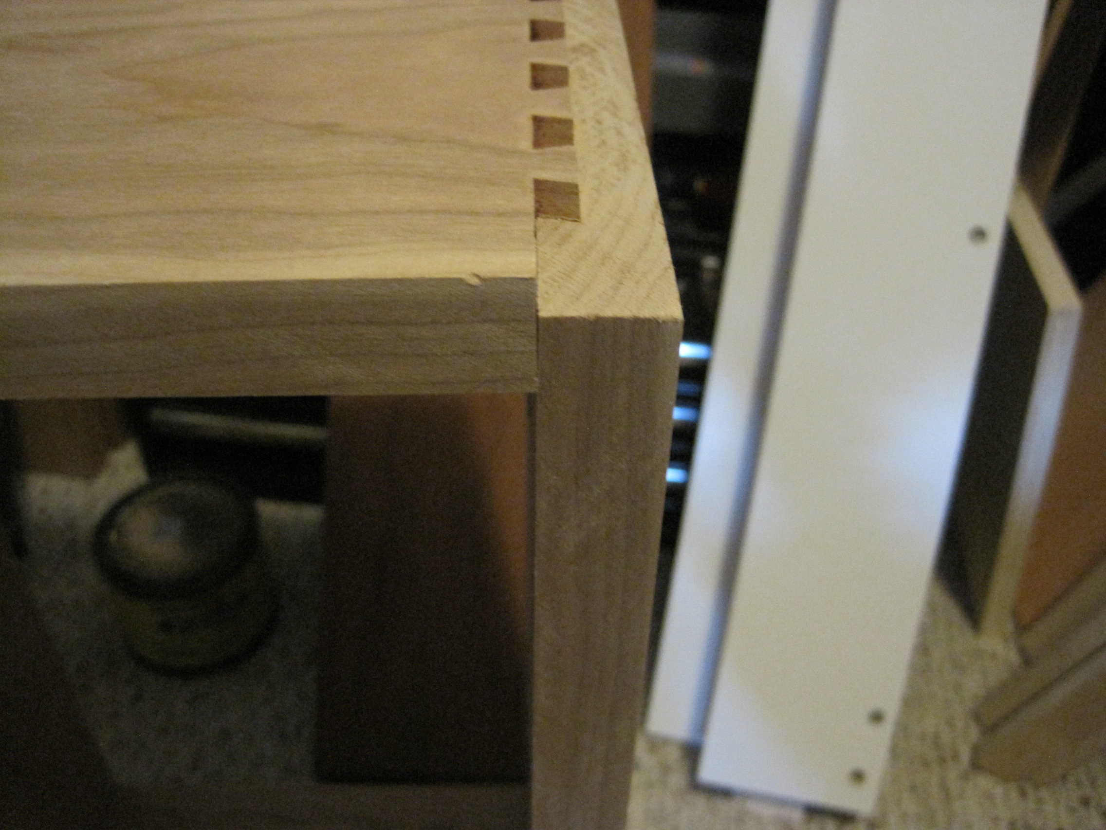

Well, on the PC half blind jig, the directions say, if too tight, the cut is too deep. I figured, it would be so shallow, it would be silly, so I cut them too tight and used the persuader. Also, I did a bad job on the wide shoulder at one corner -- you can see daylight, more than I'd like. Thanks for the kind words. I'm pretty happy with it so far.
