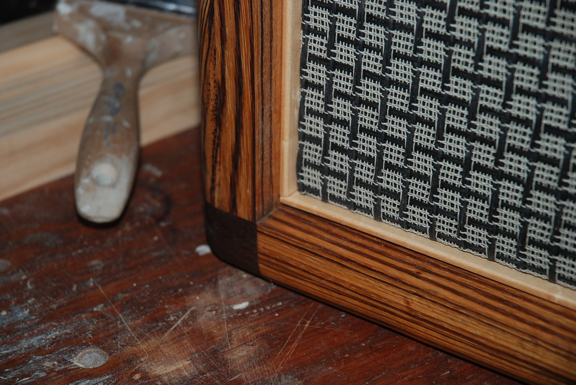

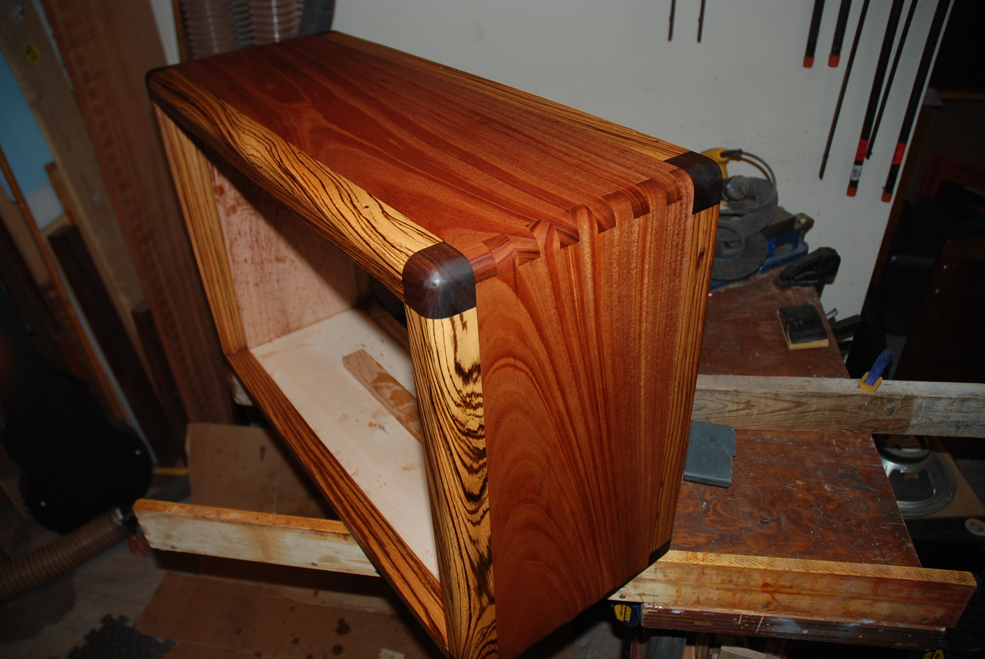

I have an African Mahogany & zebra wood on a Satellite Barracuda and just HAD to HAVE a matching cab. Doesn't hurt that I want to take it to this coming weekend's guitar show in Arlington.

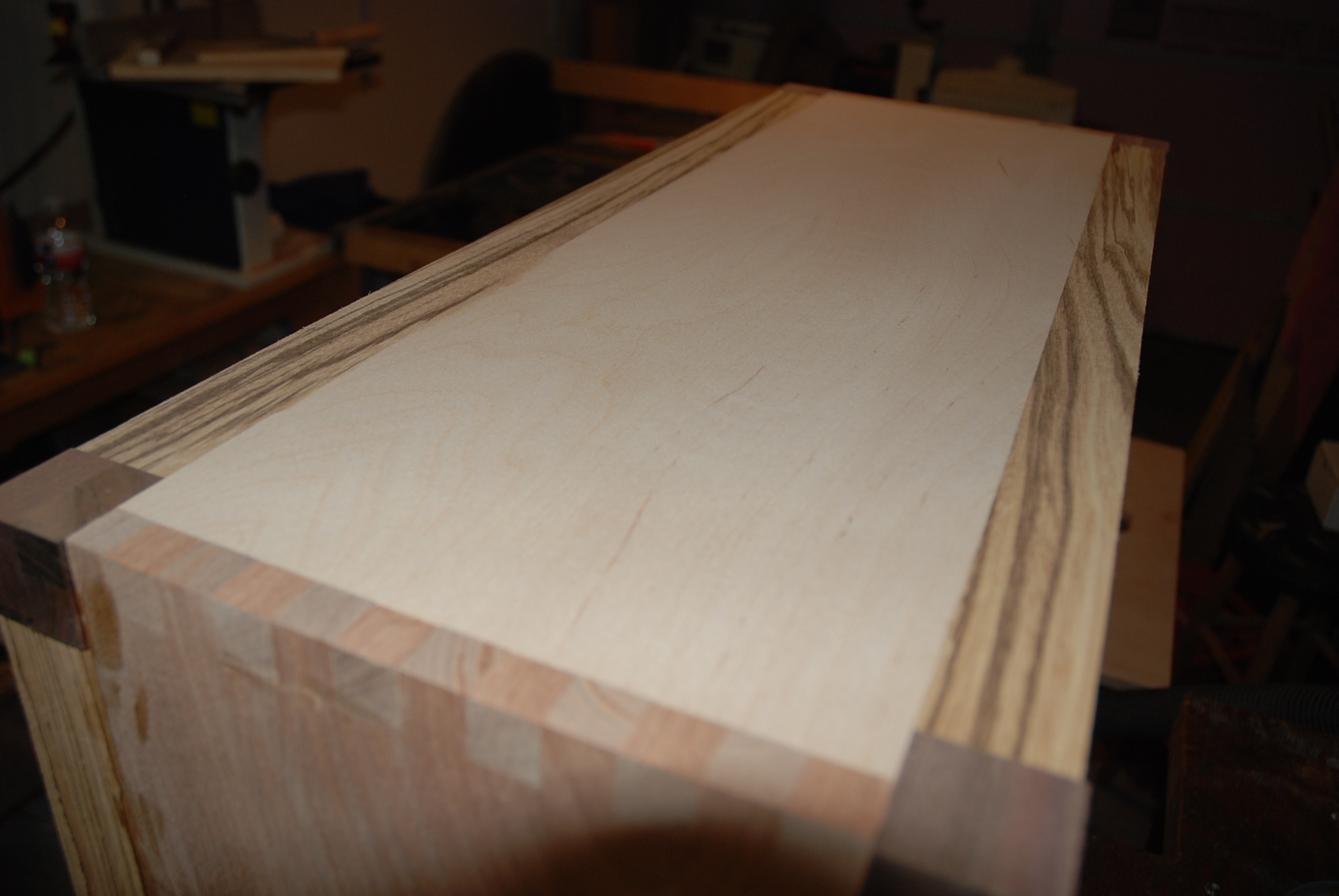

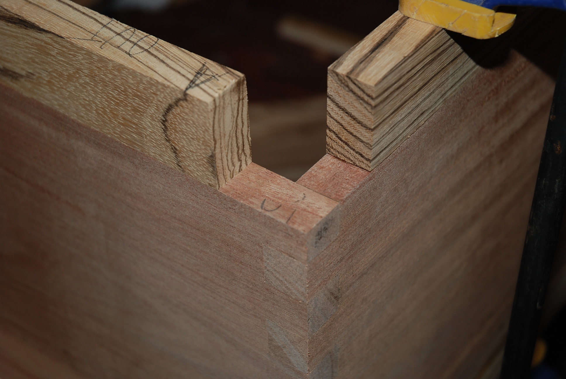

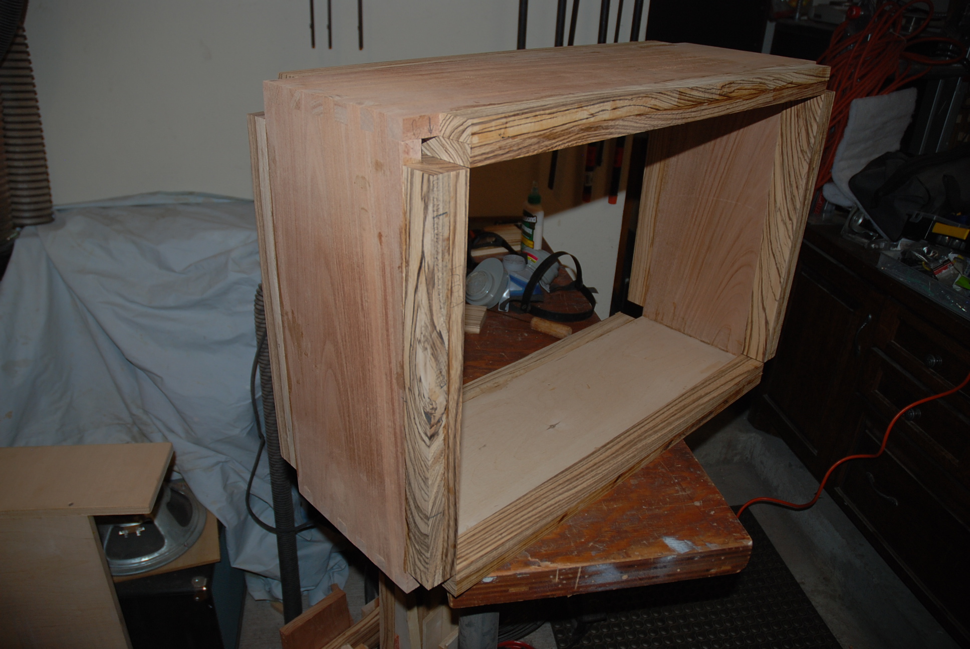

Usual finger joints - had an interestingly frustrating development as my Freud carbide dado started to cut .010" deeper on the second chipper - DOH! It was my arbor so the so so fix is to tighten the set down - test cut. If its not flat loosen and retighten. Rinse and repeat as necessary.

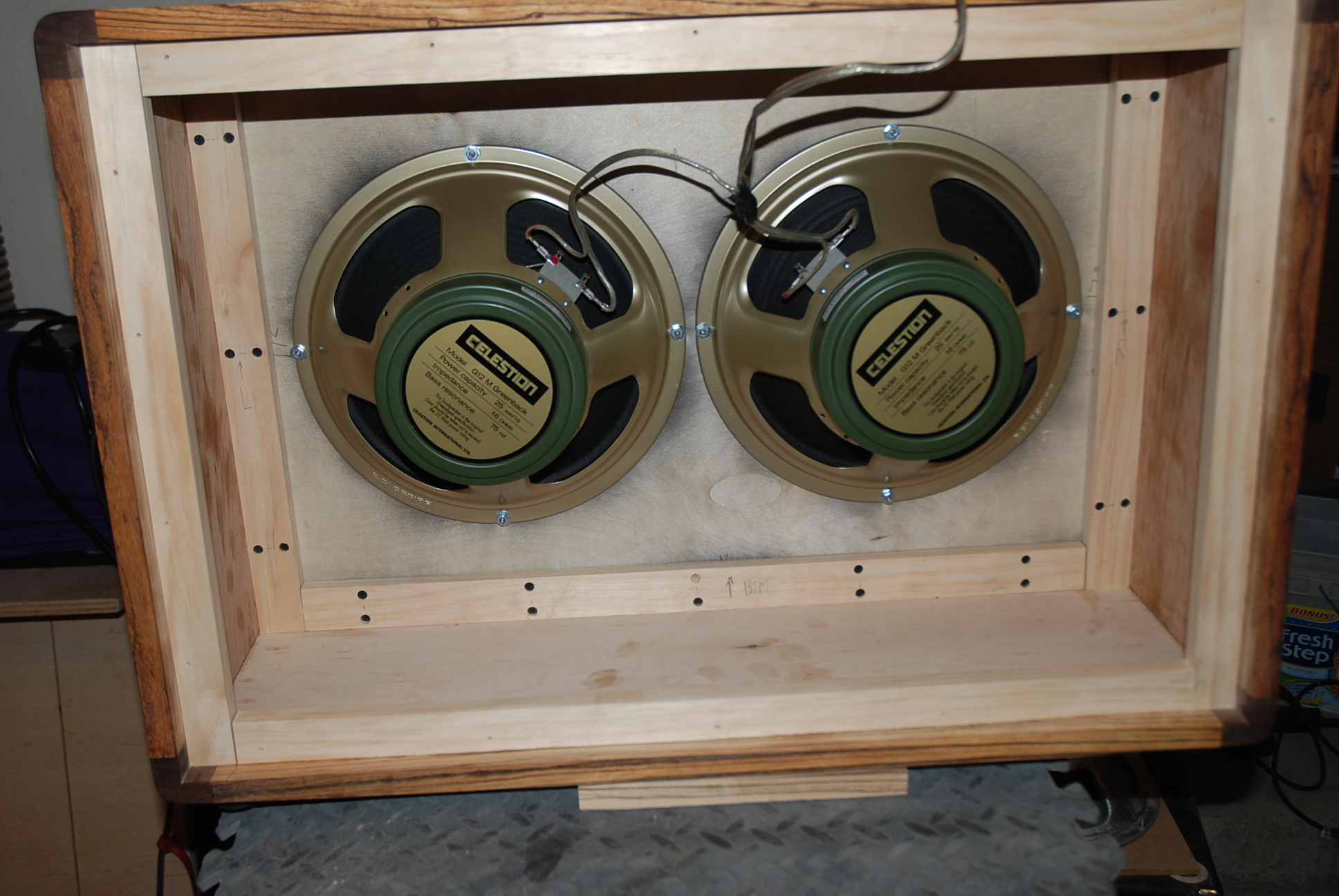

Pics of the lonely amp, the bottom of the cab as I don't show that very often and various stages of the build ending with the first slurry sand.

I'm starting to understand this a lot better, particularly how you do the corners. Sorry to hear about the .01" problem. It still looks great, as usual.

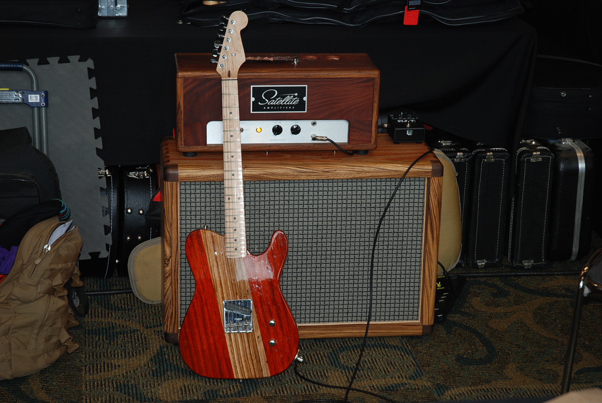

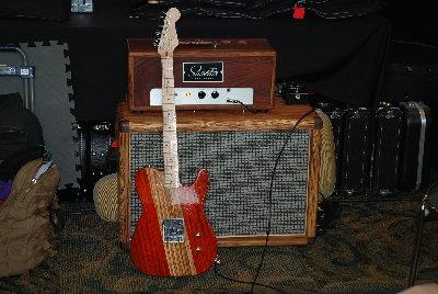

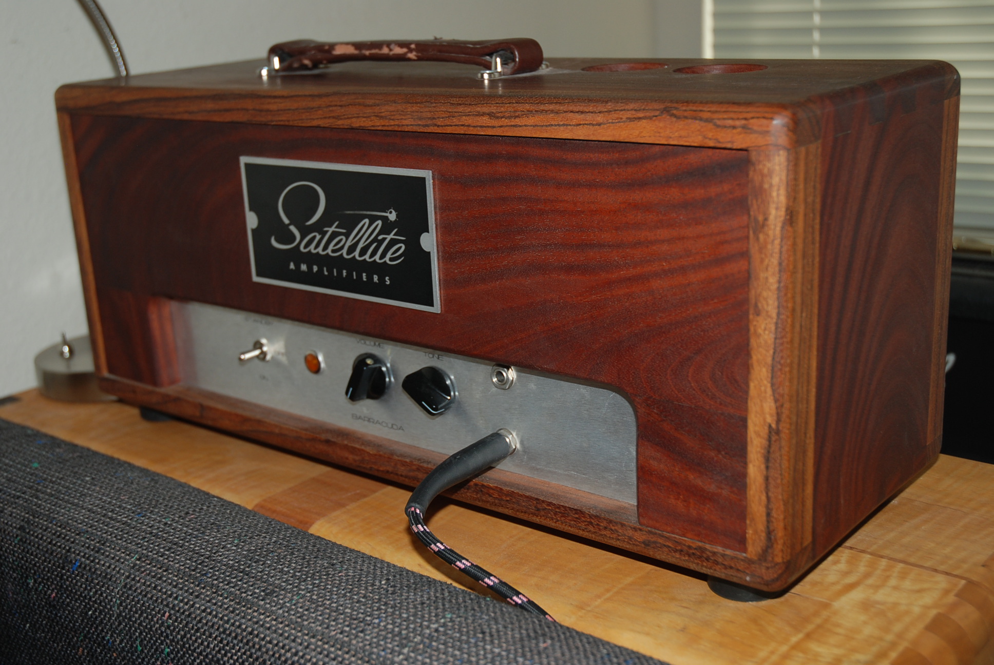

Some finished pics.
This rig was at the Arlington TX Guitar show in the Guys Building Guitars booth 7010 Friday and Saturday. I got lots of compliments on the look and several offers to buy it. Same answer for all - get your own - www.satelliteamps.com This amp is mine.
BTW the guitar was a charity build [we do them every year] left over because I didn't get it done in time for last year. Sold it yesterday - God bless you to the buyer - and the proceeds will go to the Russ Martin Listeners Foundation www.facebook.com/search/top/?q=russ%20m ... foundation that supports the families of fallen first responders. That fund got tapped out earlier this year and we want to 'pump it up'. We are building an archtop guitar to auction off and 100% goes to the RMLF.
On the guitar below www.allparts.com donated the neck, one of our members cut the tele body from cedar and I drop topped the padauk & zebra wood. My first and only automotive clear finish - oh what a pain with cedar. The rest of the parts from the toy box.
