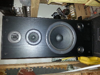

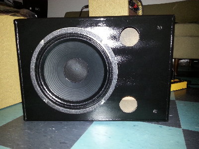

Thought I would share a little project I did on the weekend.
I picked up a cheap tower cabinet on kijiji for $40 and chopped it in half and then put the top back on it. Sprayed it with 5 coats of black paint and loaded it with a Celestion G1265. This speaker sounds amazing with my #124 dumble clone. I love the way the closed back cab makes the reverb sound deep and cavernous!
I turned it around on all sides and it sounded best laying down in this fashion.
The dimensions are 21 W x 15 H x 10 D
Pics below, before and after.

Cool!
Great low cost mod. :D
