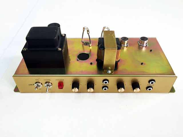

Another question, would it be possible to mount the amp inside a combo cab using it's current chassis? The one ive used was intended to go in a head, so the tubes are on top, and im not sure if that would be alright or not.
Not really
Ron Worley
Posts: 908
Joined: Mon Dec 24, 2007 8:21 pm
Location: Keller, TX
Re: 2061x combo cab
Post by Ron Worley »
Make a custom faceplate and use it upside down.
Ron
Re: 2061x combo cab
You can probably flip that faceplate over and use the other side.

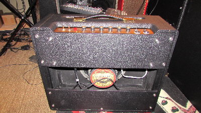

Re: 2061x combo cab
No you keep the amp as is and mount it to the back board like a Marshall JTM45.
Ron Worley
Posts: 908
Re: 2061x combo cab
I own a JMP combo just like this.... Why did I not think of that?
