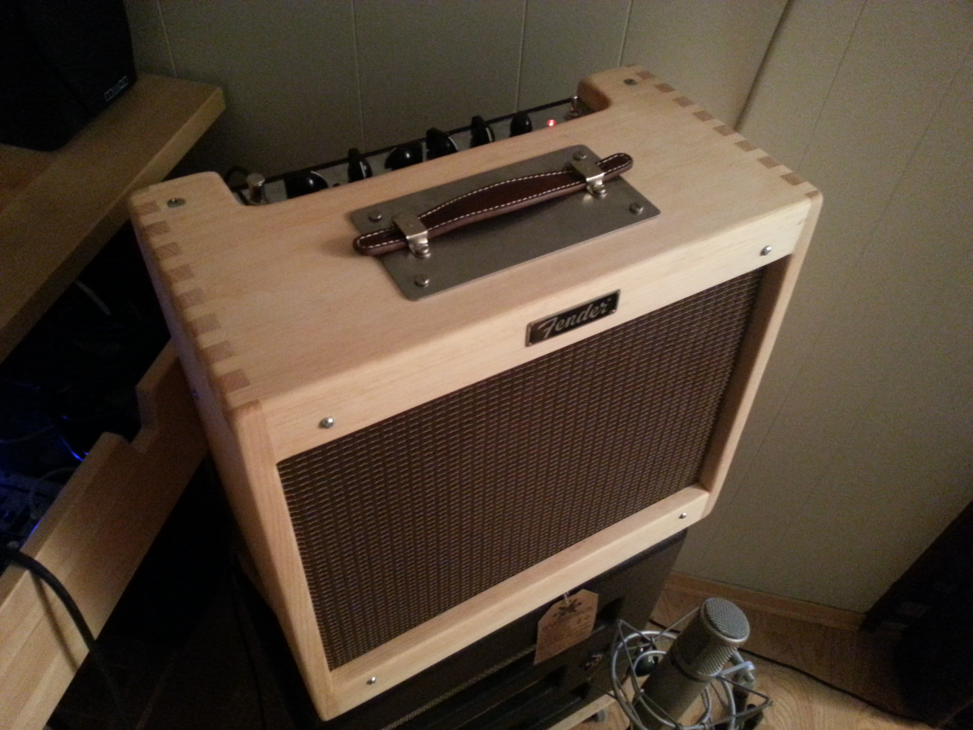

Hi. First post just to get your thoughts on my wooden Jr. cab.

Beautiful! Some very fine dovetailing going on there.

I like your cab a lot and don't mind the top handle plate either. :)
Re: Wooden cab - Blues Jr
Very clean and straight. No glue spotting.

Glue? Thanks for the nice replies. Although I havent milled the finger joints, I have adjusted, assembled, sanded and oiled the cab. The top handle stailess steel plate I got cut out from some leftovers at a local metal-working shop - did cost me one USD. Had to be rounded and grinded. The premilled parts were made by Carls Custom Guitars in Lowel, MA, and yes - I did use glue :D
The Jr was in a sorry state when I got it. I gave it a filter re-cap, soldered the reverb-tank, did some minor EQ mods inspired by Bill, a new set of JJ's and a new input jack. Have a Jensen P12Q (60's) incoming wich I hope will sound fine :D

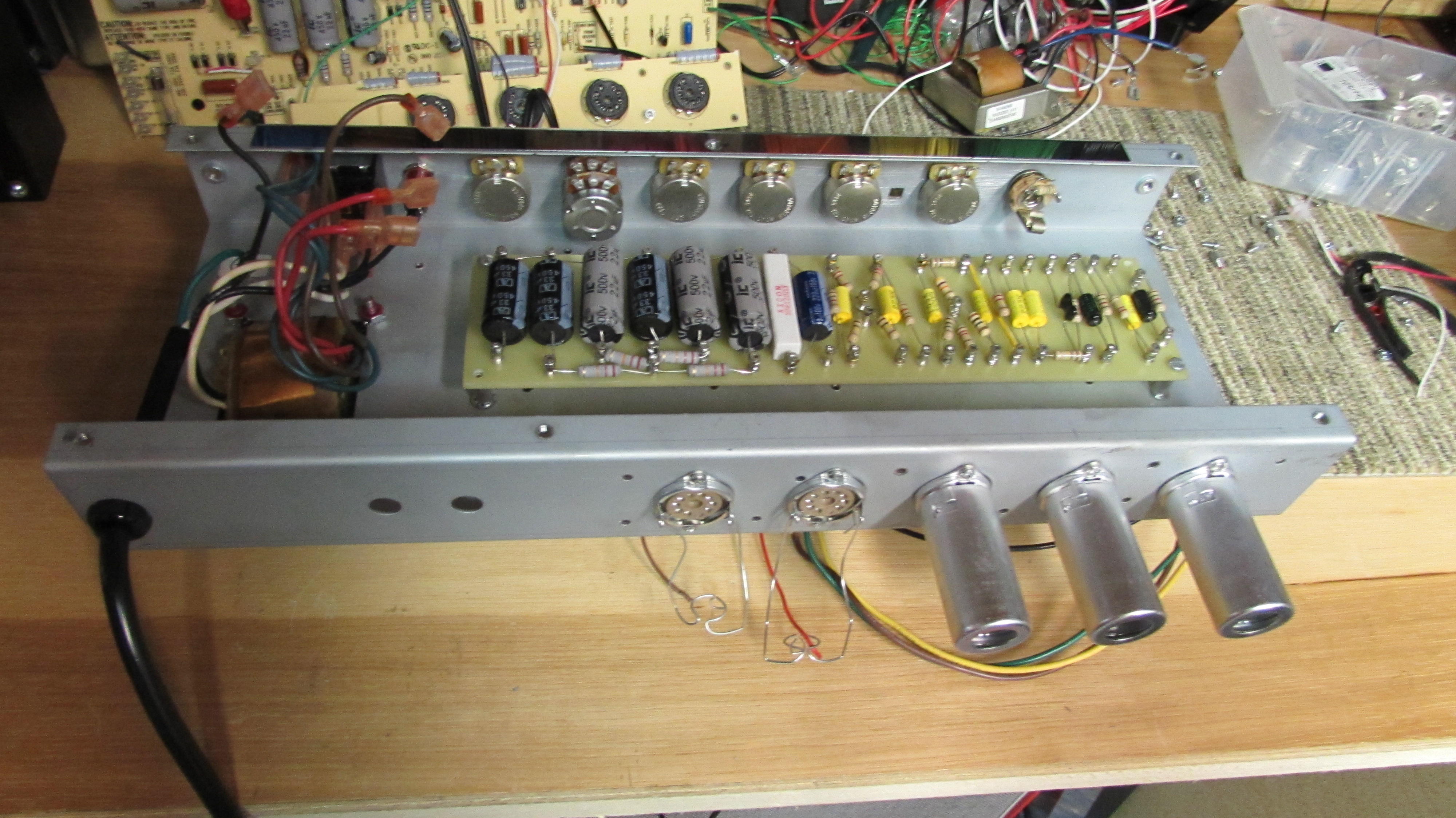

I'm in the middle of gutting and making a new amp out of a local guy's Blues Jr he kept having to pay big dollars for repairs then the OT and EL84's blew so we decided to gut it. :)

Nice Jr. refit! :D
Mark, those chassis always remind me of steel studs like are used in construction.
A guy could get a lot of chassis out of a 10 ft beam. :wink:

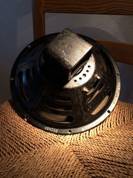

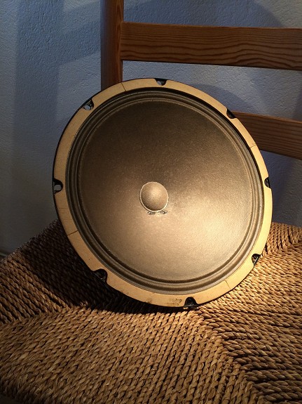

Thanks ! So the 1963 Jensen P12Q is inhouse and tested. Excellent sound but breaks up all to early. Would probably be ideal for a singelended class A.
Weber supplies 40W recones for this speaker, but what then is left of this speakers characteristics? Hmm..
