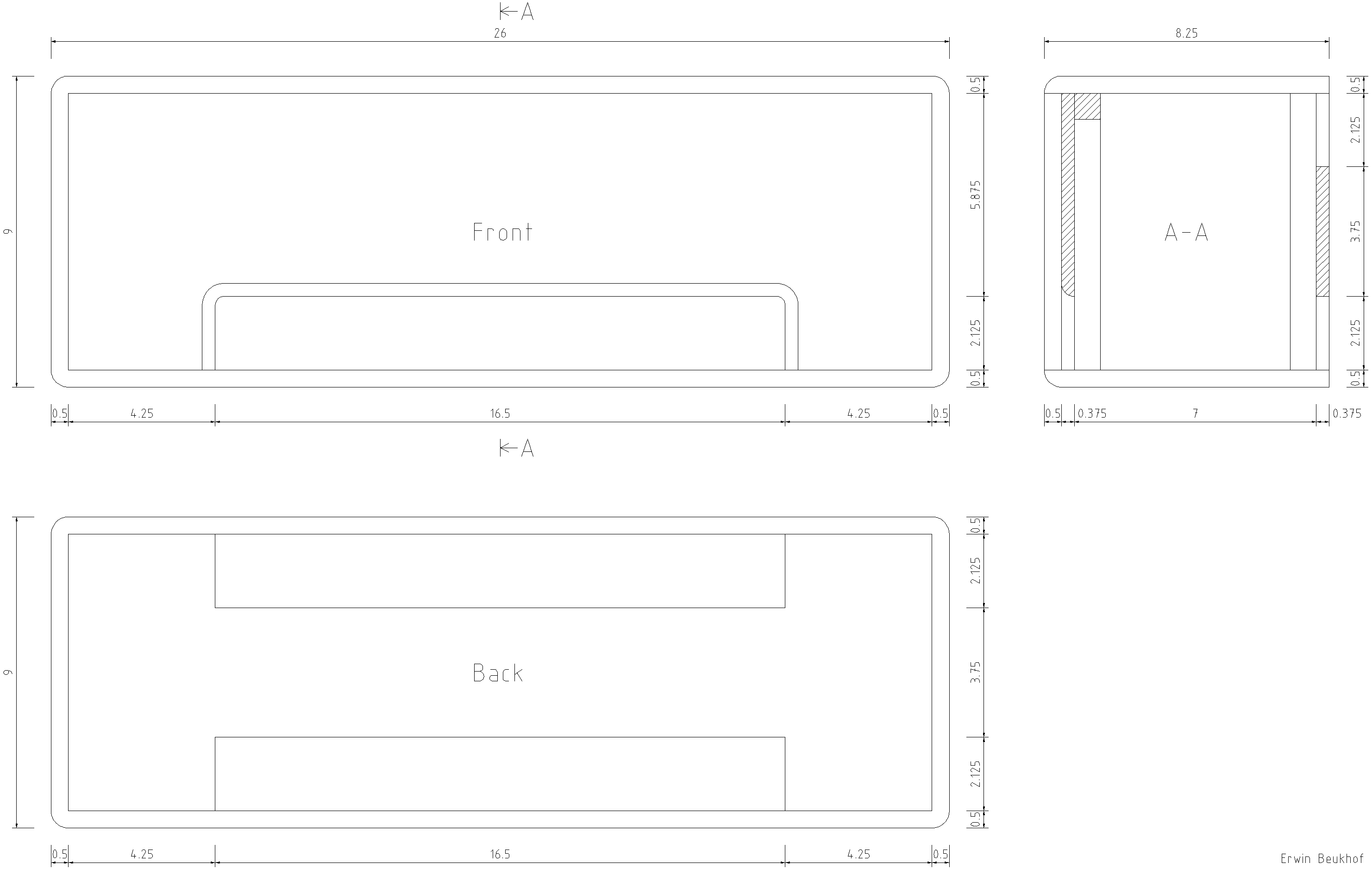

I have these plans although not for Marshall but similar that you can adapt.
head_cabinet_511.pdf
(34.27 KiB) Downloaded 556 times
Re: Marshall head cab plans?
Only have small box drawing and 2205 open bottom style.
2205HeadBoxBB.pdf
(21.46 KiB) Downloaded 270 times

I have a cab I could measure...
29 1/8" wide
10 5/8" high
8 3/8" deep
1/2" plywood
Control Panel opening is 16 1/2" x 2 1/4"
String trim is located 2" for the outer edges
I'm thinking the wood actually measures 1/8" less, with the tolex accounting for the additional 1/8" (i.e. 29" x 10 1/2" x 8 1/4").
Let me know if you need me to take any additional measurements.
