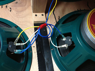

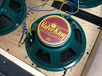

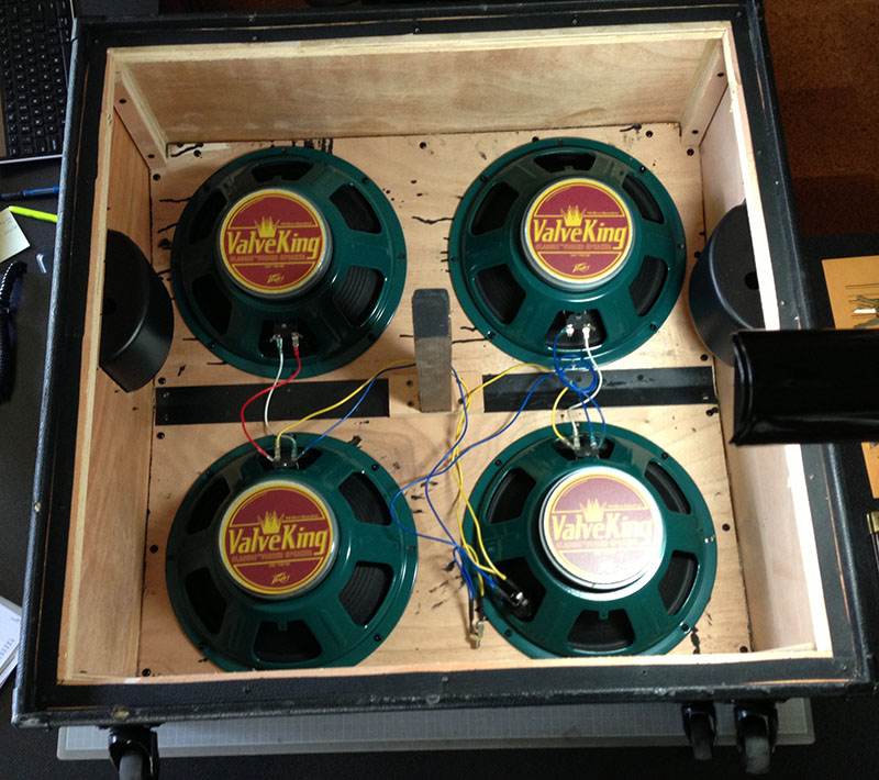

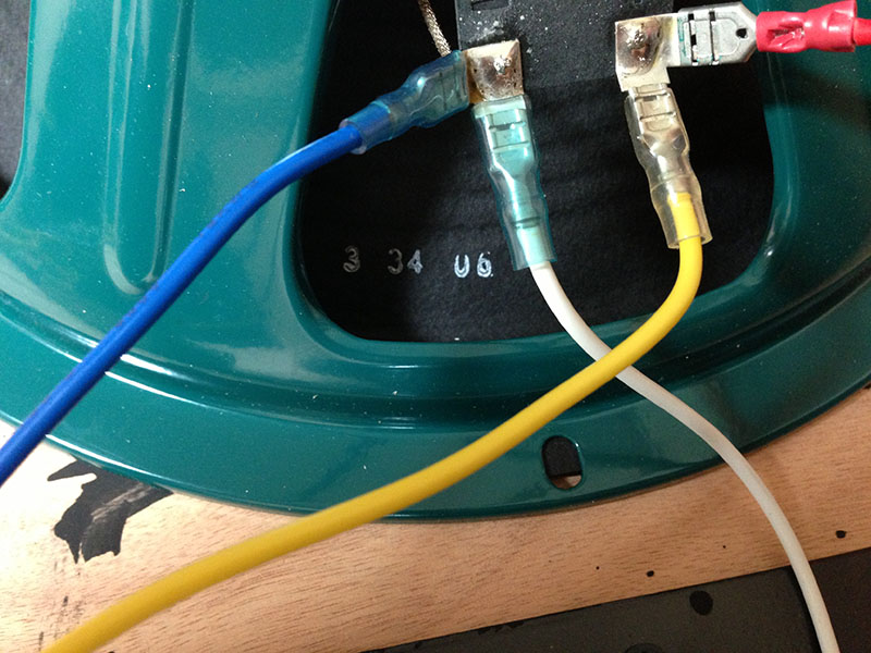

In case you were wondering (I was!) about the construction of the ValveKing 412 cab, here are my findings, after picking this up cheeeep on eBay.
All birch-ply construction, 1/2" sides, 3/4" baffle and back panel. Metal handles. Cheap, bendy casters. Four 100w VK 1216 speakers. I wired mine in parallel to make a 4 ohm mono cab.
Sounds good. Slightly crispy top end compares poorly with my #1 cab, but might actually be good in a band mix.
BTW, I dig self-healing silicone tape for bundling the wiring.

I like how the center post has a socket in the back panel to mate with.
I often wonder about the wisdom of using 1/2 ply for the enclosure.
Seems like it would resonate too much?
