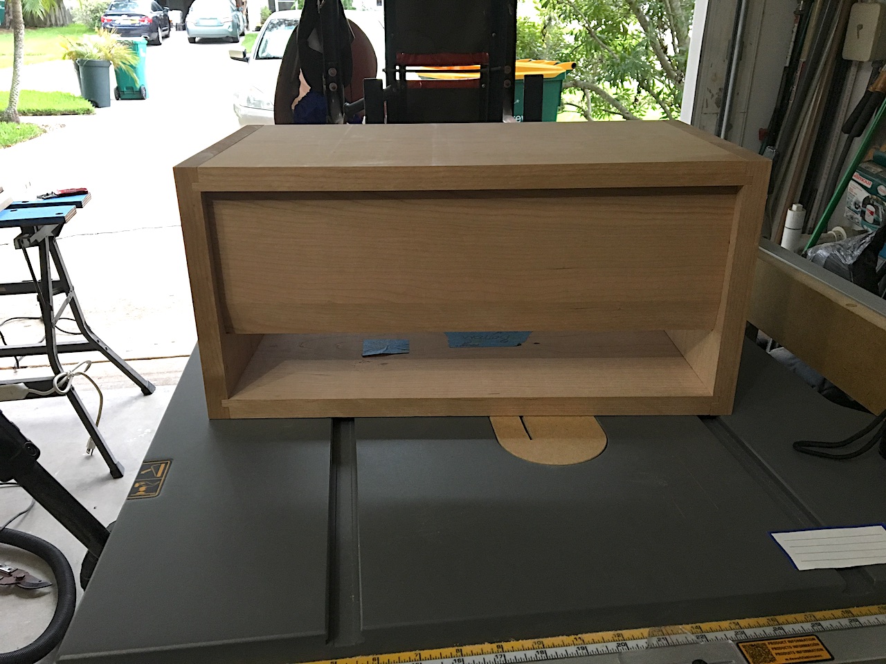

I'm getting close to completing a cabinet for my Express, and I'm considering finish options. It's cherry wood, and I'm thinking natural (i.e. no stain) but I'm wondering what the typical finish was on the originals (shellac, varnish, oil, ???)? Is there a general consensus? Here's are the pieces dry-fitted before I completed the roundovers. I hope to glue up this weekend and then cut the mitered pieces for the front. This is literally the first woodworking I've ever done, so it's been a slow process.

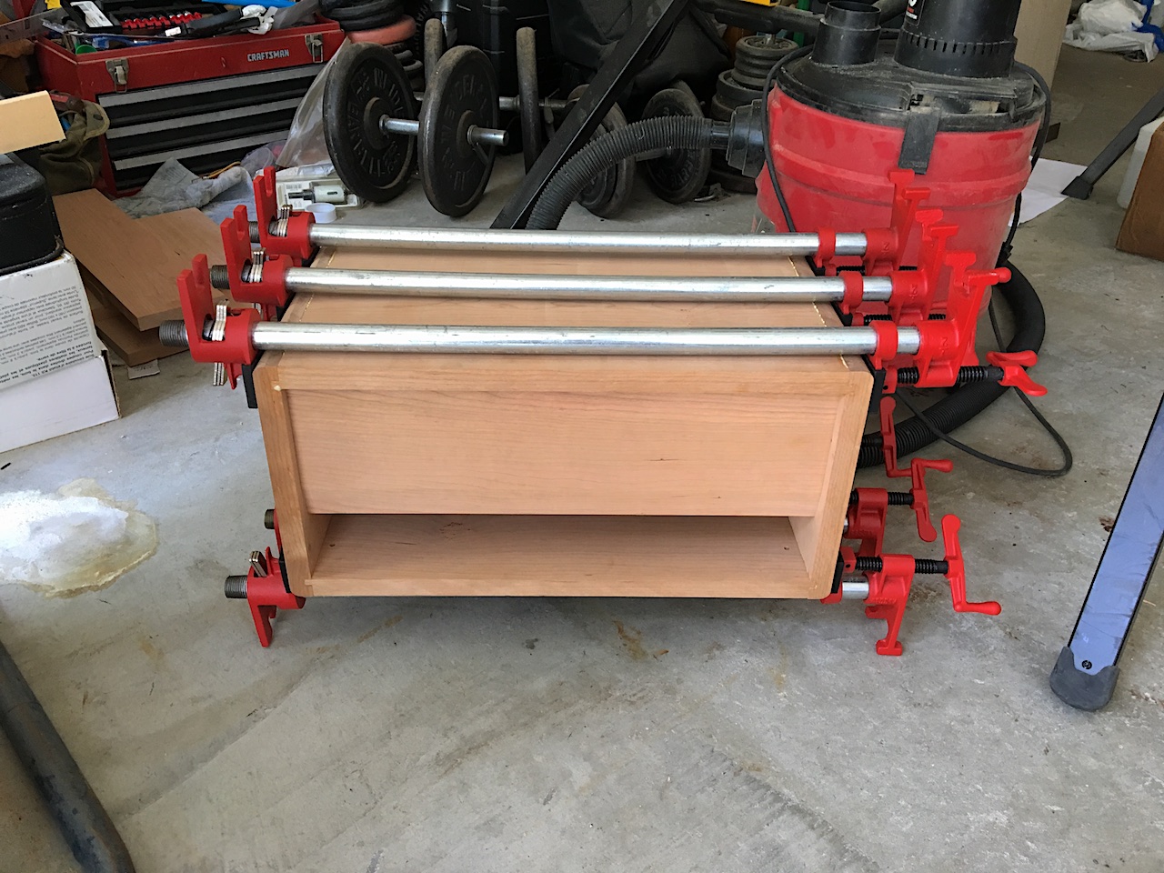

Glued up today. Not perfect by any means. Need to cut the "picture frame" for the front and then I can finish. :D

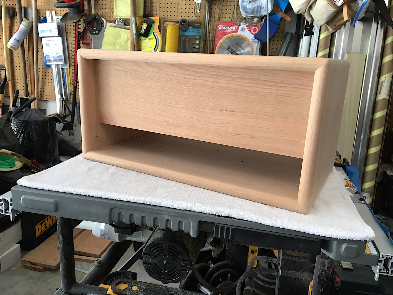

Almost ready to apply the finish! :D

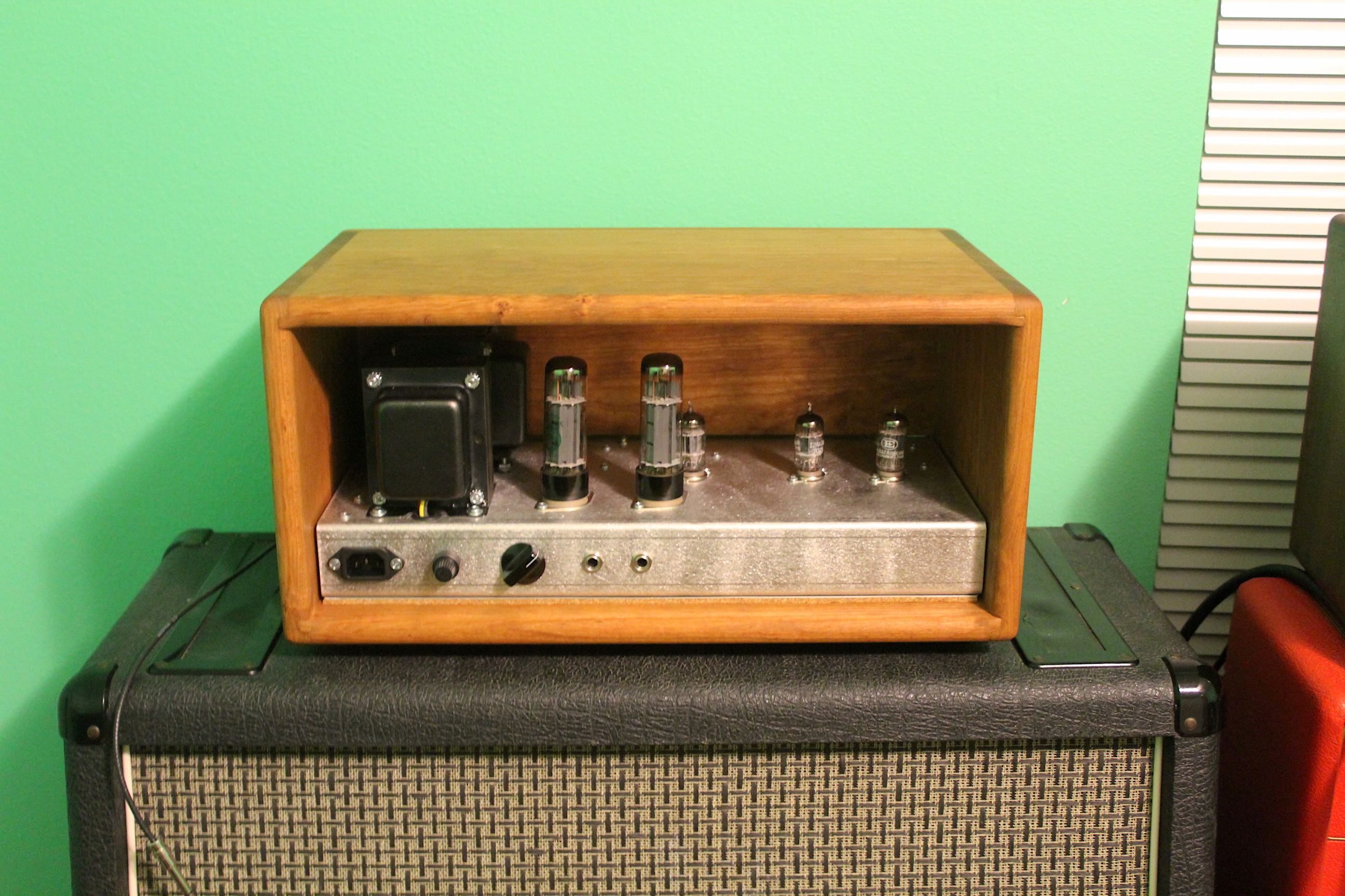

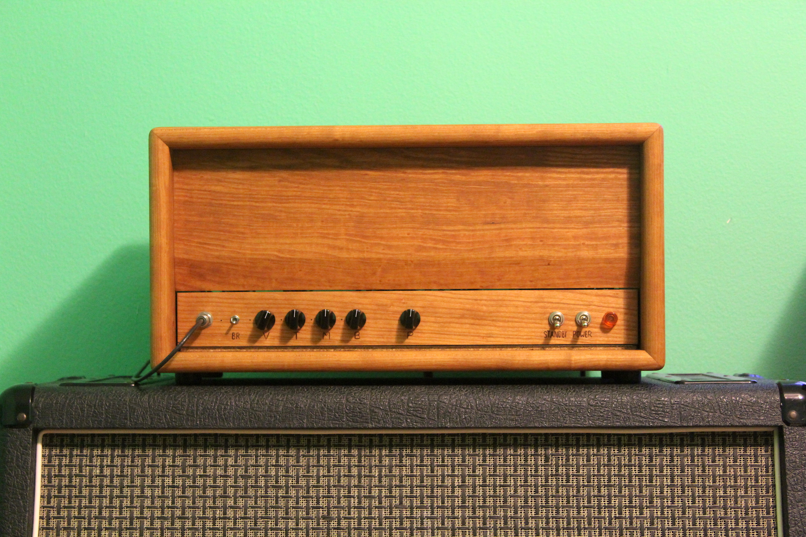

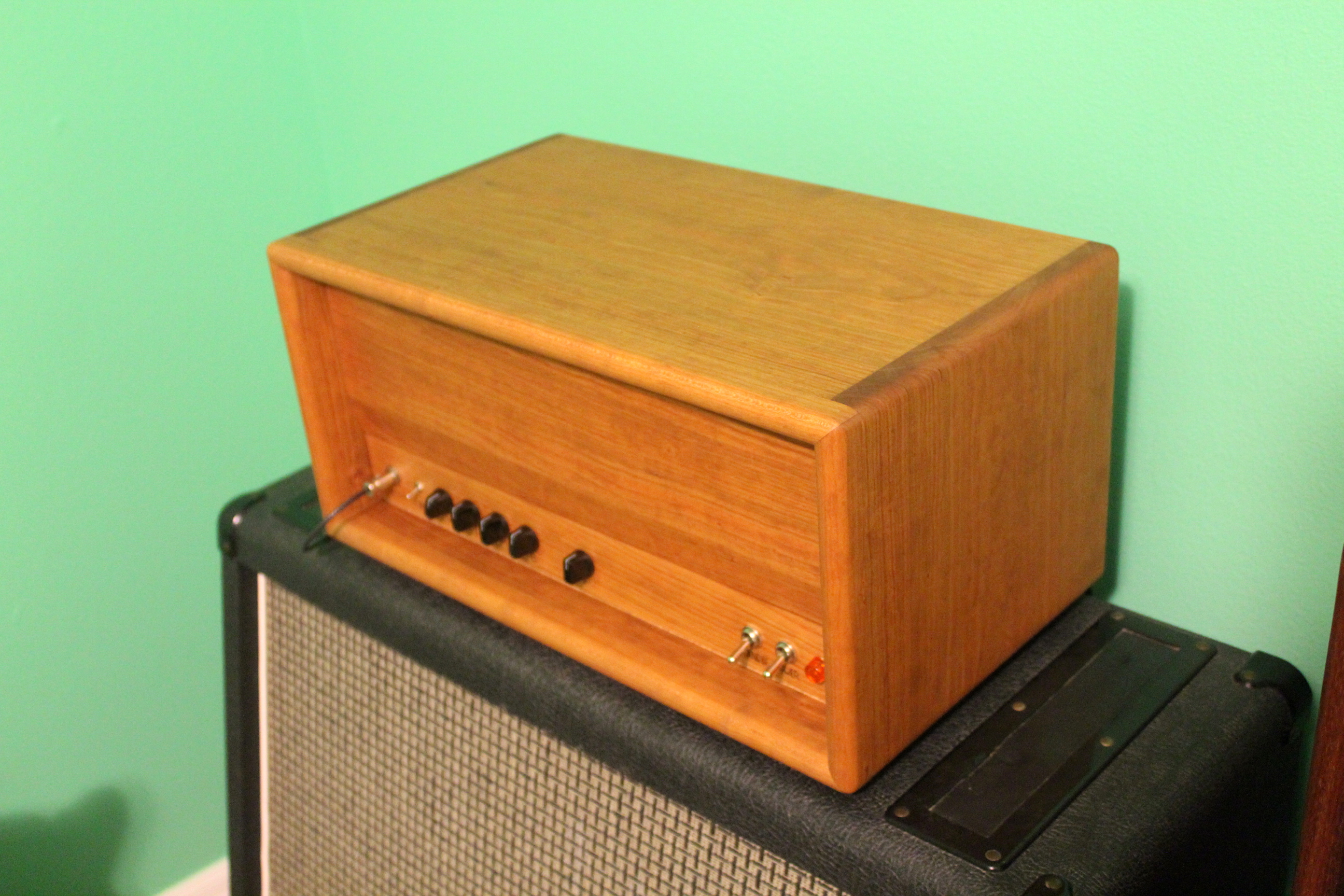

Finally finished the cab. Took about three weeks for the 100% Tung Oil to cure. Came out pretty good for a first timer, I think.
