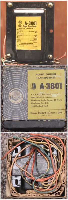

Here are the specs.
[IMG:272:800]http://i14.photobucket.com/albums/a330/ ... A-3801.jpg[/img]

How can you measure current when it's not connected to anything? The specs say 150mA per side.
