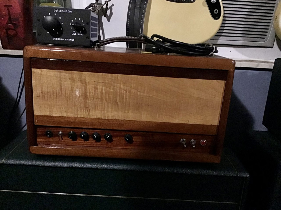

I built this ‘Wreck Express a number of years ago, two others as well that I sold or gave as gifts.
While I love how it sounds, it never worked well for me in a live band setting. I tried an attenuator with it, but it just sounded squashed to me. It is just a cheap resistive one. But unattenuated, it was either way too loud or turned down to the point where I might as well have been playing through a transistor radio.
On another forum, the purists pooh poohed the idea of a PPIMV and said it would ruin the amp. But it’s pretty useless to me for gigging right now as it is. I have a bag full A250k dual alpha’s, so it costs me nothing to try it.
I installed the pot in the ext speaker hole, so no chassis drilling. Used shielded wire coming off the PI and 2.2M safety resistors. It only took me a few minutes to install.
The amp is running through a slant 2x12 cab with 25w greenbacks. I have the volume at noon, where the amp really sings. With no master volume, I measured the volume at about 6 feet (where I’d likely be standing on stage) and it was averaging a scorching 109 DB. Uncomfortable. With the master at half, the volume dropped to a much more comfortable 99db. At about 25%, it was a little fizzy but a very moderate 94db.
I’ll need to try it live to really know how this will work out, but I’m hopeful I can dial in a usable volume this way.
