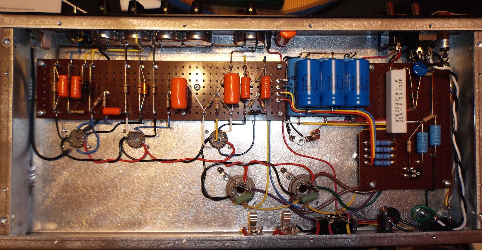

Posting in case this might help someone. Decided my first full amp build would be a TW Express Clone (learning/tweaking on an 18W “Plexi” for about 6 months prior). Purchased a kit from RJ in August. First picture below is a gut shot of the build, completed in November. Note: I had to swap OT primary wires.

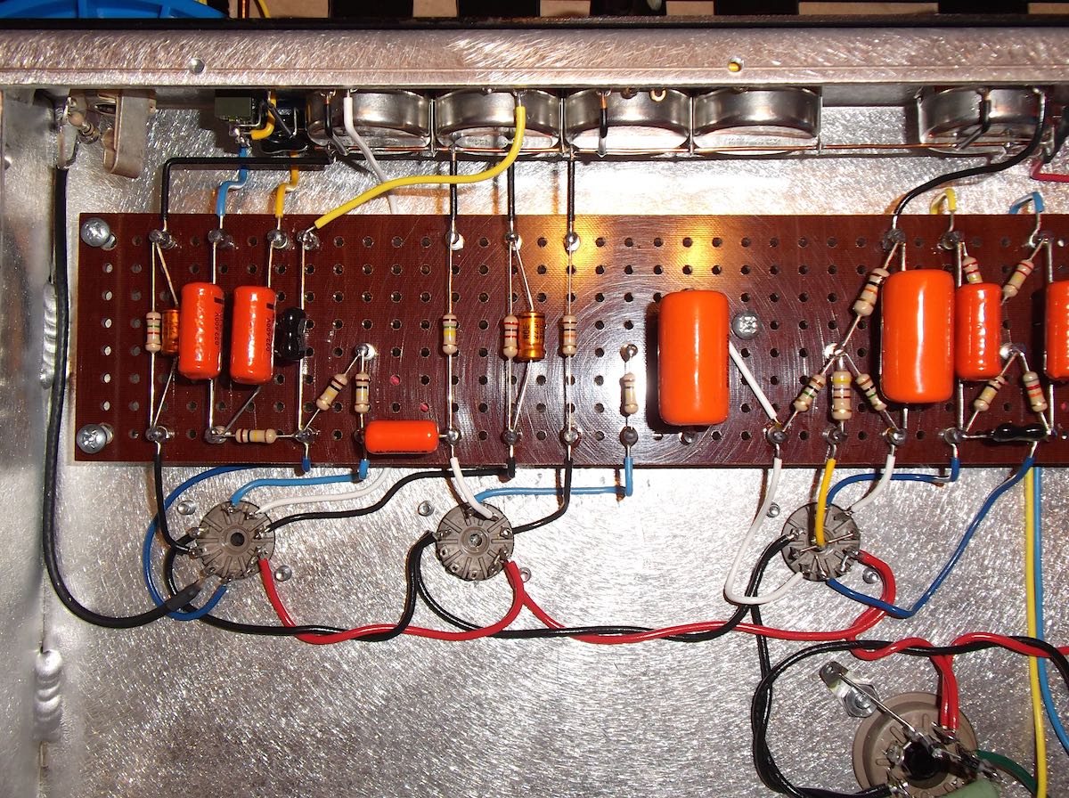

Figured the issue here was parasitic oscillation. In the picture below, I rewired a few areas to more-or-less mimic Francesca (not 100%, but …). I was surprised that this brought the amp back to life (that in itself was a learning point). Even though I consider my original wiring fairly tight, it didn’t “sound” good. I rewired in phases, and rewiring V1 had the most impact – maybe all of it. That said, there was still a substantial amount of fizz … most noticeable through a 1x12 w/Scumback M75 … a bit less through a 4x12 w/G12-65 and half a 4x12 w/G12-H30 (I like the G12-65 best – these are circa 1980). All around though, high notes sounded a bit thin and “funny”.

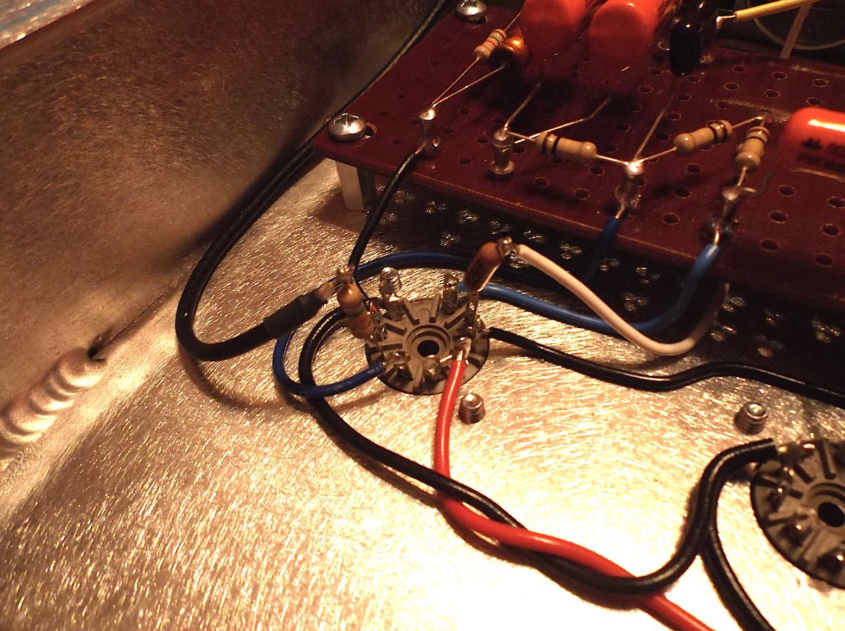

In the picture below, I added a 15K grid stopper to V1b and an 820 ohm to V1a … closest I had to “Ingrid” values, as near as I can tell. This is much better. The “funny” is all but gone from the high notes (might could be a tad richer) and the fizz is currently tolerable with the G12-65s and G12H-30s. The Scumback just seems to emphasize the fizz that’s there … odd, but maybe it provides the benchmark for “fizz-free” if I can achieve that (not sure I need to)? I plan to experiment a bit more with grid stoppers.

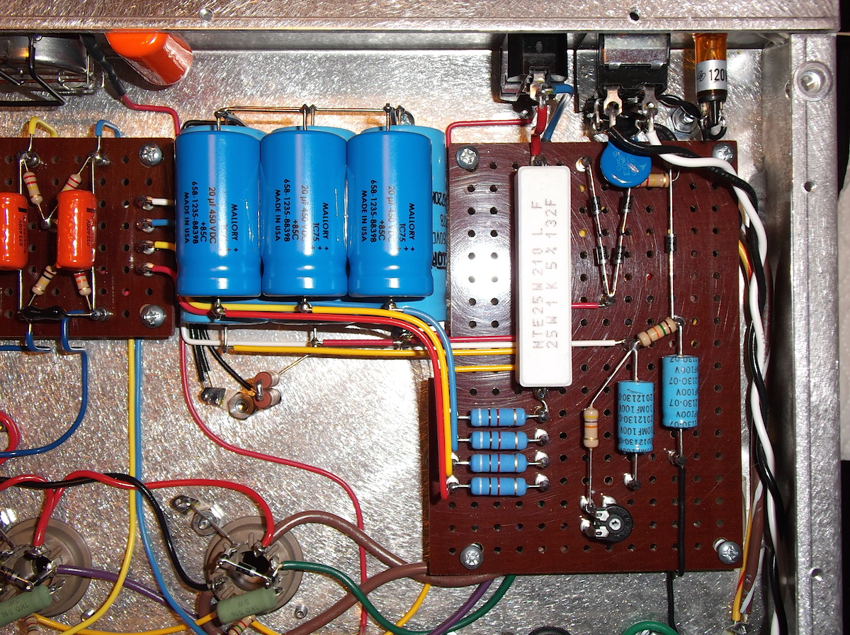

[img:1200:896]http://www.highorderpickups.com/Gear_Pa ... Supply.jpg[/img]
[img:1200:896]http://www.highorderpickups.com/Gear_Pa ... 0Wired.jpg[/img]

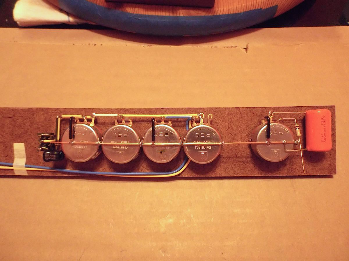

Beautiful build, excellent workmanship. Regarding parasitic oscillations in the amp. Prior to putting the 820 ohm resistor in, how did the volume control operate, were there any strange noises from it?
While many pictures show Ken Fischer didn't use shielded cable for the wiper, I've found the wiper connection to be very sensitive and in some cases more sensitive than the input.

I don't recall any strange noises from the volume pot. Originally, I had a shielded cable here. After experimenting a bit over the last few days, I'll probably go back to that. Thanks.

Check out how Dave Funk uses shielded cable in this Liverpool amp. The shielding of the cable is soldered to the plate of the triode affected and the signal wire goes to the 820 ohm resistor and not the grid connection of the valve. I've tried it and it does work, it doesn't seem to effect the tone of the amp and it is suppose to kill high frequency oscillation.
https://tubeamparchive.com/download/file.php?id=27366
BTW make sure you use heat shrink to stop people touching the shield if you do use this idea.
