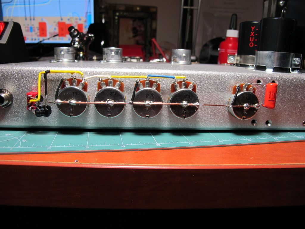

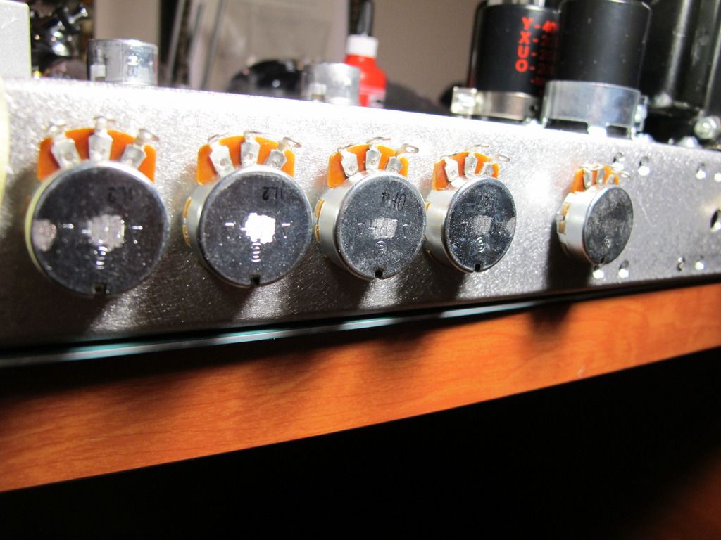

The chassis has a large lip around the edge of it, which makes wiring up the tone controls in situ tricky. I flipped the chassis over and mounted them on the outside so I could use the chassis as a jig, in order to maintain the correct spacing. I also took the Dremel to the back of the pots in order to assist with obtaining a proper solder connection:

Bright Switch:
[IMG:1024:768]http://img.photobucket.com/albums/v206/ ... G_1616.jpg[/img]
Controls with bus bar in place and all wired up:
[IMG:1024:768]http://img.photobucket.com/albums/v206/ ... G_1620.jpg[/img]

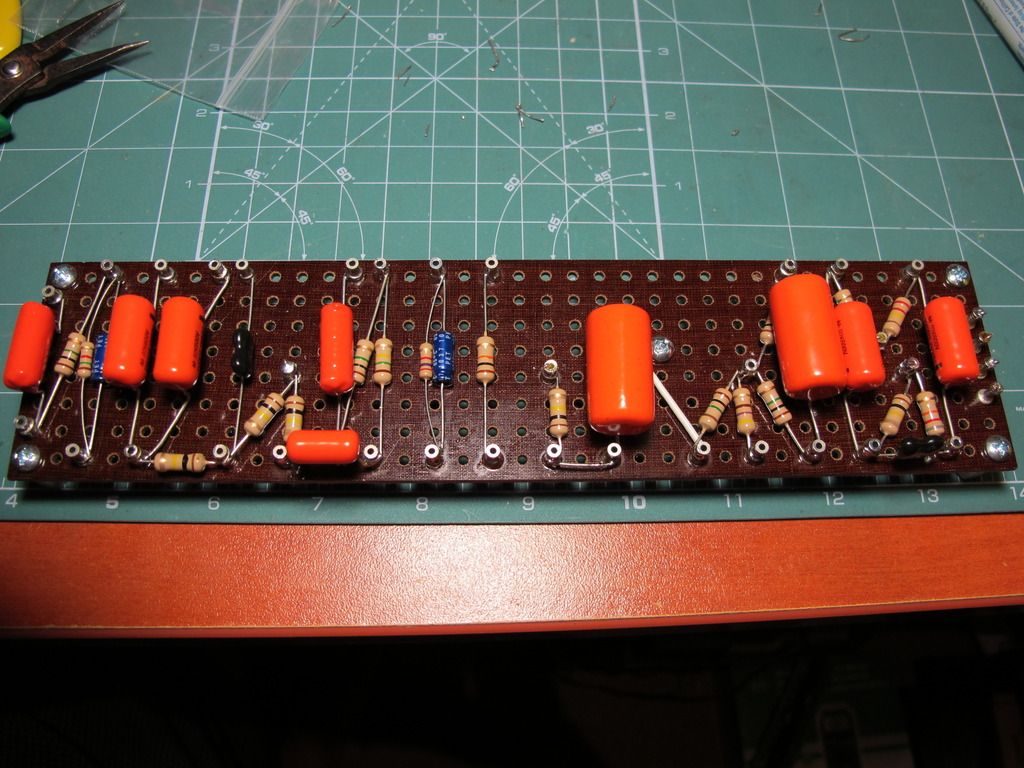

All components mounted to the board:
[IMG:1024:768]http://img.photobucket.com/albums/v206/ ... G_1627.jpg[/img]

Looking great!! You ought to end up with a very fine amp there.
Don't forget to put a little dab of silicone between the bright caps.
I overlooked that and got some serious ringing at certain settings.

Thanks Dave. You can't really see it in the pictures, but I used a dab of hot glue to to stick the bright caps together, and then also glued both caps to the side of the switch itself to anchor them. Is that ok, or does it have to be silicon?
